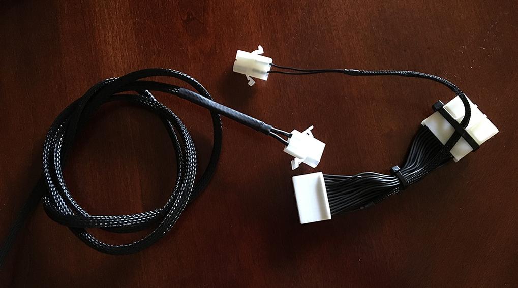

I went to RadioShock the other day and acquired some connections, fitted and soldered them to the ends of the dongle and run of wire. They came out nice.
I received my braided sleeve today in the mail (that was fast), even though I can't install it as I am waiting on AOB to come back online with some switches, I decided to test fit...well that turned into the actual install of the shrink tubing and the braided sleeve.
You can see I have the braided sleeve close to the connector and the shrink tubing over the sleeve.
Used the 1/4" braided sleeve.

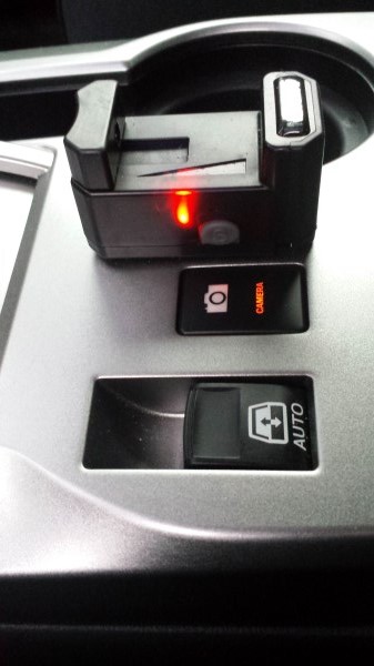

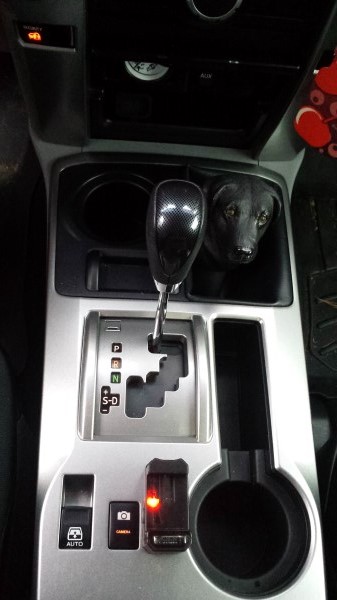

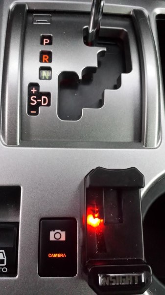

Switch is located in left knockout in center console where seat heater switches would be. I'm running out of factory spots :naughty:

Here's what I've got so far Saker :cheers:

Installed the dongle today. Piece of cake! Only advice I offer to people is firmly press the connectors together for both ends of the dongle and you will feel the connections seat very tightly. I installed quick connects in case I ever want to quickly remove. I placed the camera AOB switch in the blank space by the key/starter cylinder, as that is the highest/closest switch panel to the radio. I'll post pictures tomorrow.
A few pics- I also have the CRUX interface adapter, which is why there are so many harnesses.
