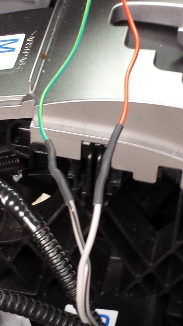

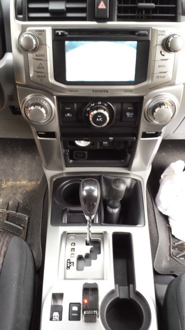

Dongle installed

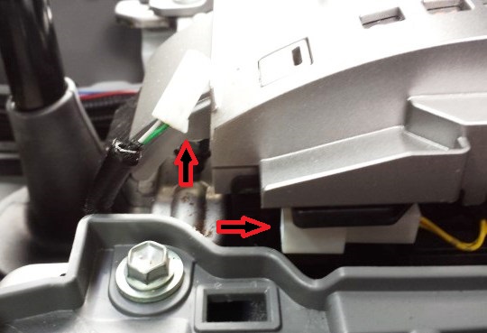

Unplug shifter illumination harness (driver side).

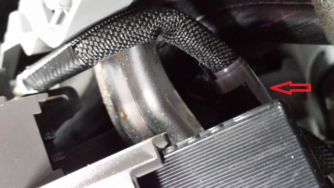

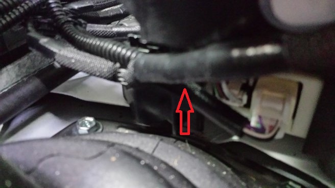

There are two plastic tabs that hold harness to shifter housing, one white, one black. Release both, this will allow harness to be pulled back giving you room to splice into green (+) and gray (-) wires.
Then protect with loom and route wires to AOB switch. Connection to green and gray wires were made just beyond black tab as indicated by red arrow.
Connect dongle wires to AOB on/off switch, protect with loom. Test for proper operation prior to reassembly
Back together and working slick as sh!t
