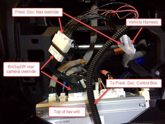

I'm happy to report that the BriGuyDIY rear camera override works with the Prestigious Society Navigation Override. They connected in serial. To turn off/on the nav nanny, I press - - + + on the steering wheel volume. Then of course I use the AOB rear camera switch to activate the rear camera override. Both can be used at the same time. Perfecto!
Here is a picture of the situation, looking down at the nav unit:
In the photo, you can see I have not yet connected the Prestigious Society ground wire.
