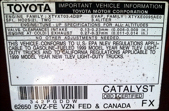

Are you SURE you are a Cali. emissions truck? I'd love to see a pic of your sticker.
For the record, I have always told people to either count cats or look for the A/F, TWC(2), HO2 (Cali.) or HO2(2), TWC (Federal) on the emissions sticker right under engine family to determine what sensor to order. Those labels are very confusing and you may not, in fact, be a Cali. emissions 4Runner if you only have one cat.

You got it. TWC = Three-Way Converter, HO2S = Heated Oxygen Sensor
I have a collection of pics of emissions stickers. That's why I wanted to see yours, because I have nothing like that ('99 Cali with one-cat). Yes, that phrase usually appears in all of them. You want to look at the line across the bottom--does it say CAL & OTC or FED & CANADA, plus the Cali's have the verbiage about only for sale in California or other NLEV state or contiguous.
Here is a "99 Cali:
Here is a '99 FED:

How did you decide what the VIN says? The VIN does not have a field for that. Parts listings will show both one and two. Only the build sheet will specify for sure, or your emissions sticker. Did a dealer tell you that? Some Cali dude? Please post a pic of your emissions sticker. California will go by the engine family on the sticker and the equipment listed..
