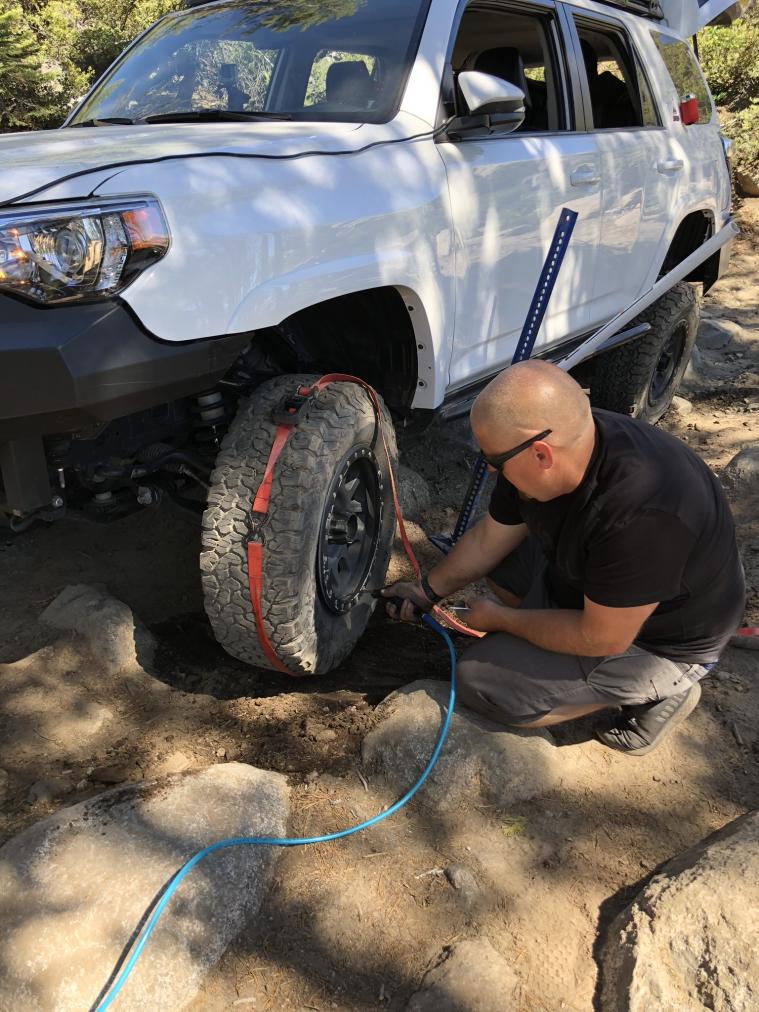

Also one other tip. To reseat a bead without a big compressor, wrap a tie down strap around the tread pin the tire and as you tighten it down it'll push the beads out to the wheel so you can refill and reseat them. But take it off as soon as it starts to fill up. Otherwise it will break the strap.
