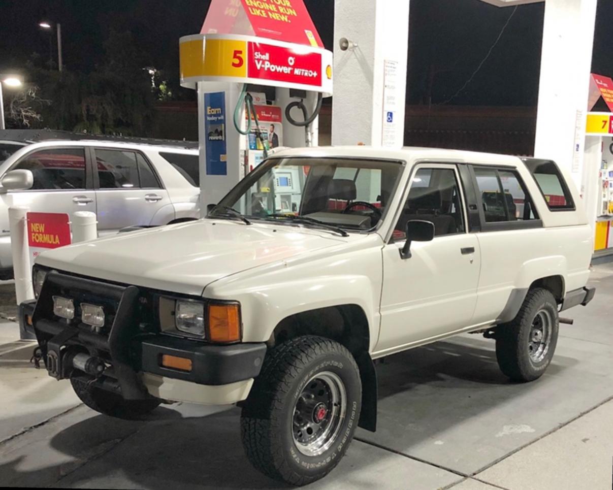

Just picked up a sweet 1985 4runner with 125k on the odometer.
Just before I leave the PO says oh hold on I got something for you and brings out a SR5 gauge cluster and hands it to me.
I’d like to instal the cluster but it has almost 200k on it.
I did a quick search through google but didn’t notice any threads. I’ll try some other arrangement of words but I’m curious if anyone has done this or remembers seeing a how to thread.
