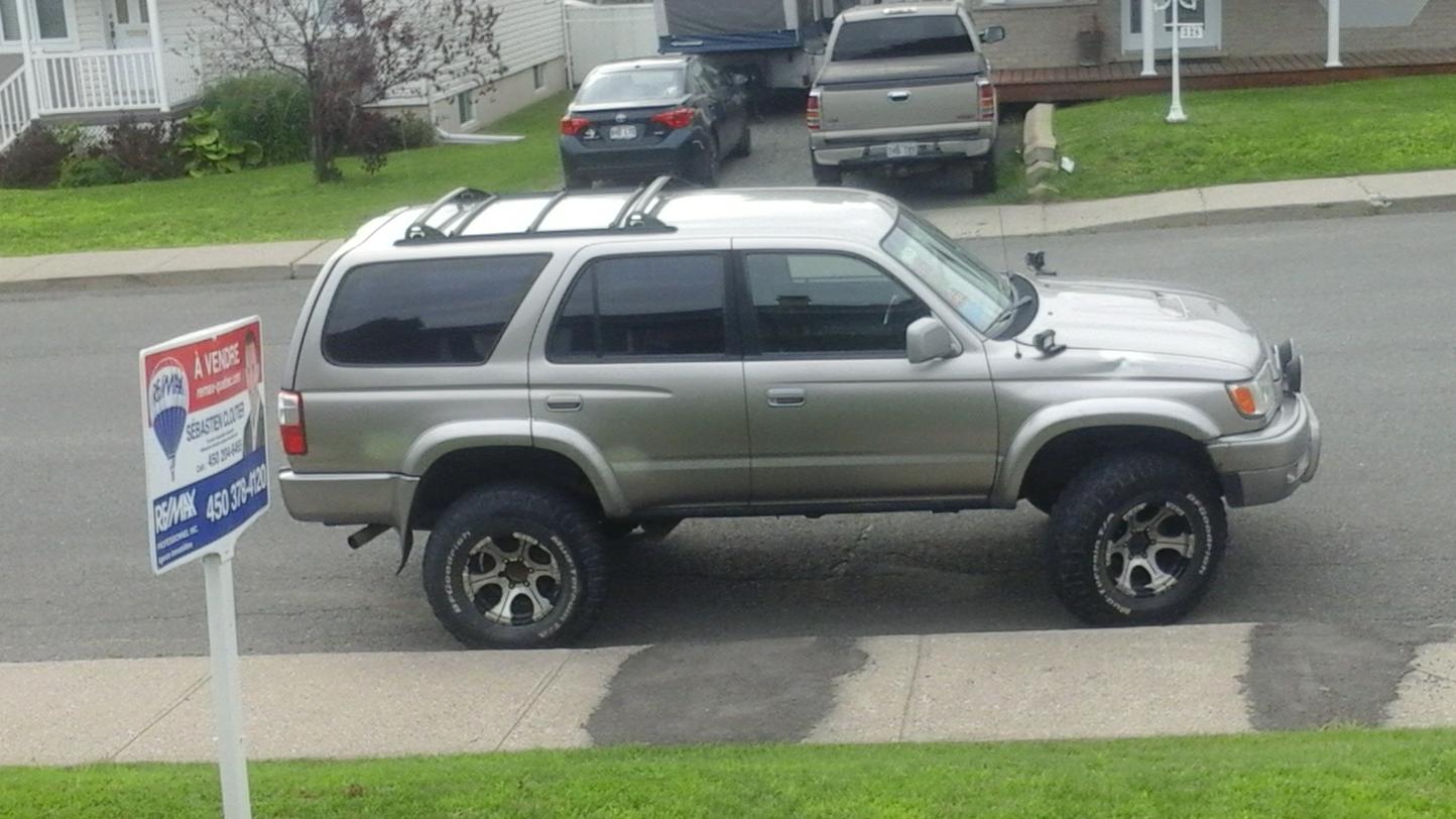

2.5 icon front 650lb spring. LC 7.5 wrap w/tundra Fox's shocks
Figured just wasnt sure lol. No issues...I did the tundra 199m brake mod and still no issues.
Offset is -12
Backspacing is 4
Sent from my LG-LS993 using Tapatalk
awesome thanks. Been trying to find some wheels that style that fit but everthing I read on here says the steel procomps hit the calipers without a spacer, and I dont want to run spacers.

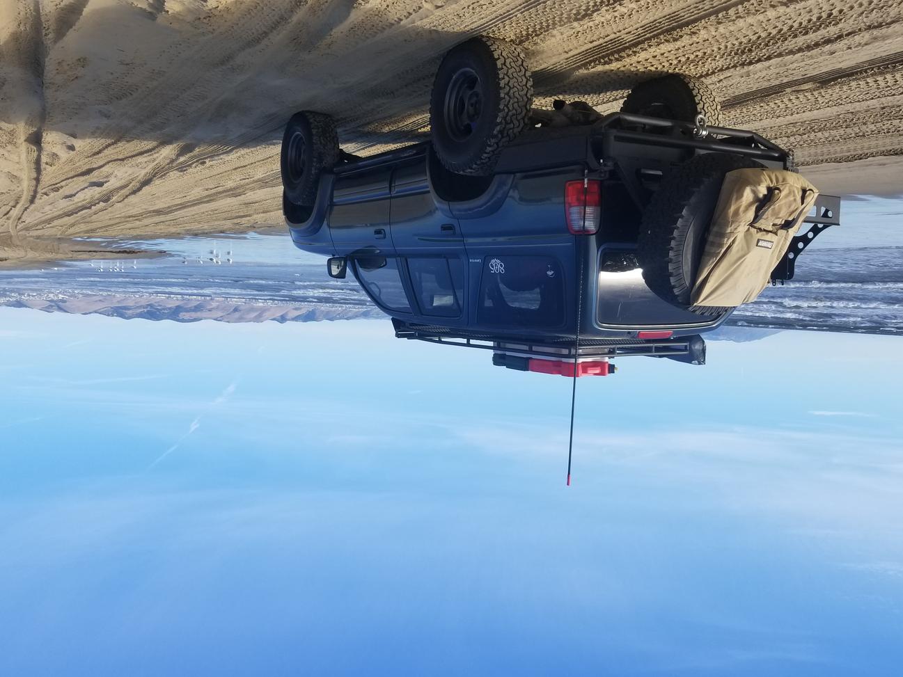

LC Coils with weight
When going the rear LC coil route on the 3rd Gen it appears the most common are 8 wrap and that it yields a bit of a rake paired to a 3" front lift. My question is; How well do the LC coils stand up when weight is added in the back (cargo area, aftermarket bumper, tire carrier, etc.) compared to for example the OME 891.
Think of it this way. Lc coils are from the front of an LC. The motor is a good amount of weight. They can handle a good amount of weight. I have yet to load my rear enough to sag past the front. But i run a light rig with stick bumper. Im running 881 coils and lift sleeves for about 2.5" lift with my bumper and winch. I love my new 7 wraps.
