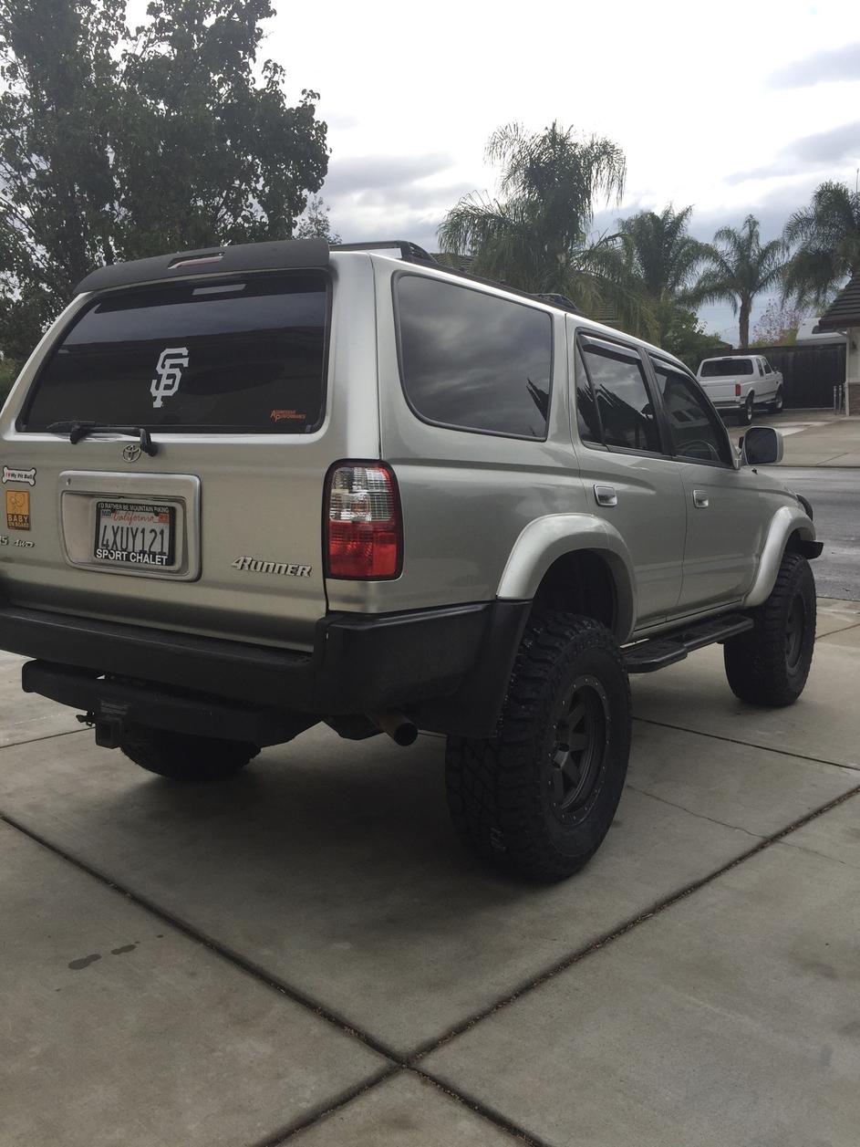

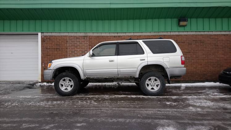

Toytech coilovers paired with 8 wraps and black tokicos with 295/70/17 cooper stmaxx’s.
Which rear swingout bumper do you have? Did the 8wraps sag too much?
I have 8 wraps & will be getting either the Shrockworks or 4xinnov next spring.
I dont care if they sag to level as long as it still rides good.
I have a 4xInnovations rear bumper with swingout. With the rear coils SS 1.2 came with (I can't remember if they were 7 or 8 coils) it sagged slightly. Keep in mind I have the bumper plus a full size spare, hilift jack, gas can, and trunk full of stuff. Even with all that stuff the 861's gives me a small rake, just the way I like it.

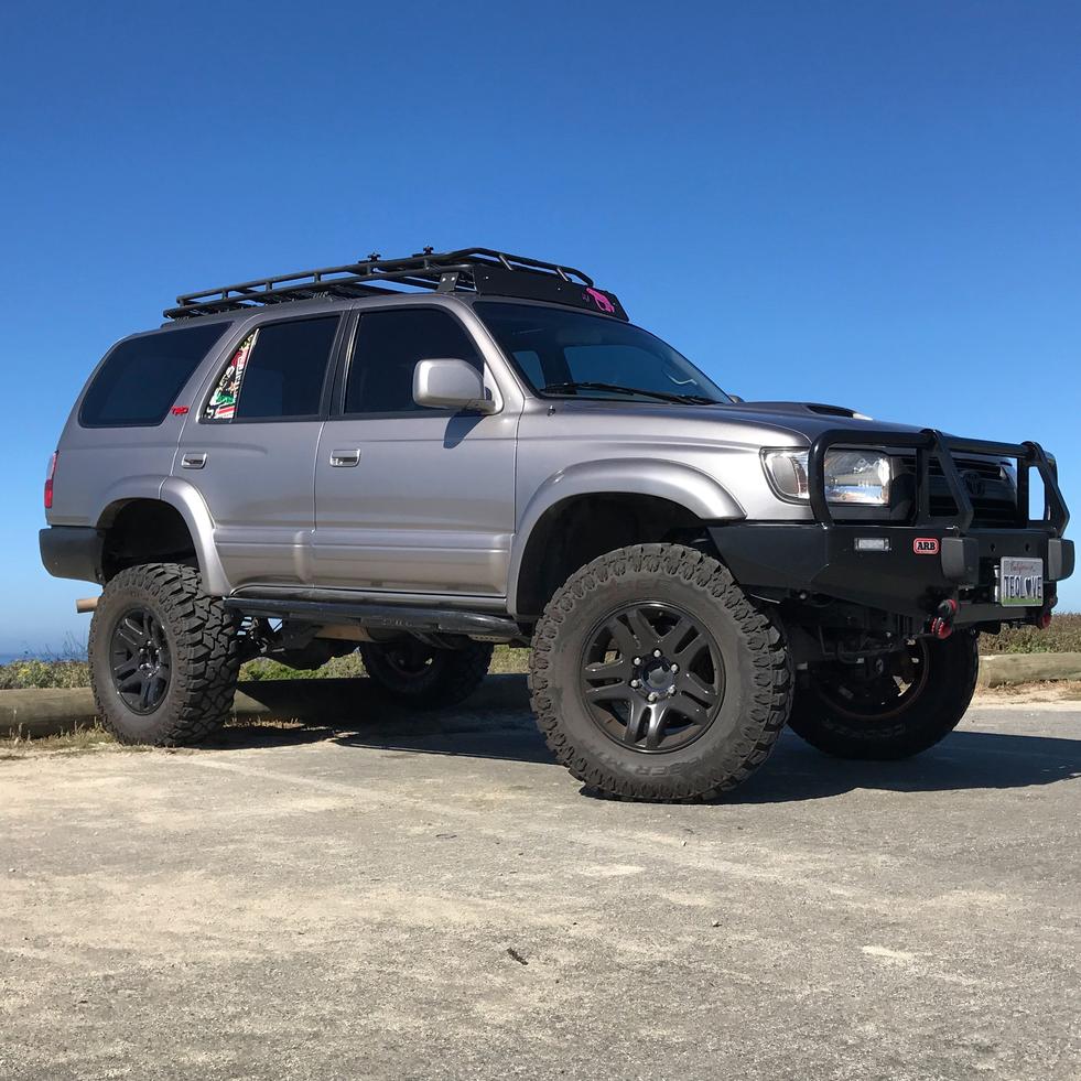

ss 1.2, front on 3rd perch with relentless fad. bumper and winch

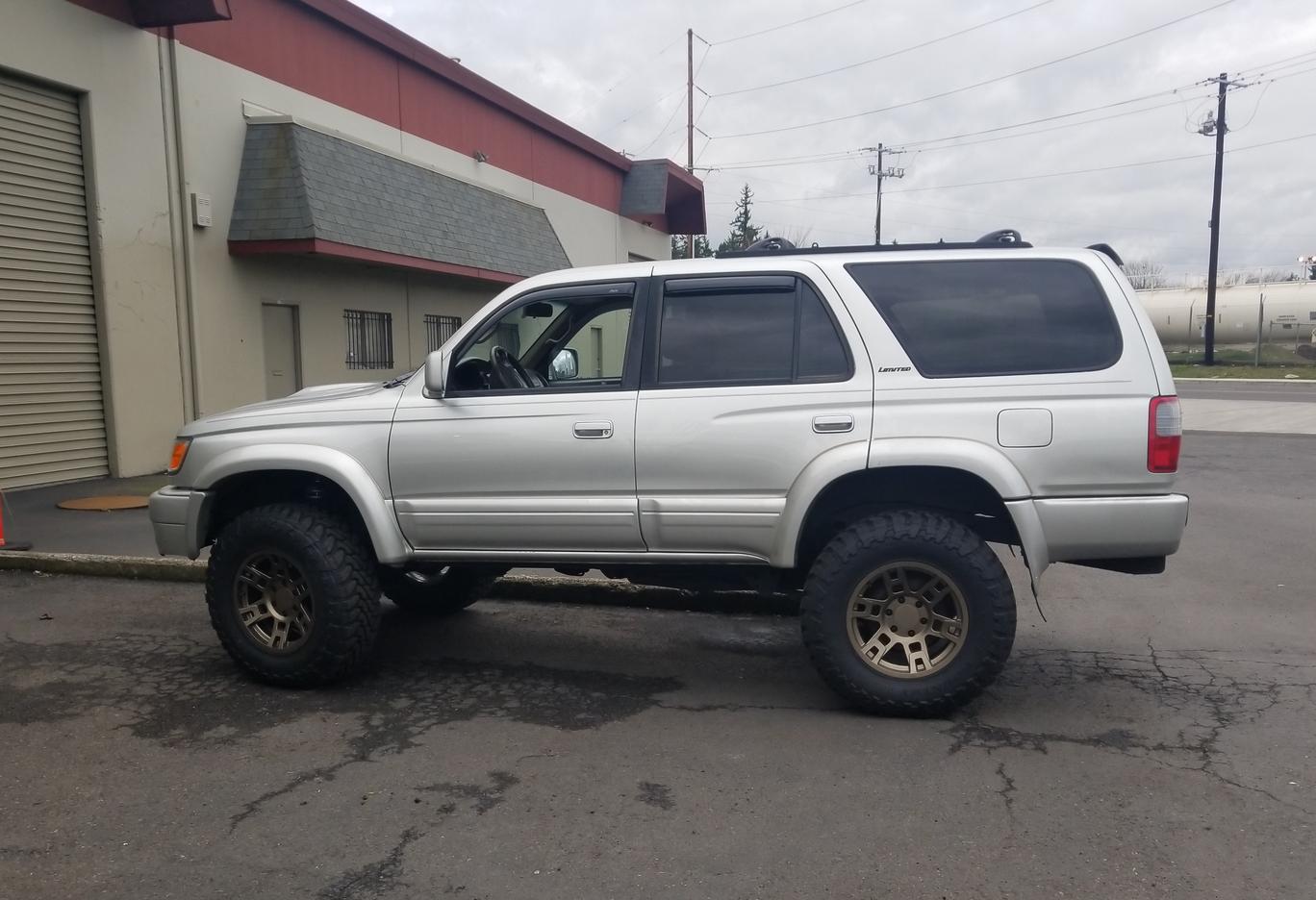

Toytec 3" springs with tundra 5100's in front
LC 8wraps in the rear with 5125's

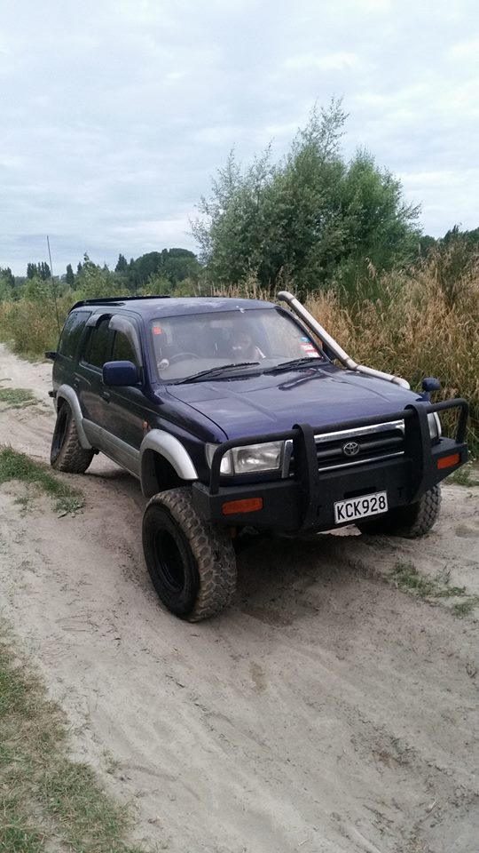

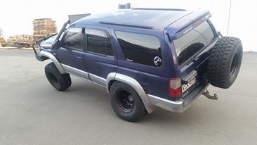

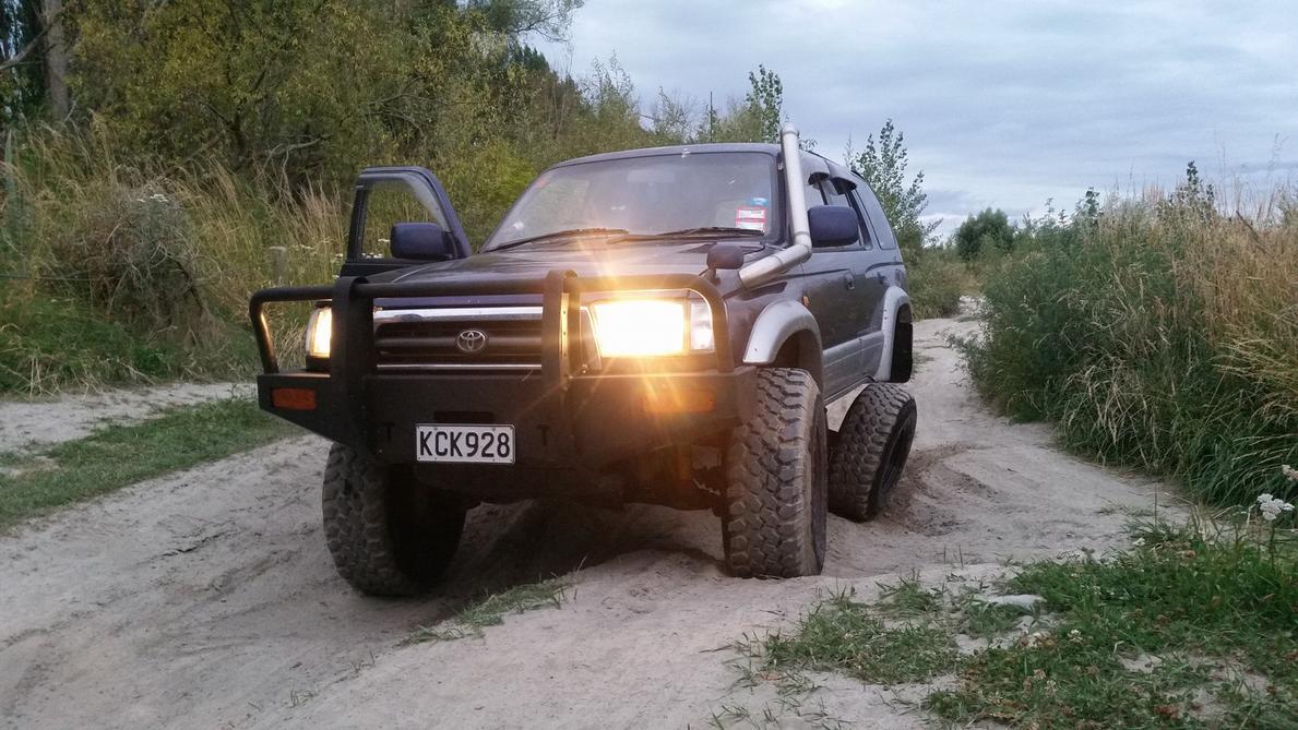

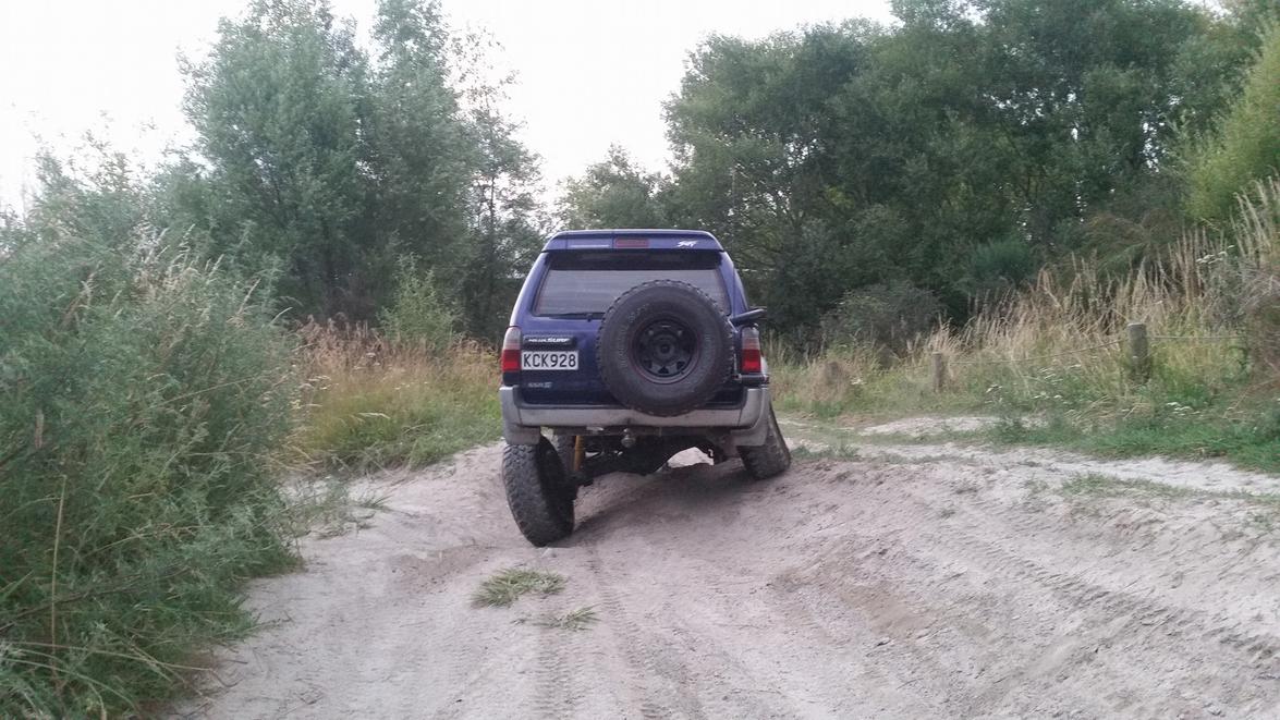

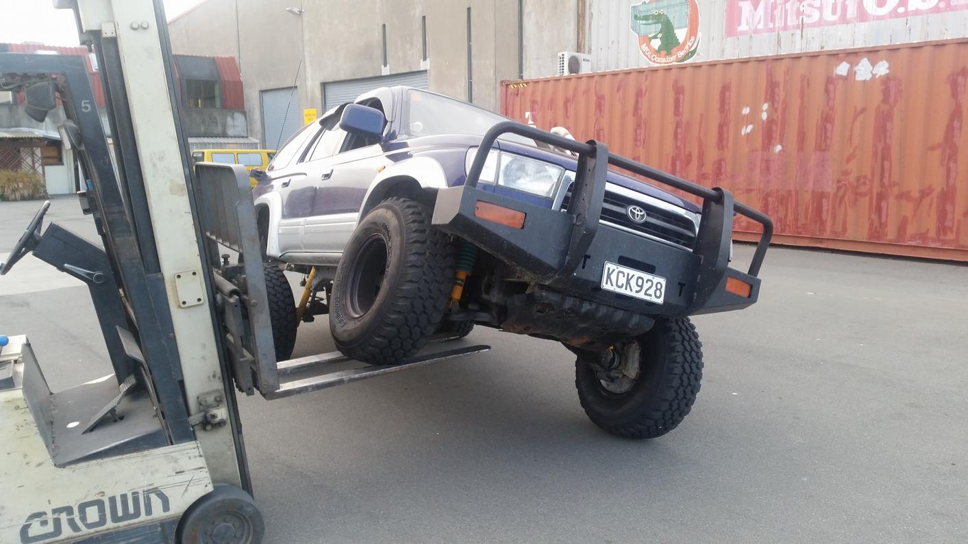

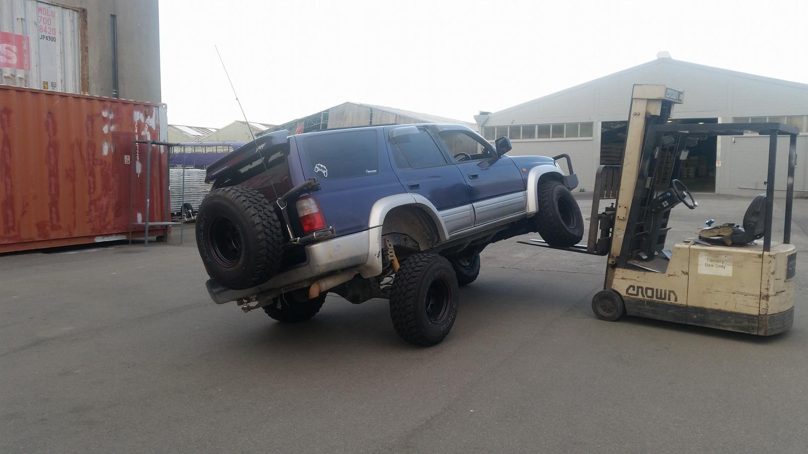

My 1995 toyota Hilux Surf
so i use to have a 3rd gen and it was after reading this thread that i decided to do the land cruiser coil swap.... that and the fact i drowned it and while it was off the road i knew something had to be done about the lack of suspension height. i used lc 7 wraps and factory rear lc shocks and in the front i had 2 inch spring and shock combo along with 2 inch top strut spacers.... yes it was an absolute B***H to get in there and i would not recommend it as it was a bit of a stiff ride in the front for a few weeks till it settled a bit. also its siting on 33inch muds it was a beast!

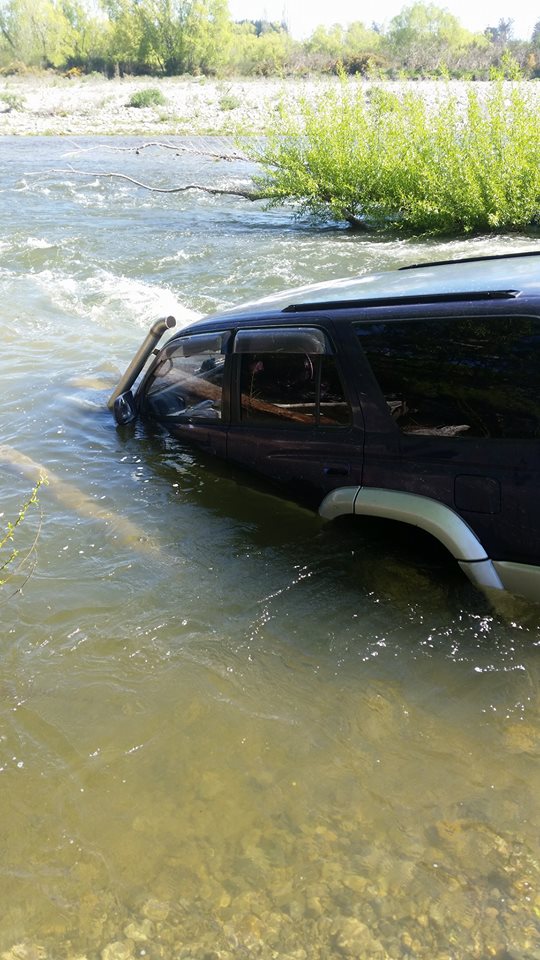

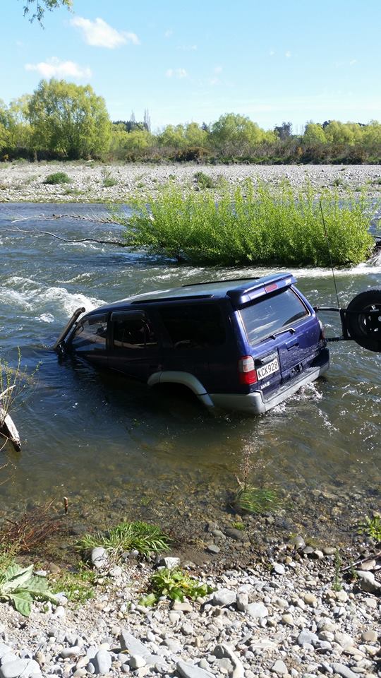

Dude....
Nice 4runner. Did you know it was that deep before you became a U-boat commander? Holy cow! So what happened? Did that kill it?
well..... yupp...

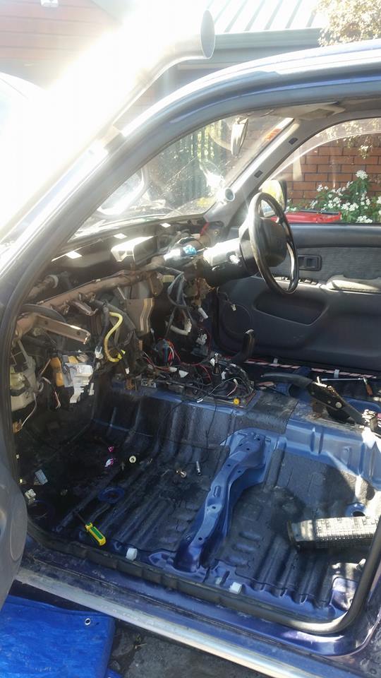

HAHA! lets just say it was not a good day at all... decided id take the girlfriend out on a picnic and C****D it up completely... that hole is where the river! ended up putting me! it was way to swift to cross on standard height and all terrain tires..... lucky once the river stopped dragging me along i rammed it in reverse and hit the gas! and as soon as she stopped moving i knew she was done... left it in park ripped the handbrake up and had to climb out the back door! after 10 mins of the mrs trying to figure out how to open the spare wheel carrier and then the boot hatch :ybrick: .... once i got it towed out of her predicament i got it home and drained ALL of the fluids! both diffs the auto trans the transfer case, engine and radiator pulled all of the interior out
and even with nothing left inside, bar the wiring it took two weeks to dry out! but i got extremely lucky.. once i knew she wasnt going no where with out a tow! i shut her down... unfortunately it was under water for the best part of 2 hours... but to this day she still lives on! 1kzte engines are amazing! but it did take 4 engine oil changes and engine flushes to get rid of all the milky oil lol!!!
i have a few vids on my facebook profile of draining oil and getting her running again haha

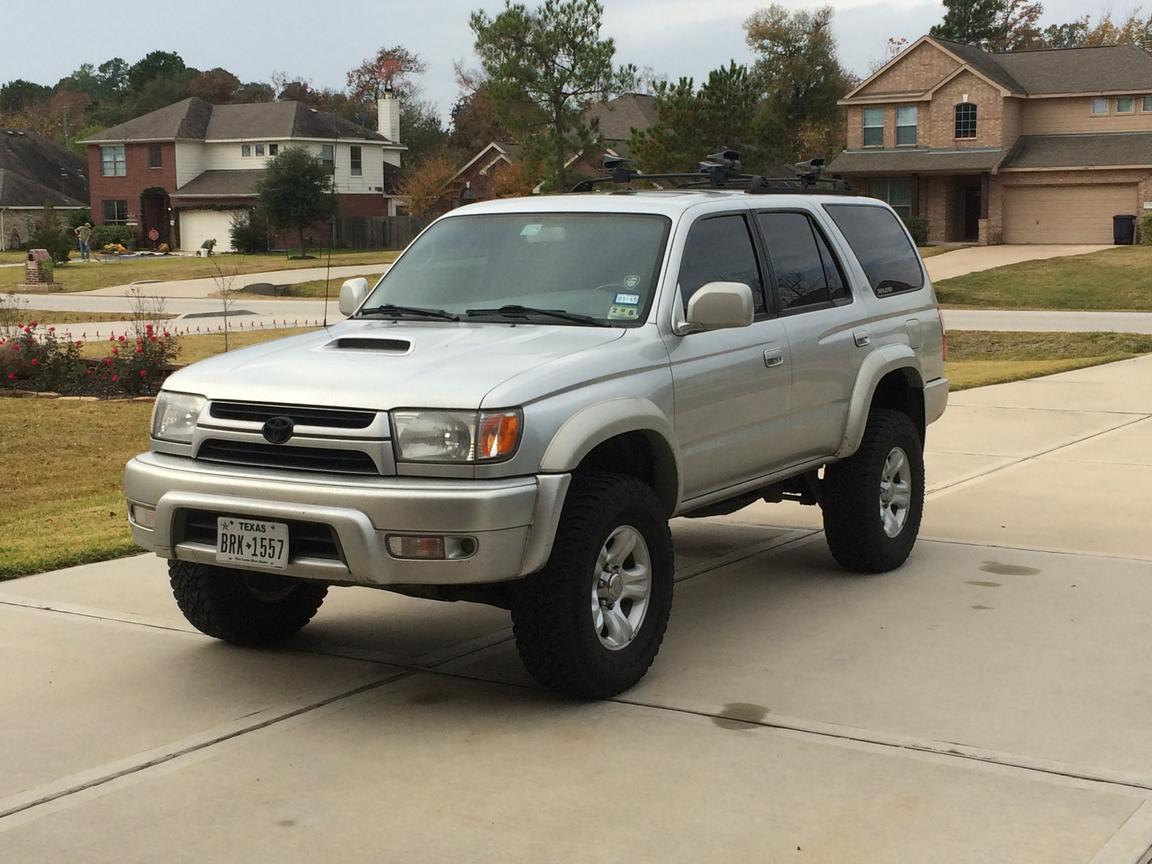

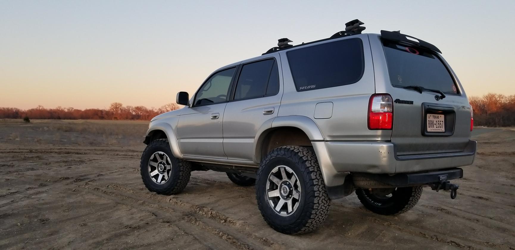

LC 9 wraps with Pro Comp extended travel shocks. 3" lift w/ OME 881 & spacer.
Lift w/ 285 70 17
Lift w/ 265 75 16
