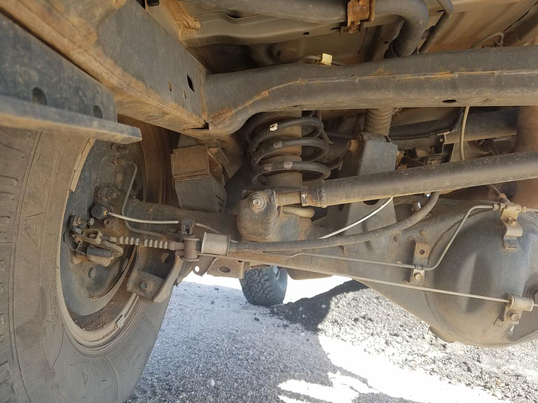

BTW I have 8 wraps and I got about 4.24" of lift with no rear bumper. I love the way they ride.
Sonoran Steel 1.2 with LC coils in the rear.

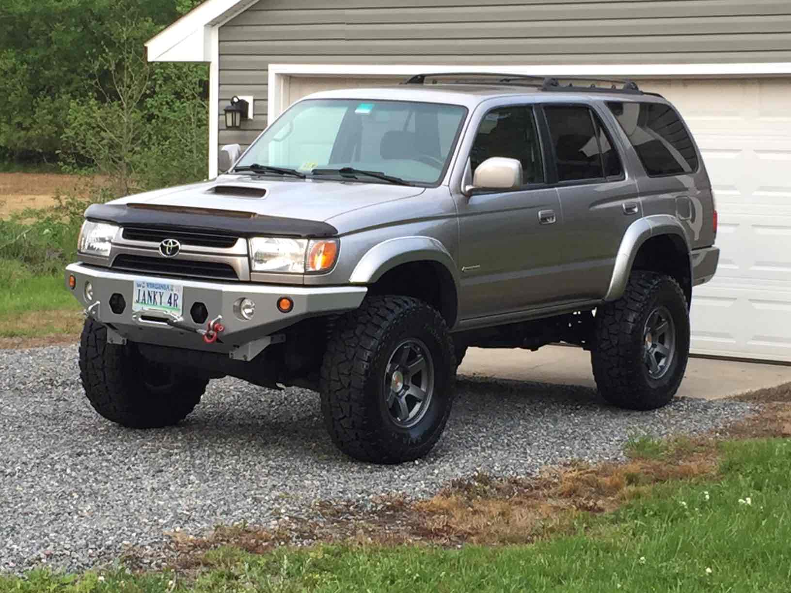

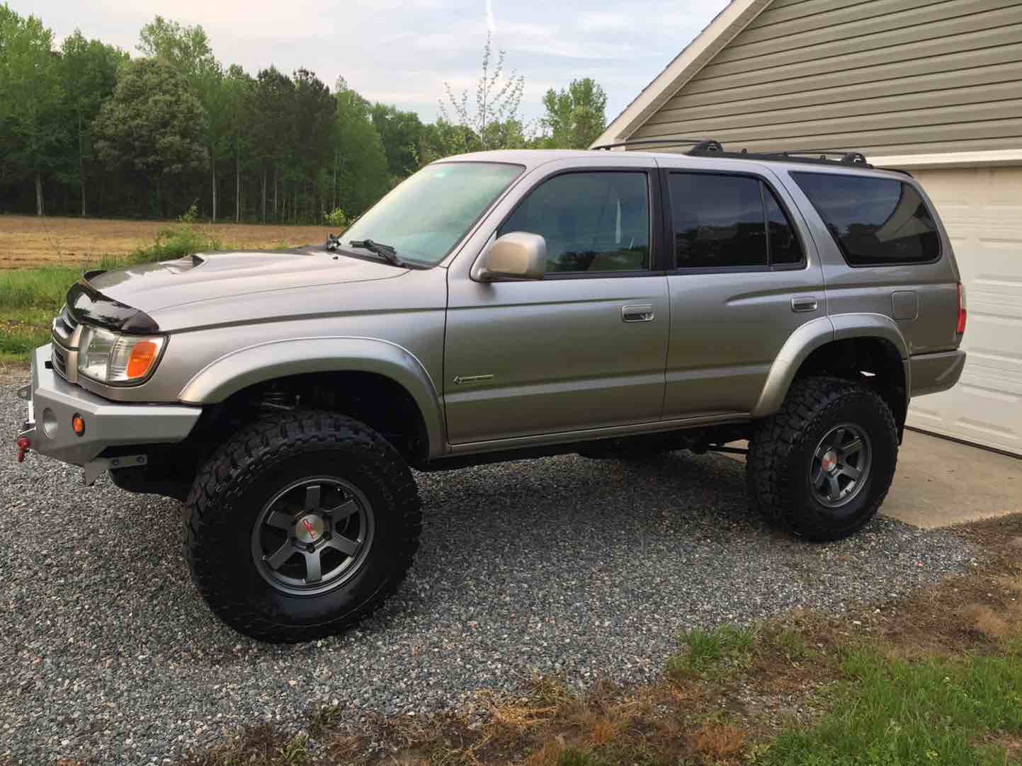

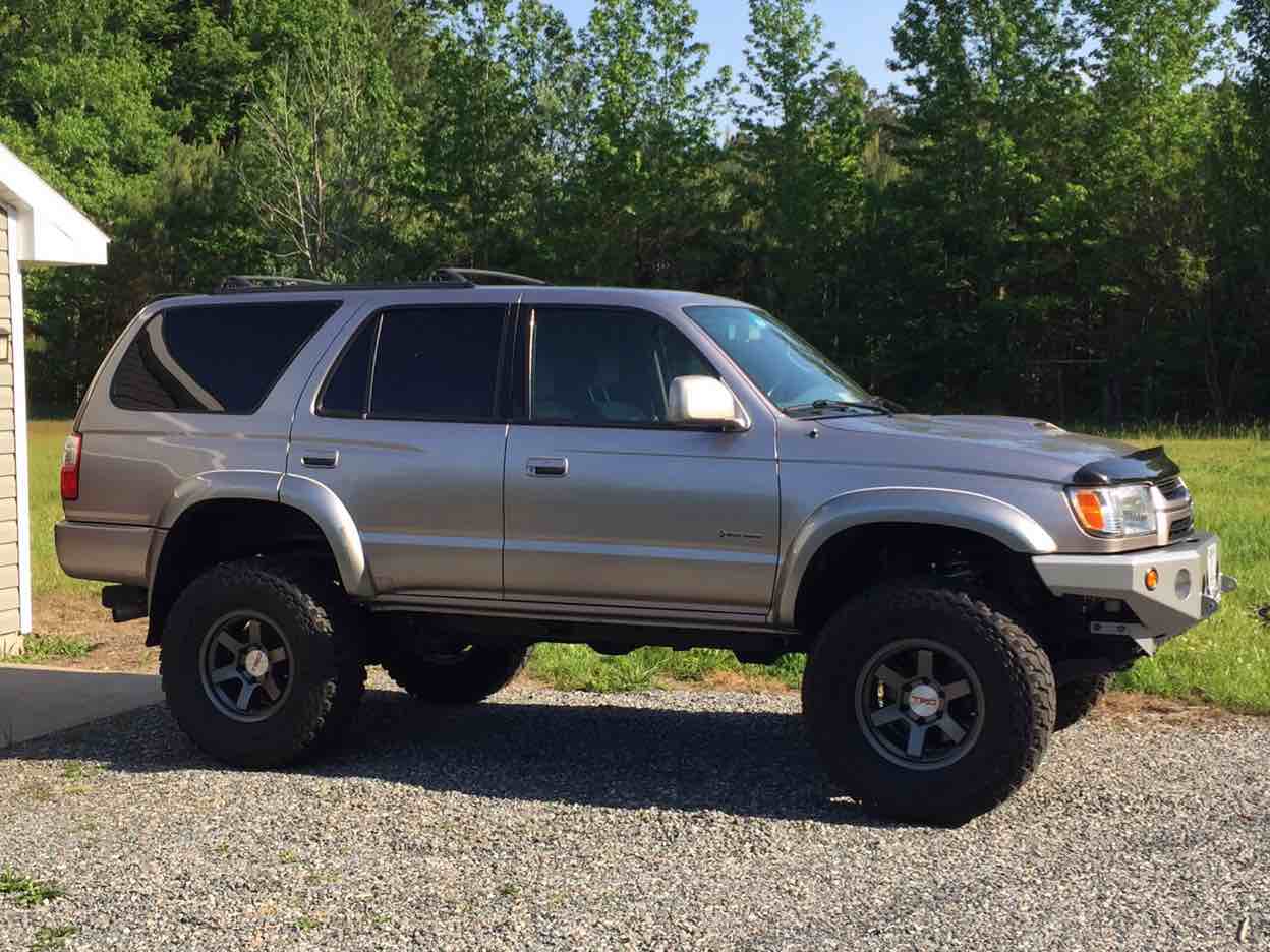

Lift installed with 4xInnovations bumpers front & rear :bounce:
Bumpers after by Adam Roberts, on Flickr

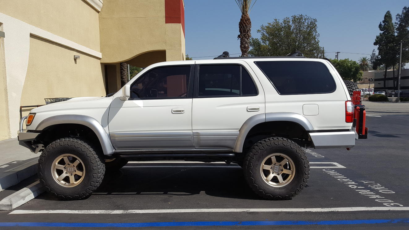

Toytec/Eibach 3" up front on Tacoma 5100's with 8 wraps in the back on extended travel 5100's for 3rd gens. Front rides a little rougher than i would like so i think so kings are in my future.

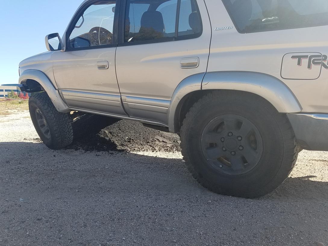

What you do when you see that asphalt pile. Sittin bump stop doe.
