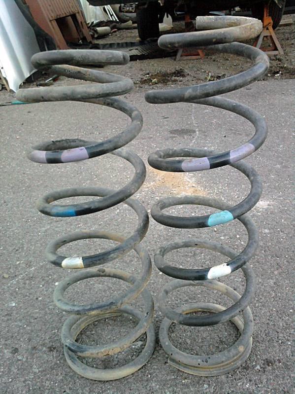

Somwhere on here was a reference to a Craigslist add in Pheonix for LC Coils. I contacted the seller and he wants 35 for the fronts plus shipping. I got him to send me a pic. According to the LC Coil color code they are 7.5 Wrap coils. One is taller than the other. Is this right? Are they incorrect should the driver be different than the passenger color codes? Or are these good just put the taller spring on the drivers side? Thanks

PS do these look worn or unusable?
Those look exactly like the ones I just got done putting into my truck. Yes, one will be longer than the other as usually the longer one will compensate for the gas tank/driver extra weight on one side of the truck. Those coils are the:
White, Light Blue, Dbl Pink - 7.5wraps (19") - Passenger side
White, Dark Blue, Dbl Purple - 8wraps (19 1/4") - Driver side
