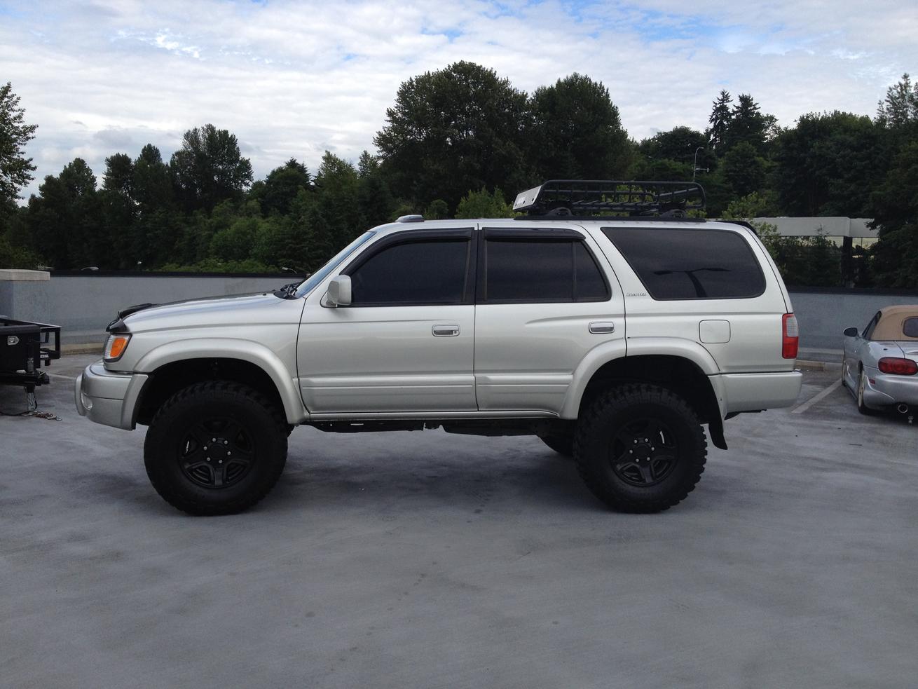

8 wraps w/ Bilstein 5125s in rear, Tundra TRD/Bilstein 5100 on 3rd notch front.

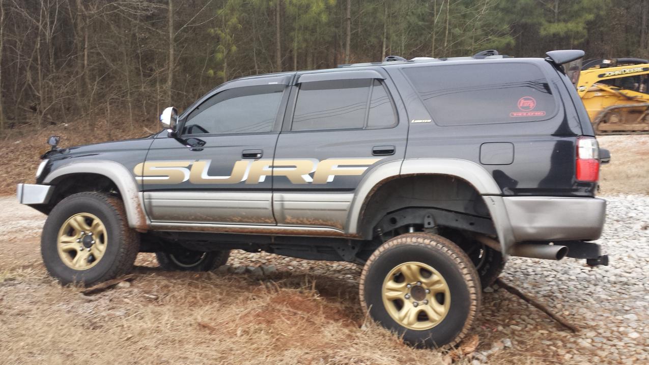

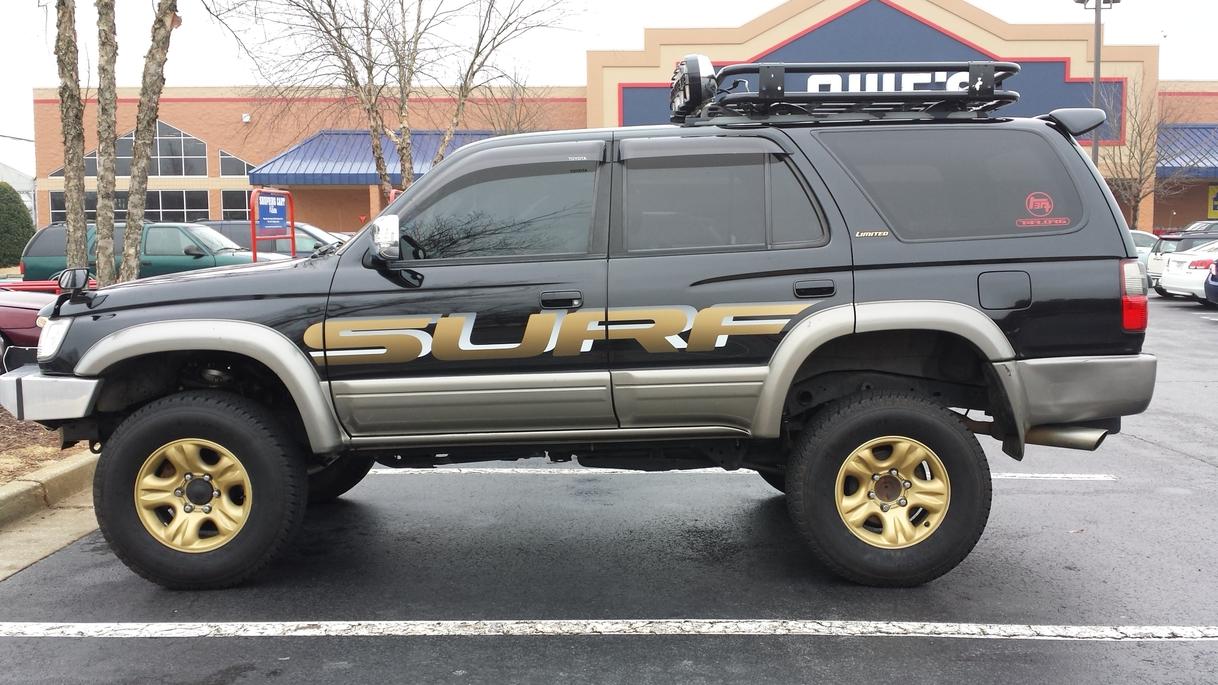

yy/yb from tundra and billy's and 97 lc with lc shocks 10x Better Here are a couple pics from my real camera see if this works better

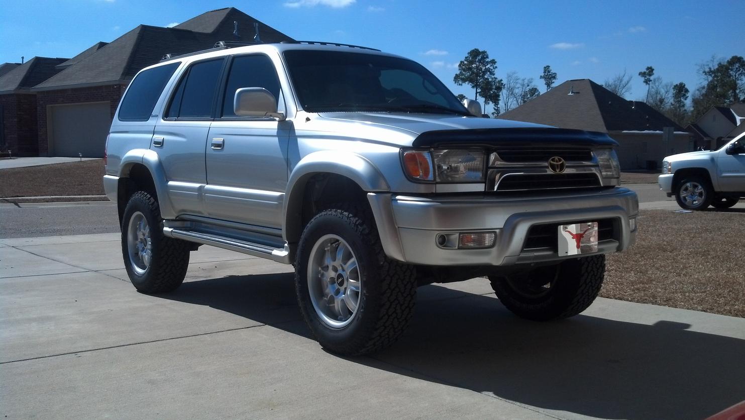

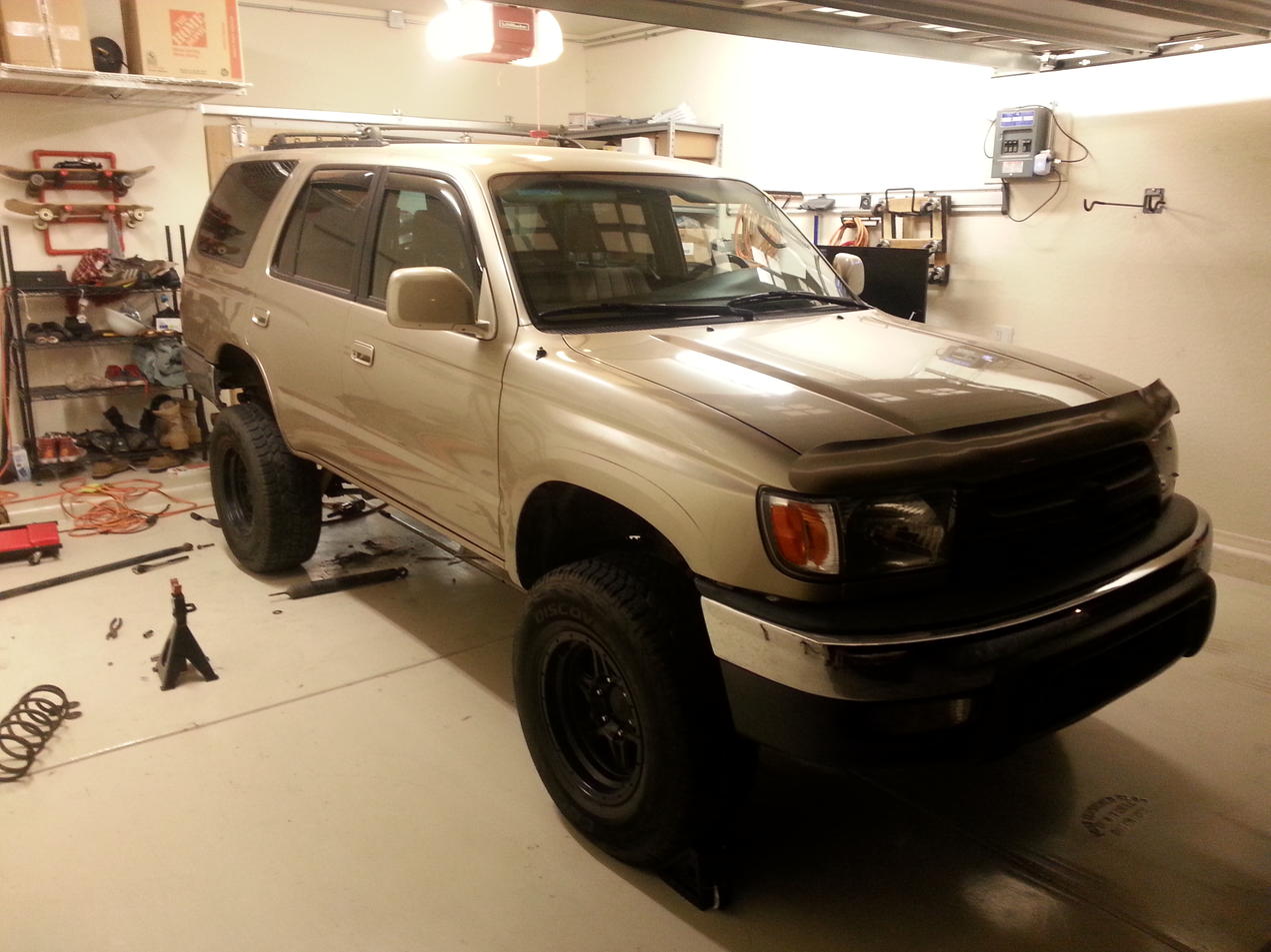

8 and some change

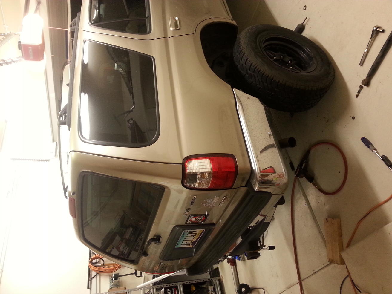

Paired with some extended Billies.

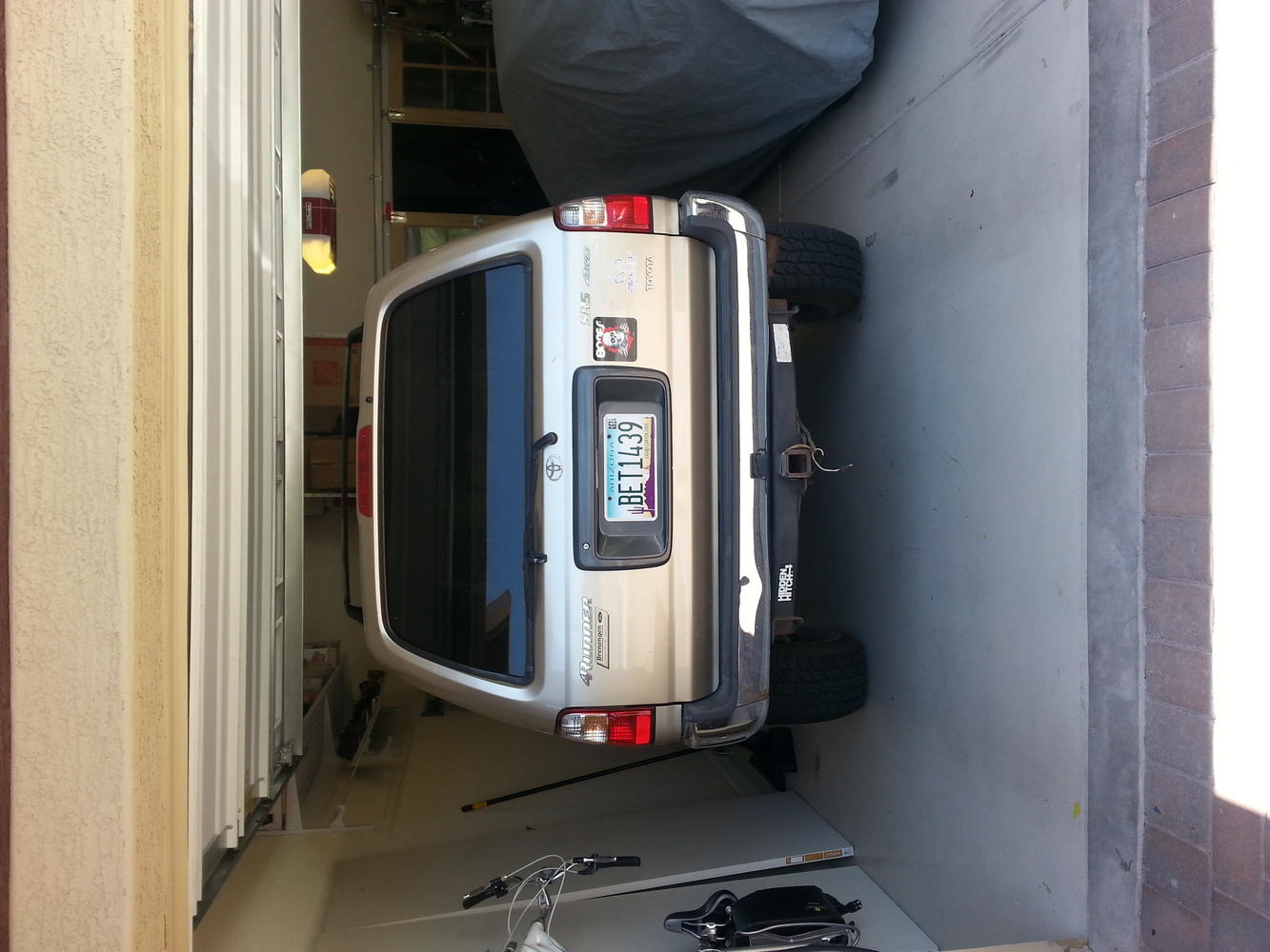

Right on Justin. Good to see another longhorn plate on the front of a runner. I live in Mobile and horn fans are far and few between over here.

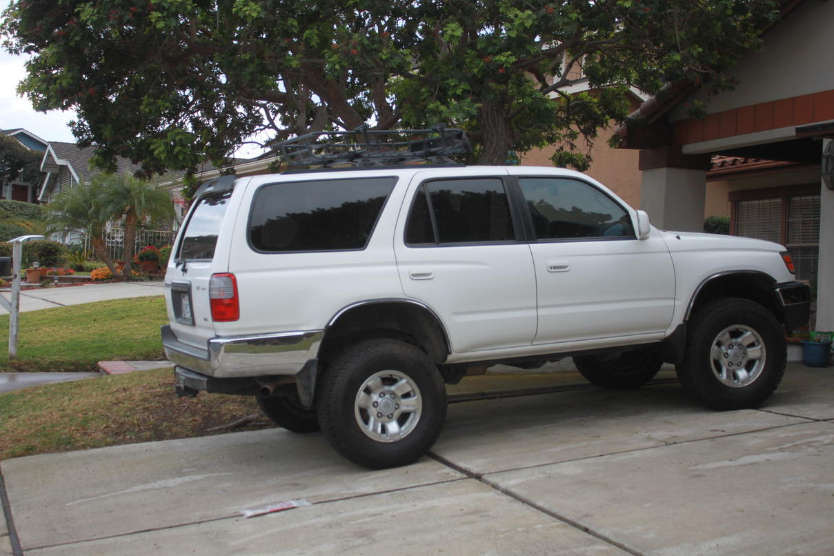

Here is mine with the SS 1.2 kit LC's in the back and RadFlo 2.0s in the front. Still got 31's on for now.

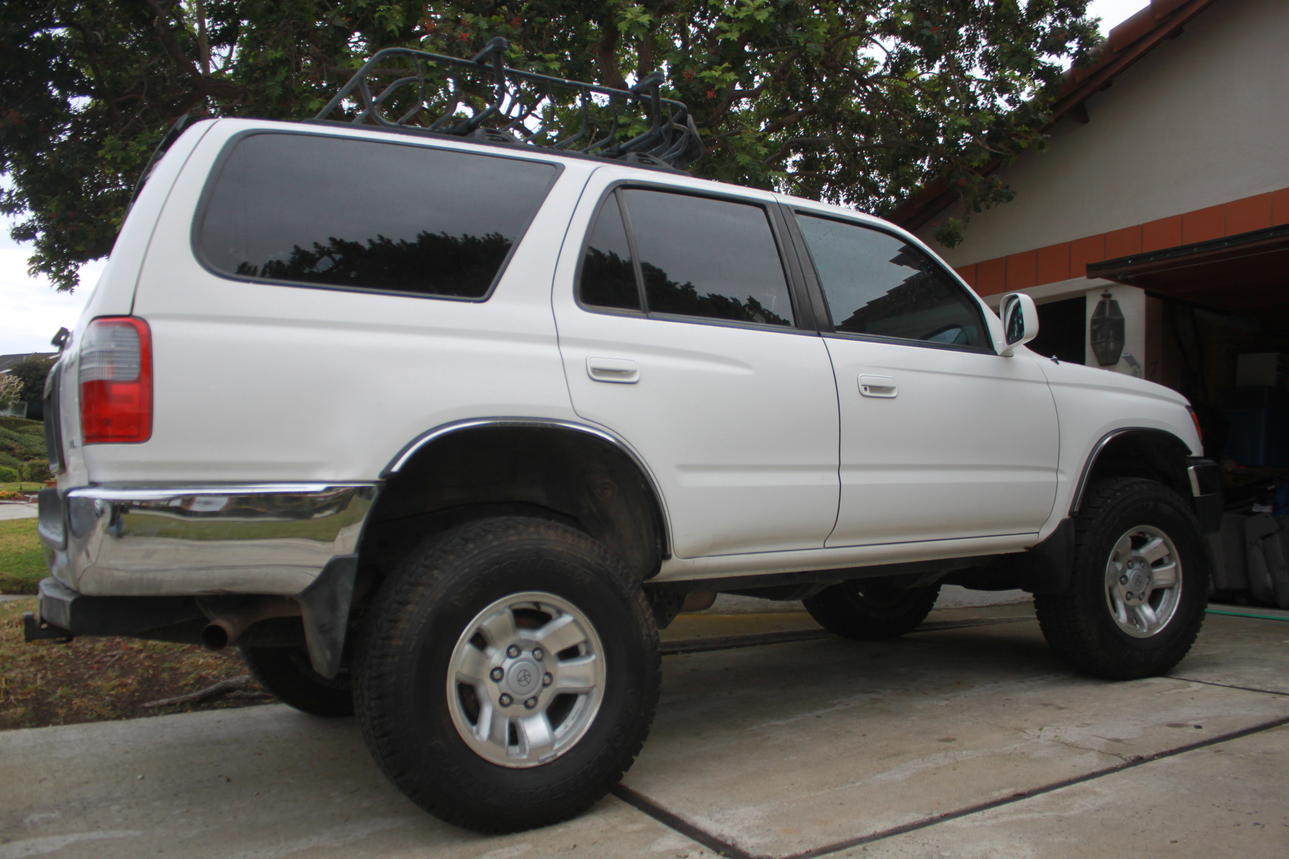

Install 8.5 lc wraps and Tundra coils yesterday.
FRONT:
BILSTEIN 5100 Tundra 5 notch
06 Tundra TRD YY, YB
REAR:
OME Landcruiser shocks
LX450 coils 8 wraps
TOYTEC Adjustable panhard bar
SIDE SHOT
