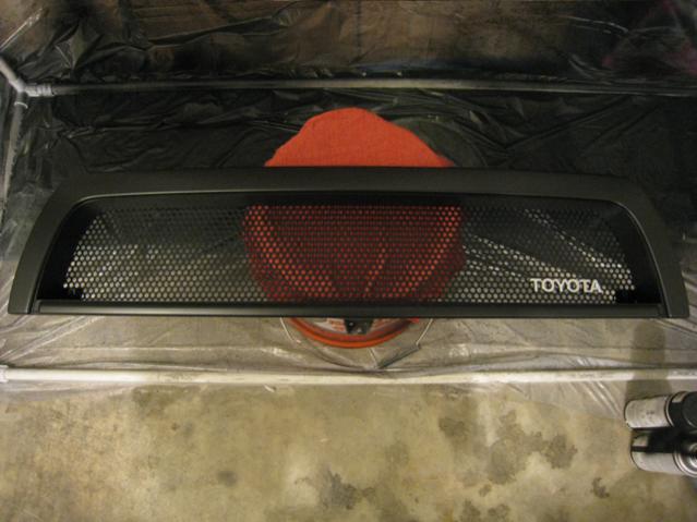

Bought the grill last summer and just finally worked up the motivation to finish it....

Here's a couple more I've done in the last month...
The current one I'm working on is a first...I'm trying to match the texture of the black SR5 flares.
And I may have my first color matched one coming up soon as well.
Once these are done, I'm going to rework mine...going to try a Raptor style with big TOYOTA letters.

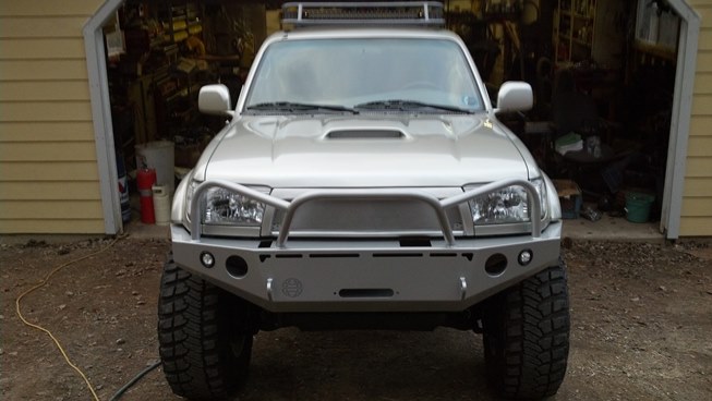

Installed on my 2000

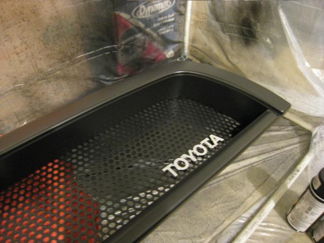

Finished up mine this afternoon:
I've been using SEM 39103 satin black bumper paint for all my exterior black trim, so I used it again here and it worked out well. Going to let it cure overnight before mounting it again tomorrow.
Grille material came from CustomCarGrilles (via Amazon), and was pretty much the perfect size and easy to shape with a dremel. I went with the circle mesh since it seemed sturdier and easier to clean bug guts off of, and I think I'm going to use the motif elsewhere too.
Emblem is the smaller one used on the rear gate (part 0042S35968.)
Thanks to BigFishAllDay for the easy grille attachment method, and to everyone for posting inspirations in this thread!

Here are some pics of the latest ones I've done.
This was the first one I did with some texture. He wanted it to match the black SR5 flares. Came out a little more textured than the pics show.
Standard satin black...
This was my first shot at color matching. The paint was kind of a pain to deal with, but after a few trial and errors, I got a pretty good result.

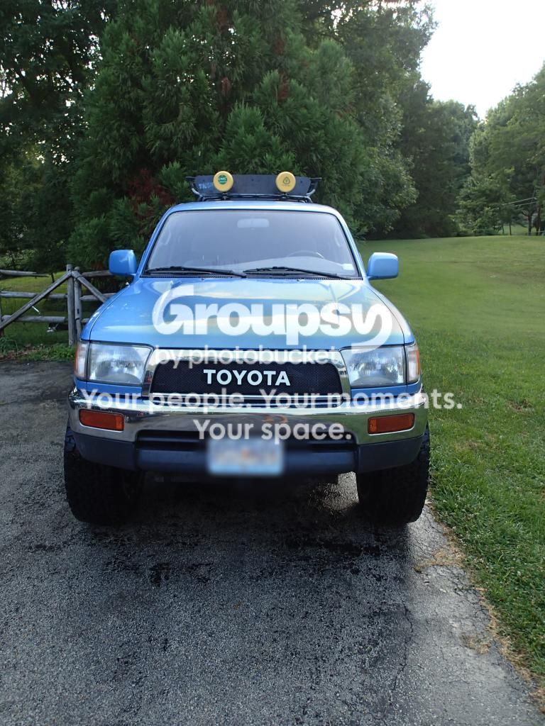

I originally bought mine off a member here, the outside of the grille had been modified and I just needed to install the mesh that had been precut. I was debating on having the FJ Toyota emblem, or leaving it blank, and I had seen zopperman used a 4Runner emblem which was cool and unique and I had seen the Tacoma Raptor grilles, so using our 3D printer at work I printed some letters for mine. I like it since it's unique and I haven't seen any other grilles like it. Nothing fancy, the letters were 3D printed with black plastic and then I painted them and just epoxied them onto the mesh. I've debated on painting the chrome black or color matched white, and also debated on doing a white outline on the letters or doing them white or silver since they're kinda hard to see in poor lighting...
DSC_4225_zps2c606909.jpg~original
539FF428-1F78-4A46-919D-984E9EC6547A_zpsn1vi93fy.jpg~original
