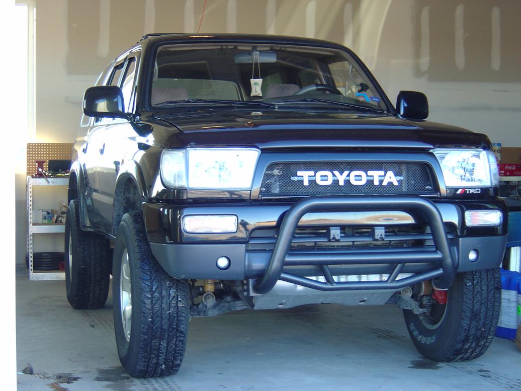

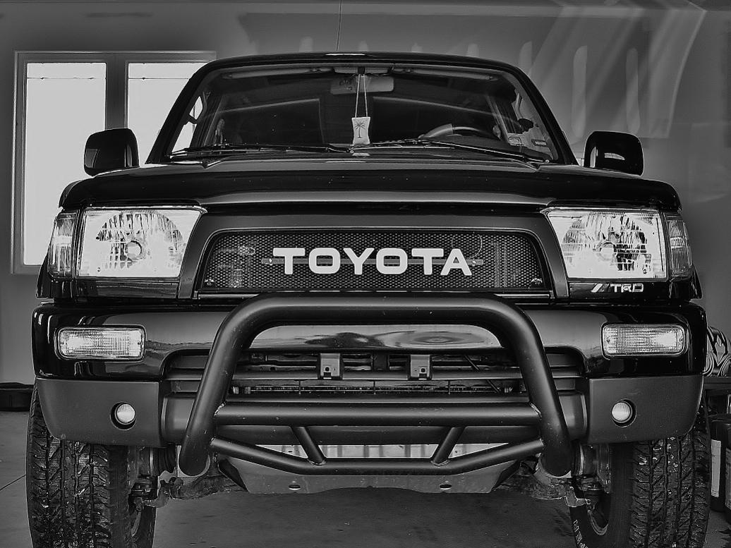

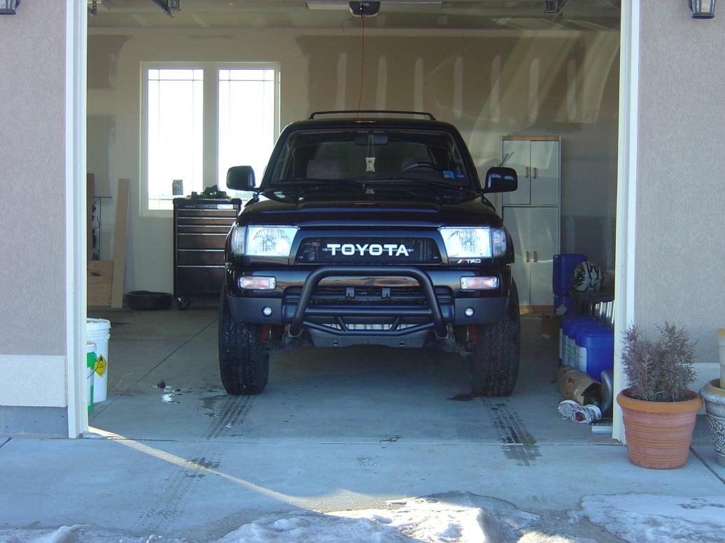

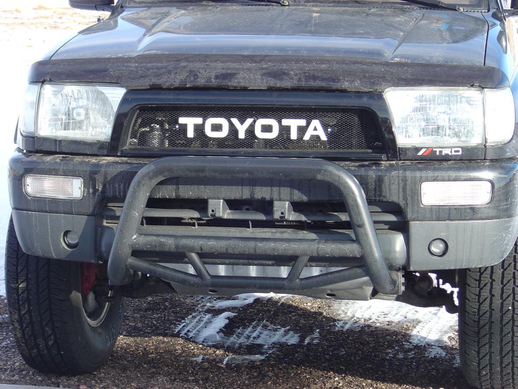

I went more "old school" look to match the actual FJ grill look.
I used heavy gauge expanded metal. I stole it from our metal shop. Pretty much scrap to them.
I then coated it heavily in bed liner to give it that rugged look. I think it turned out well.
I only have crappy cell phone pictures. No TOYOTA badge yet either.
I did mine back in December. Forgot about this thread. I cut the letters out of a peice of plastic.
