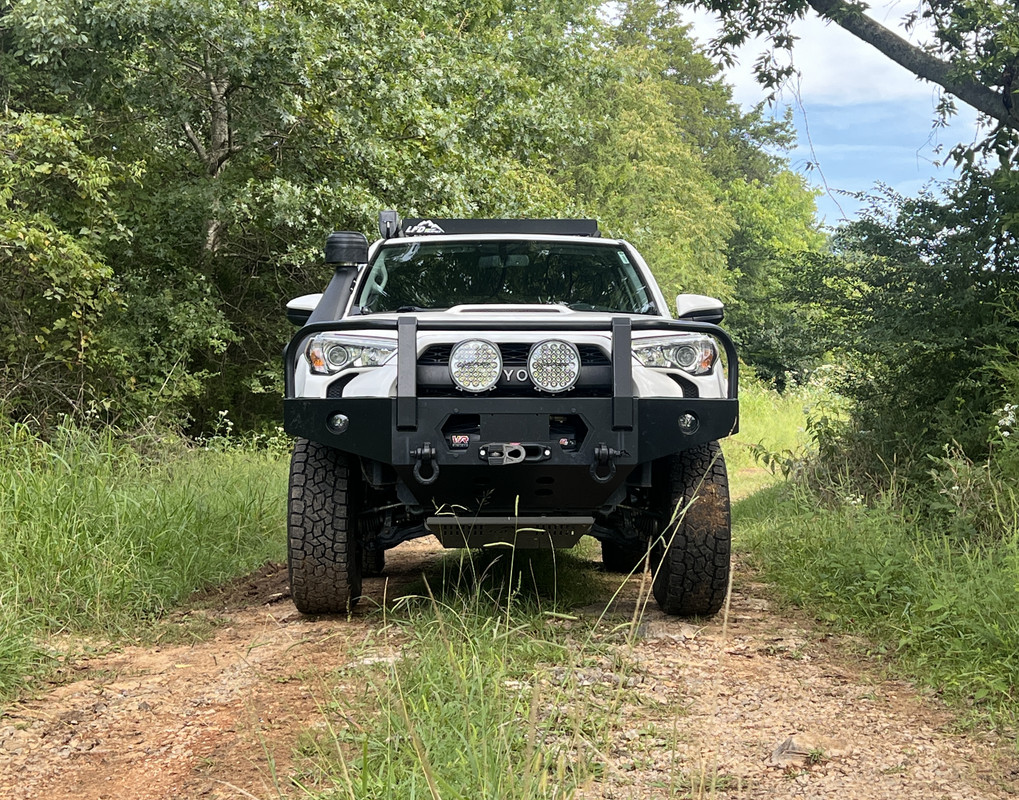

Now on 35s (still have mostly my entire wheel liners and fully connected to front bumper... With WI winter+salt I dont like the idea of exposing much if I can)
Each time requires more cutting. Would say it didnt get "serious" until 305s. Thats where your cutting a lot of bumper, rear cab work is def needed.

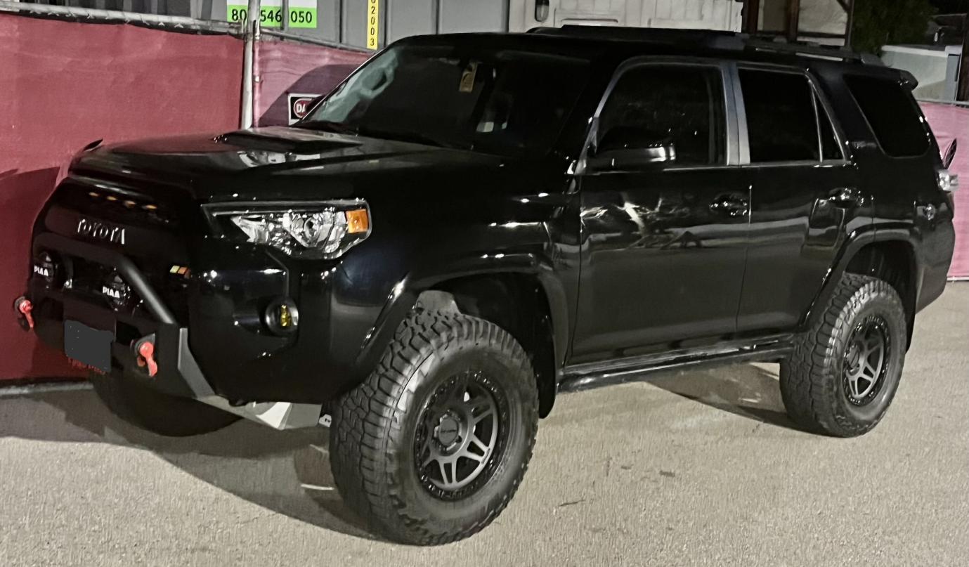

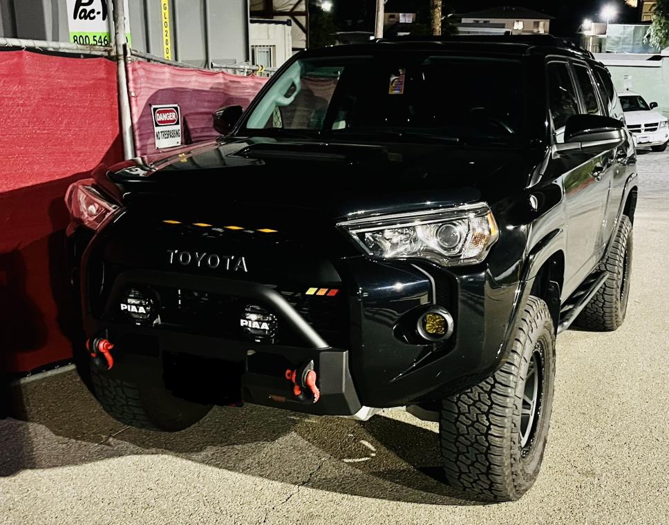

Running 285/70-17’s on 17 x 8.5 +0 wheels. Pushed front liner slightly forward, no BMC, camber on aftermarket UCA’s at 3.7 degrees, front fenders were already trimmed on the Pro from the port. Still running front mud flaps. No clearance issues.
