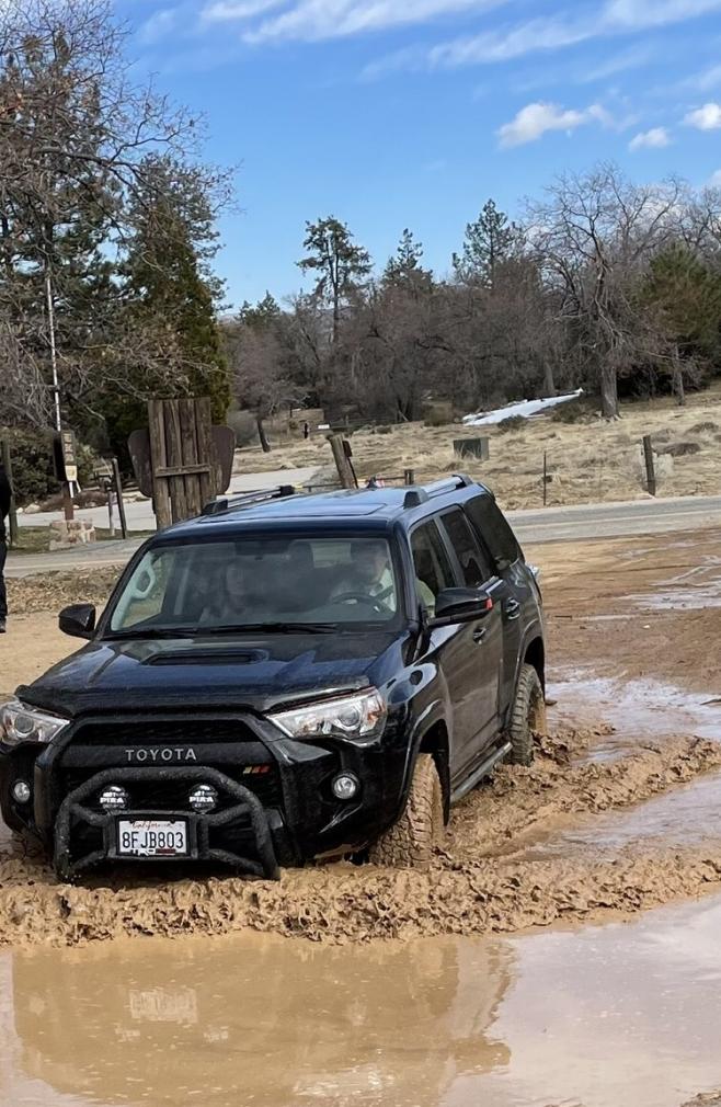

Dirtylife Roadkills
17x8.5 -6 offset
285’s

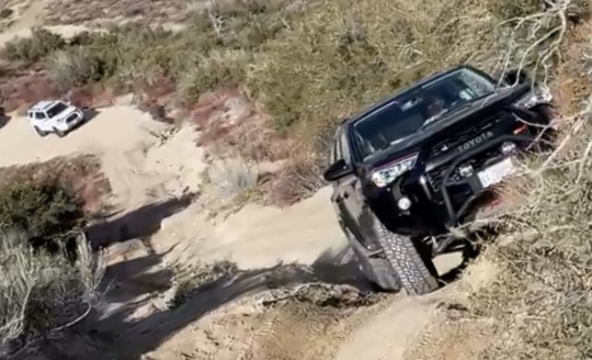

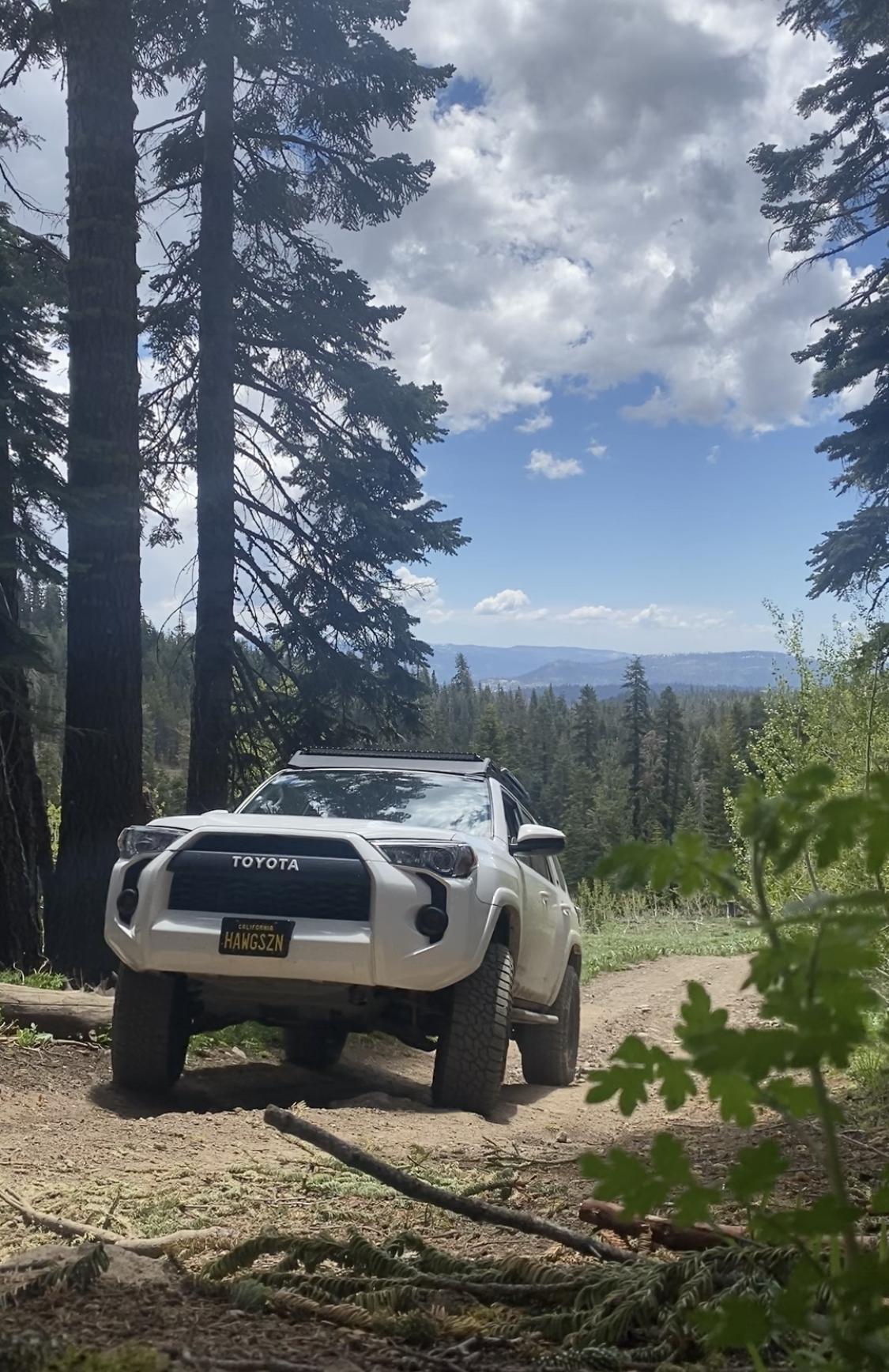

Wow…..I love your stance! That’s what I am talking about! But, I am guessing you may have a BMC mod correct? I will check out the site that you mentioned. Very helpful!
to fit these tires and this much offset, you need BMC, UCA's, fender liner trim, possibly pinch weld mod, and cutting the plastics in front of the front wheels.
