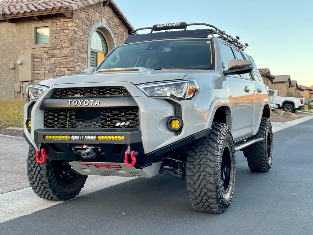

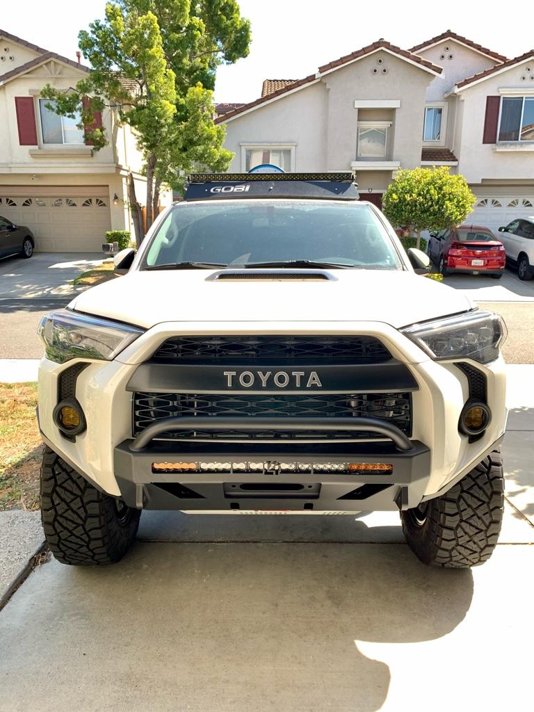

-38mm w/ 295/70/17 Nitto RG
Jba UCA
Bmc
High clearance additions
Trim liner

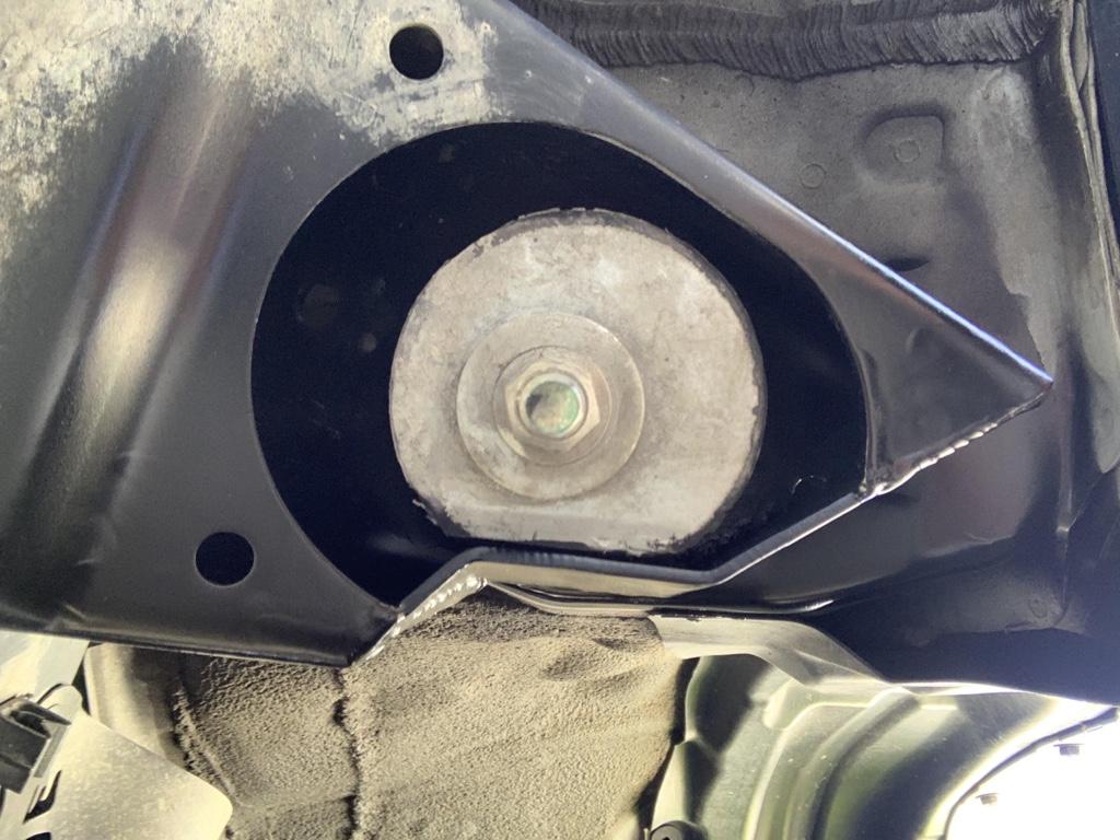

yes. I've explained this to you already. You can not fit the -38 wheels without doing the BMC, even with stock tires. and especially not with 285's.

Yes, BMC for sure, fender liner removal, pinch welds and rocker caps trimmed…. But I love the look!

if you do the BMC properly and weld in a plate, there's no long term structural effects. I drove mine offroad for about 10k miles without even doing the plate and it was fine. but I put enough miles on mine that I was out of warranty in a year, so I dont know anything about that aspect.

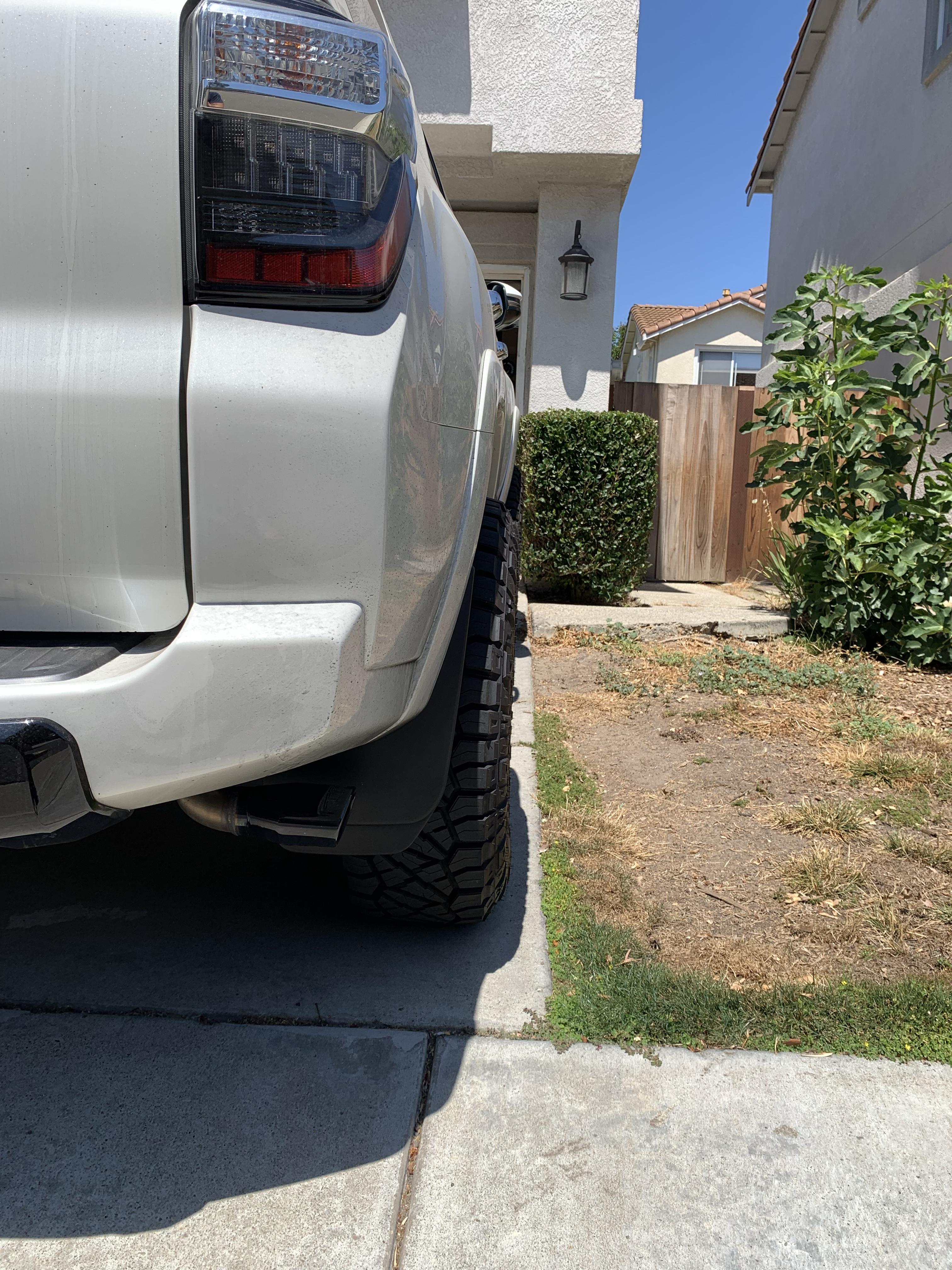

To add a little info on my experience. I have the TRD Pro wheels with 1.25 spacers and SPC UCA’s on a 18ORP with 285’s. I get rubbing on the back fender well. I took off the mud flaps and still get rubbing on the weld joint behind the mud flaps.
I’ve had the alignment tweaked and still get some rubbing at the extremes. I’ve done the fender liner mod and still get some slight rubbing there from pushing my wheels forward during he alignment. I haven’t decided if I want to keep tweaking or just give up on the wider stance. I’m unwilling to cut into the fame to prevent the rubbing there and my alignment guy says pushing my wheels to far forward will affect the steering to much.

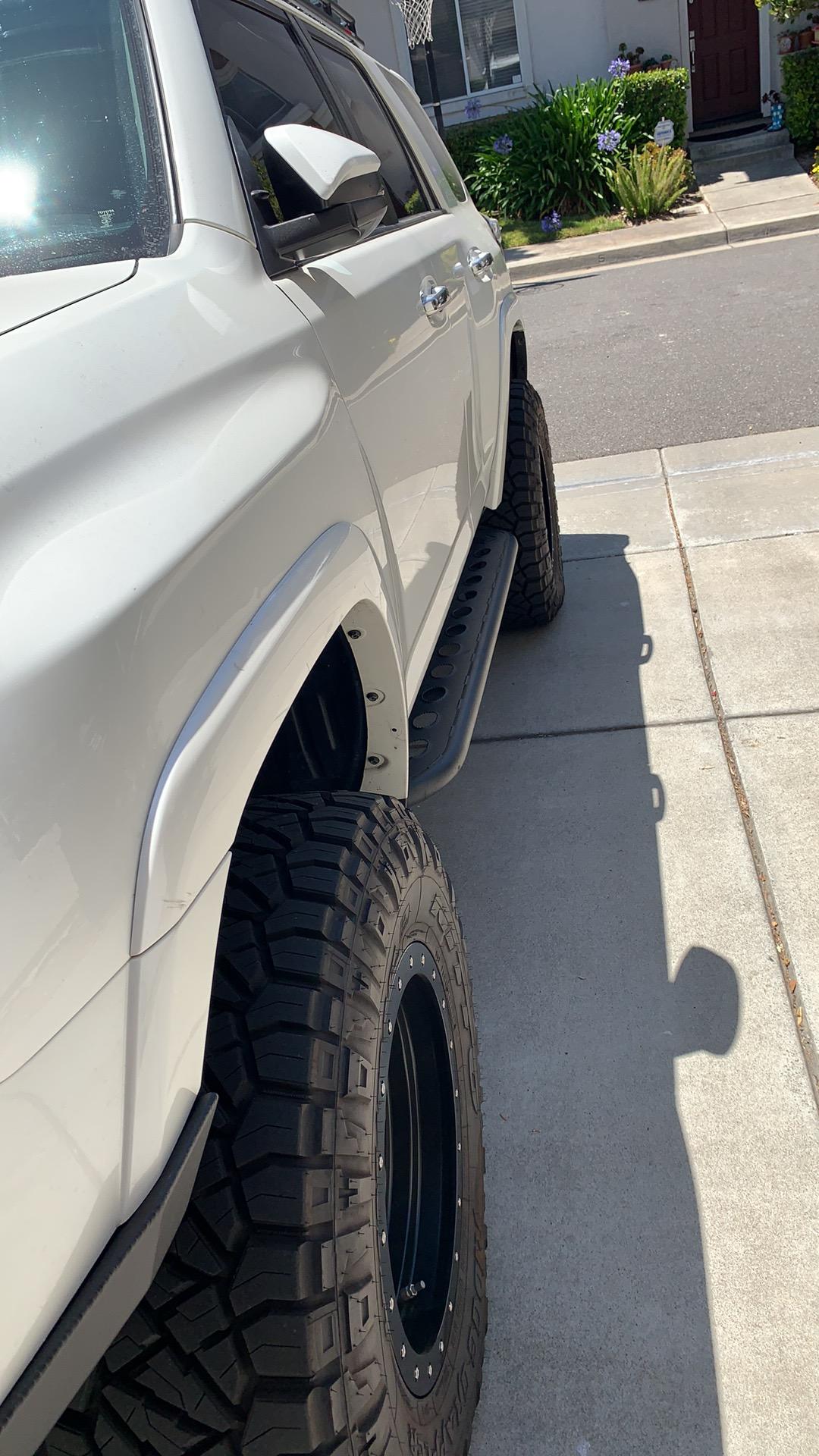

Other than that, SCS F5 in -38 w/ BFG ko2 in 285/70/17 is my jam.
I may get the courage to go that wide someday, but it looks like for now I am not going to go to the extreme. But man…..it looks sick like that!
