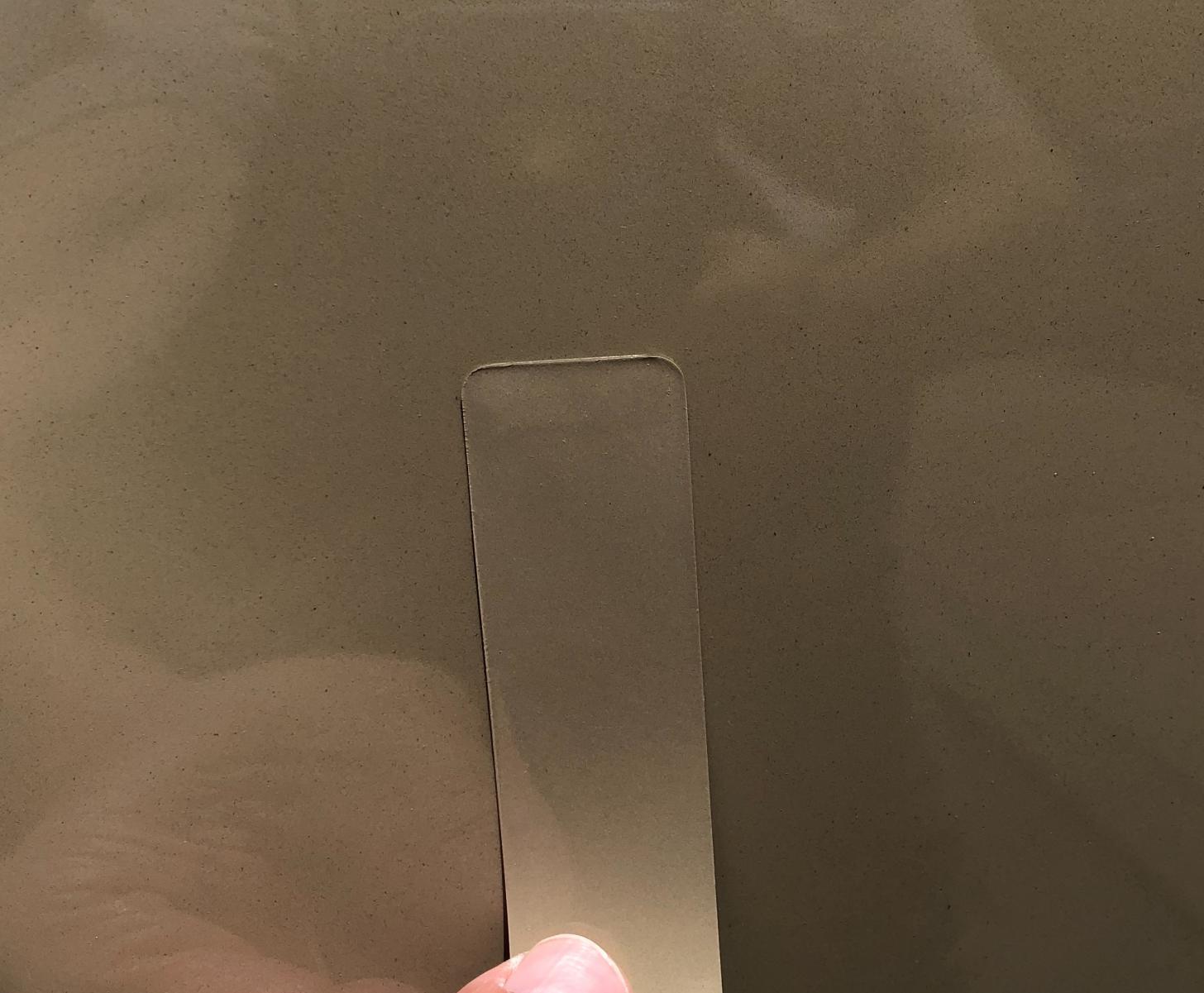

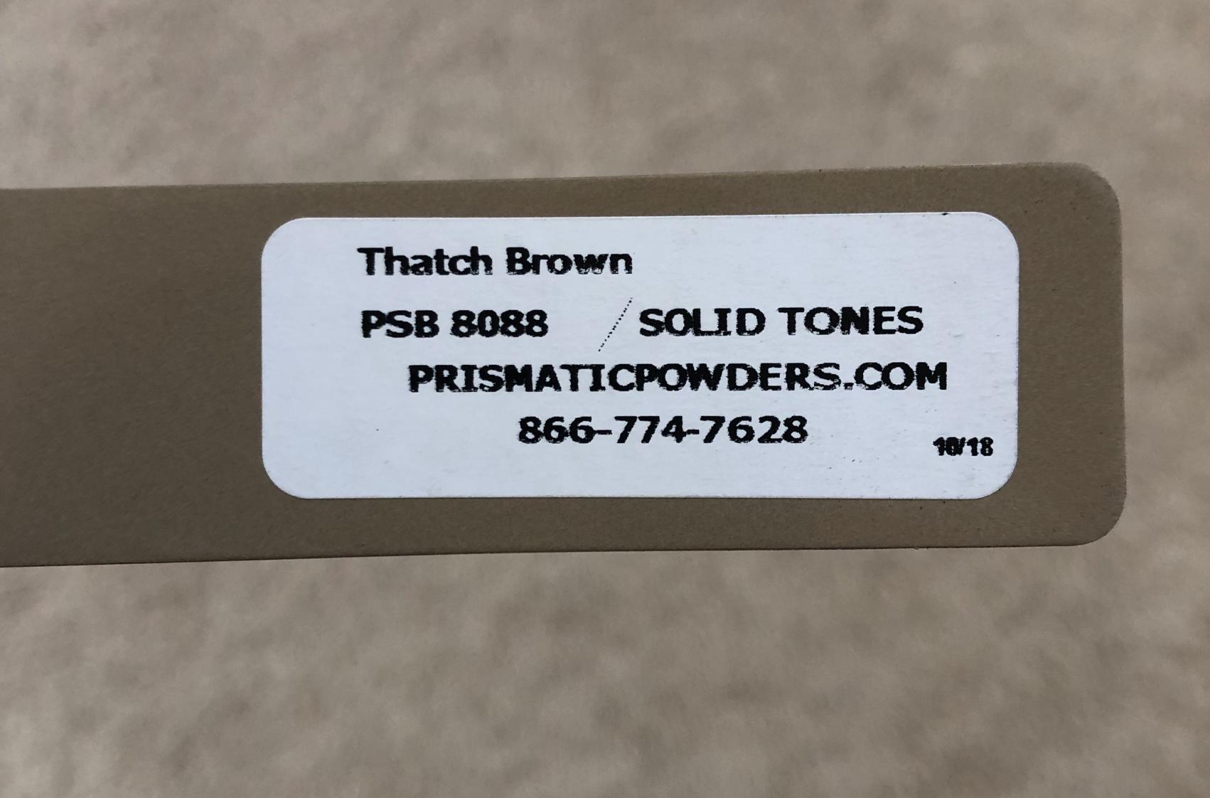

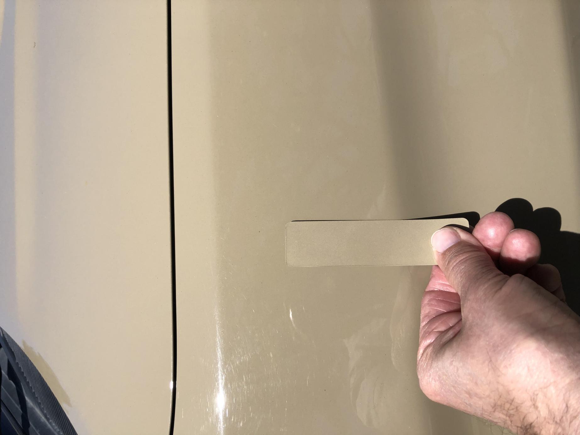

I just bought a Shockworks front bumper for my TRD Pro that I’m still waiting to receive. I wanted to powder coat it but was having a hard time finding a match for the Quicksand color on my 4Runner. Well I finally found one and it is a exact match! A company called Prismatic Powders in Texas makes a matching color called “Thatch Brown” (color PSB8088). In the shade it’s a exact match. In the sun it’s just a tad light. (See photos)
The bonus on this is that it’s cheaper than a paint job. Most shops were going to charge around $800 but my powdercoat will cost just $450 and be more durable. I will send pics later when it’s done but for now here are pics of the actual powder coat sample from Prismatic Powders.

Anyway, I know the Quicksand color is a very hard color to match. Even the paint job from the factory has slight variations. The plastic front and rear bumpers are a tad lighter than the rest of the body. I’ve done a lot of research on this board and on my own to find the best solution.
If you want a perfect match you’ll need to go to a body shop but it is the most expensive option. Most shop offered to paint it for around $700 to $800. Some wouldn’t even do it because they were afraid the paint would chip too easily on a metal bumper. This is why I wanted to powdercoat it. So if I did a powdercoat primer base and then painted it, I would be looking at a total of around a $1,000.
The cheapest option was to do a powdercoat primer and then hit it with a couple spray cans of Automotive Touchup in Quicksand. This option would Cost me around $400, $350 for a primer powdercoat and another $50 for about 2 cans of paint and 2 cans of clear coat plush respirator. I’m just not sure how durable the paint from the can is.
So to buy the powdercoat from prismatic and have a local powdercoat shop apply it will run me about $450. I think this is the best option. The color is a very near perfect match. (In fact it’s actualy a closer match than my front bumper) and the powder coating will give it a more durable finish than paint.
