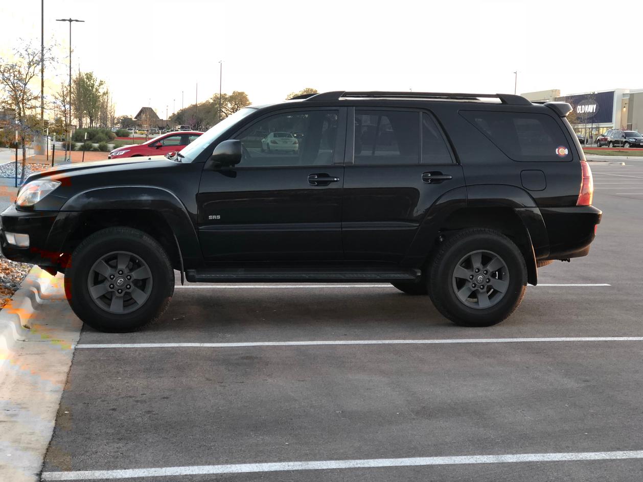

I powdercoated my own wheels on both of my babies myself.

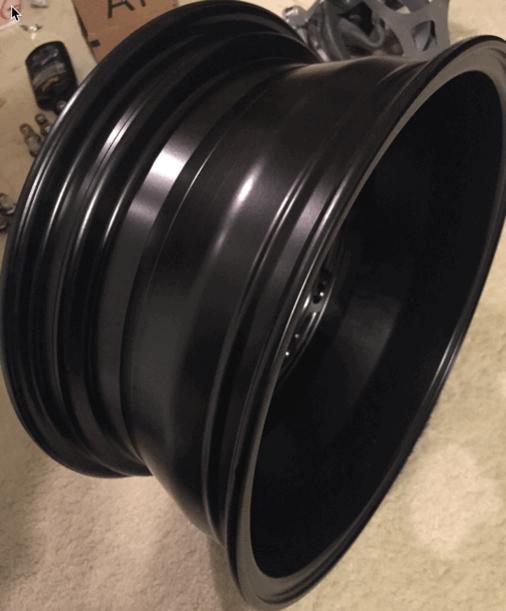

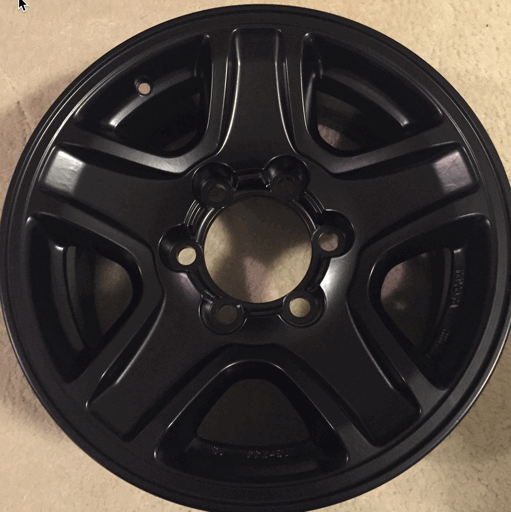

I fell in love with my 2001 4Runner after power coating the factory 5 stars. It was like a new truck. Another advantage was the inside of the rims were like new. If you fill you tires at the gas station with the small air compressor, you are probably putting a lot of water in your rims that lead to corrosion. Sure this depends on dew point. My rims came out like brand new rims inside and out. They look more perfect than the photos.

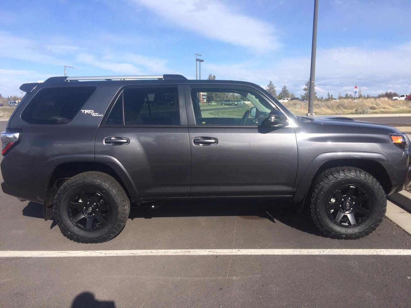

I just got mine powder coated and they turned out great! I didn't have to wait much tho, It was there for two days. How ever I ordered new tires from them and had them do it while the tires were off so I didn't have to pay to have them mounted and balanced twice.. Ended up costing less than half of the cost for just showing up for a powder coat. If your close to needing new tires I'd just wait and ask them what kind of deal they can do. I schedualed an appointment however which was 5 days out but that was when the new tires would show up. They even painted my hubs to match, the only picture I have and Im not sure what size this is going to post...

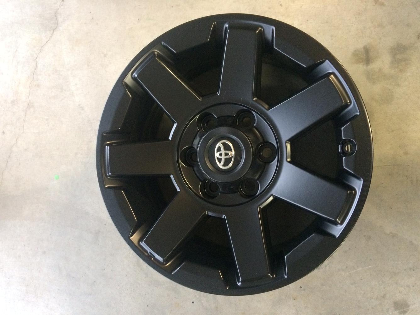

Couple things, I think the market for stock Trail wheels is pretty prominent. I own a 14' SR5 Prem and just purchased a second set of 13' FJ/T4R trail rims. Had them PC'd for $400, I'm in the upper Midwest. Went with a darker shade, Baracuda Bronze. Looks really sharp, although not mounted and balanced yet. Will like the improved stance with 285's and 5100's on the corners.
A good option if you want to keep a more stock look with some internal gutt upgrades.
Picked up a 2nd set of take off trail wheels, had them PC'd for $300, am really happy with how they turned out. Gonna have the set I just pulled off done too and throw our winter studs on them.
