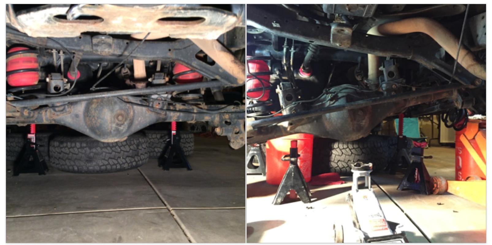

1) XREAS removed

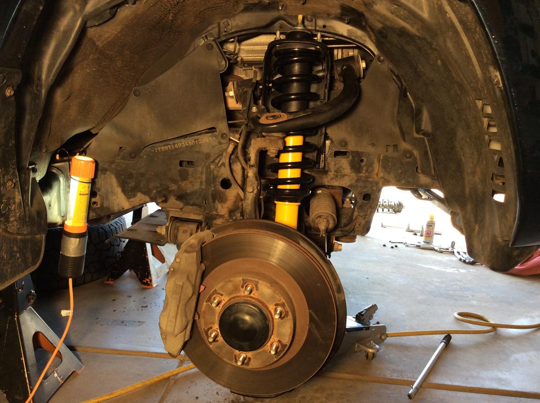

2) Front OEM XREAS struts, OEM coils, and Daystar 2 1/2 spacers removed
Front OME 90021 struts and OME 885 (w/ 5 mm spacer DF) coils installed

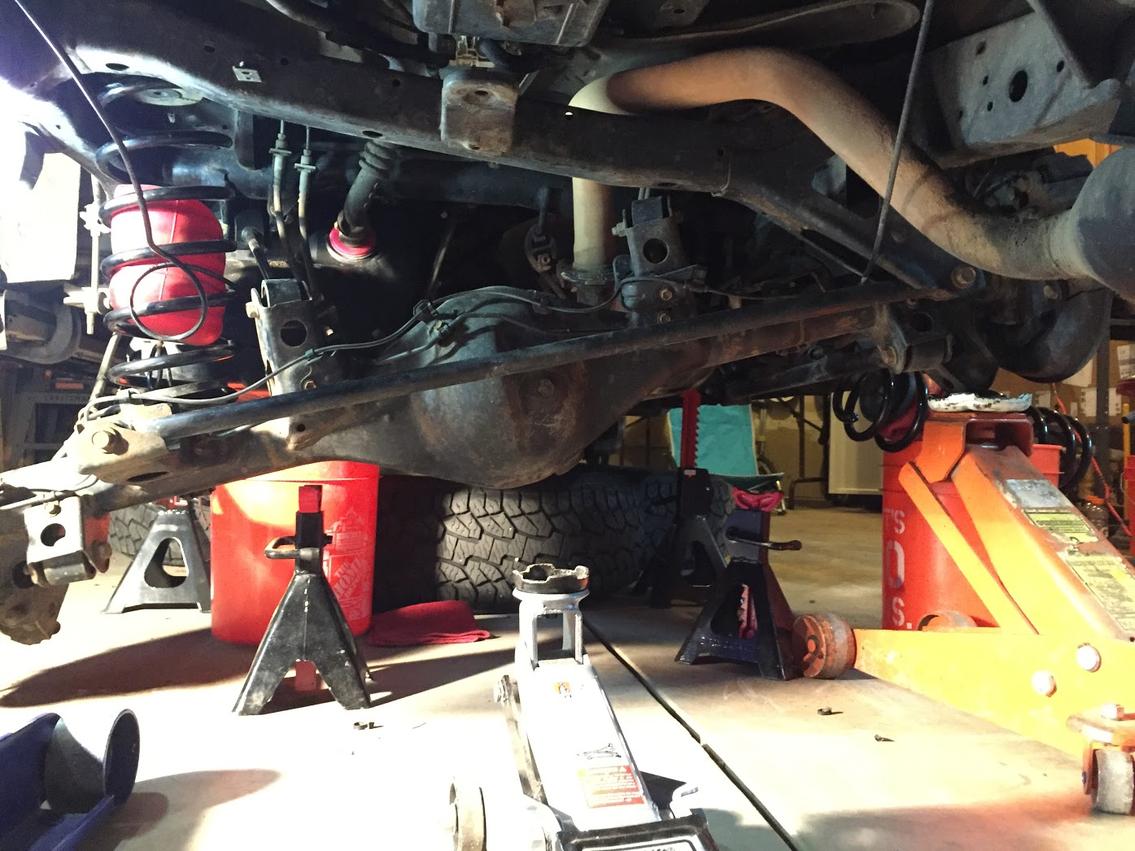

3) Rear OEM XREAS struts, OEM coils, Daystar 1 1/2 Spacers, and Airlift 1000 removed
Rear OME 60020 struts, Toytec RCC2.0HD coils, and Airlift 1000 installed
Original center of axle to bottom of fender and preliminary after
DF - 22" and 23"
PF - 22" and 23"
DR - 22" and 24 1/2"
PR - 23 1/2" and 24 1/2"
My DF XREAS was leaking so not really sure why the DR was low (poss because of gas tank???) compared to PR, but after suspension upgrade front and back are even!!! I am expecting a little break in and I will measure again and update over time.

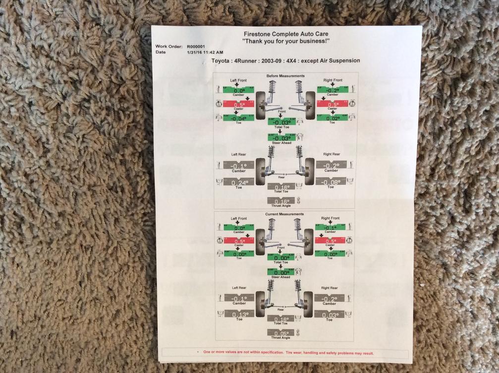

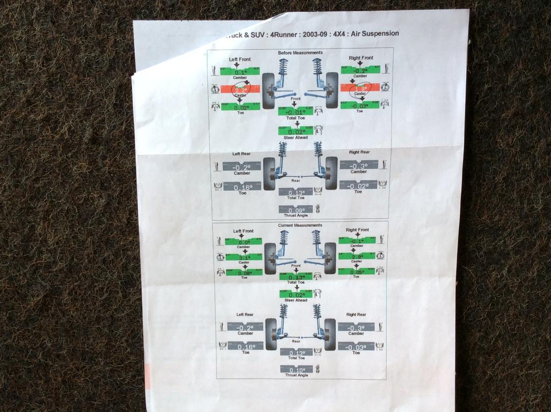

Alignment - old
At Firestone for alignment after suspension upgrade (lifetime alignment purchased in 2010). Save 100 bucks on this mod...sweet!
This a pic of the alignment specs done in 2010 with Daystar leveling kit. I will post another pic of alignment specs after alignment today!

Post build alignment
...and the results are in!
In spec for Camber and Toe, and out of spec for Castor! I'm not thinking any more needs to be done!

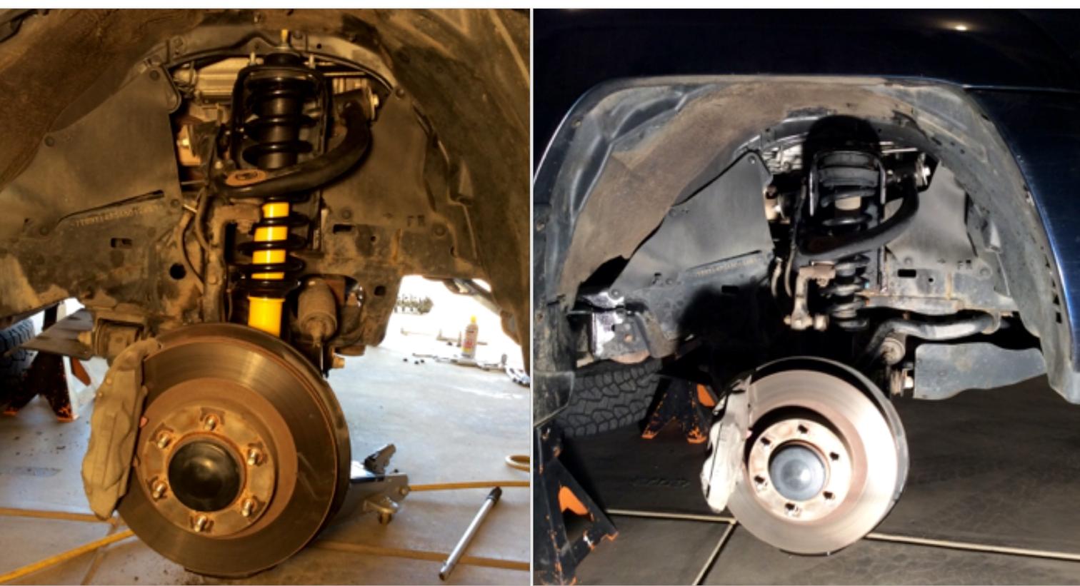

Creative ingenuity
We didn't have/use a coil compressor for install. As you can see from pic below we used creative ingenuity, a pry bar, and a whole lot of persistence! This was just after we got DR installed! Yep...it was a PITA, but well worth it!

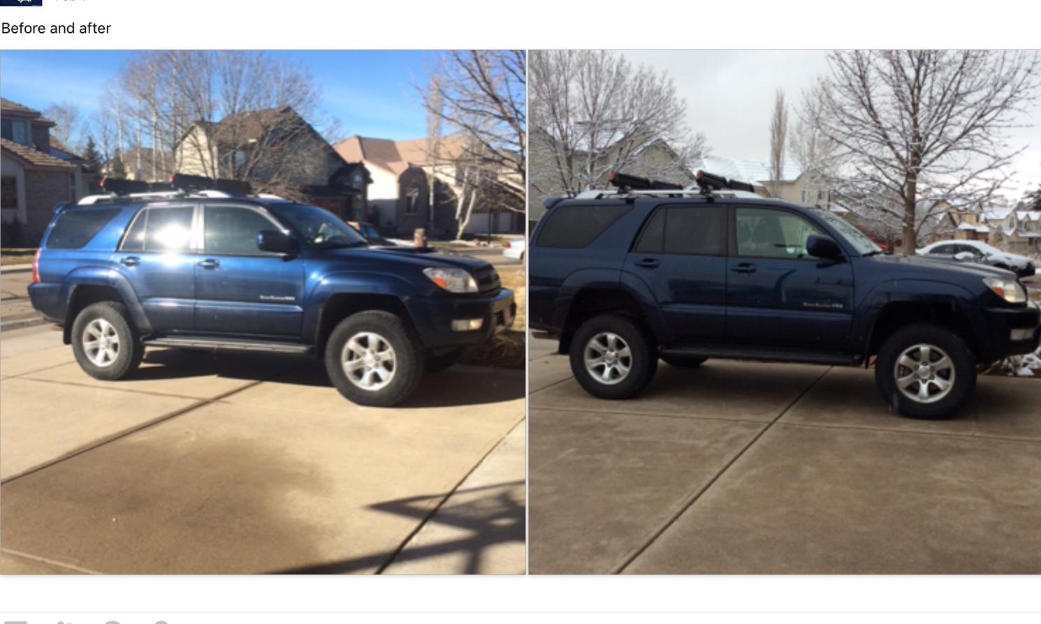

Front before and after
2) Front strut/coil before and after

It seems like your front was taller than OEM already! Did you have a Daystar leveling on the front?

Yes, I had a Daystar 2 1/2 X 1 1/2 leveling kit.

Alignment question
[MENTION=66389]BlackWorksInc[/MENTION]
Hoping you would be willing to peak at my alignment specks in this thread (posts #27 & #28) and share your $02. With Daystar lift all specs were green. After replacing with OME/Toytec last weekend camber and toe are green, but castor is red. It's still positive, but at .5 vs. minimum spec of 2.5. It drives straight and steering returns to straight when I release the wheel. However, it feels a bit "floaty" at speed and steering wheel is not dead straight.

Yeah that's way too low a Caster setting, I'm not sure how they even gave that back to you like that. It will feel floaty with such low Caster.
I have a feeling they didn't set the cams up right when they did the alignment, because even with a lift they should have gotten a bit better than that.
