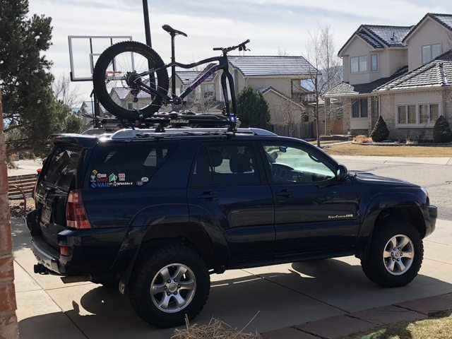

How my T4R sits today

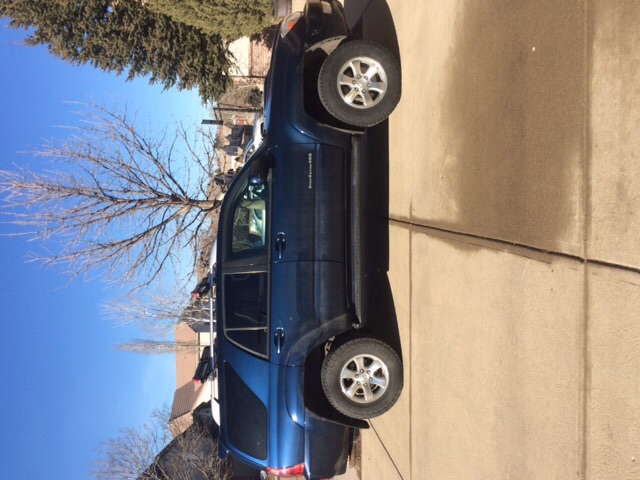

So here is the first post for my 2004 4-Runner Build. This build was prompted by a leaking XREAS strut (112,000 miles) and to upgrade the entire system is going to cost less than to fix 2 of the 4 XREAS struts: not to mention the better ride quality when it's done!
I will add more pics along the way, however these first 2 (couldn't get 2 pics on one post ?!?!?!? so 2nd pic is on 2nd post) show my T4R fully loaded with PUP and when completely empty before suspension upgrade. My airbags are inflated to 20PSI in the pic with PUP. I chose the Toytec Superflex RCC2.0HD as they are a bit taller (2 1/2" vs. 2.0" lift) and stiffer than the RCC2.0. I wanted a little stiffer ride, but not as stiff as the OME 895 is reported to provide based on overwhelming feedback on this forum.

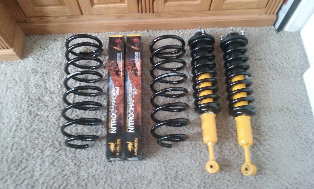

Parts going on
-Parts ordered from Toytec today 1/19/2016
*Front - OME 885 springs with OME 90021 struts and trim spacer
*Rear - Toytec Superflex RCCHD2.0 Springs and OME 60020 Struts
-Reinstalling Air Lift 1000 air bags
pic pre sus upgrade.

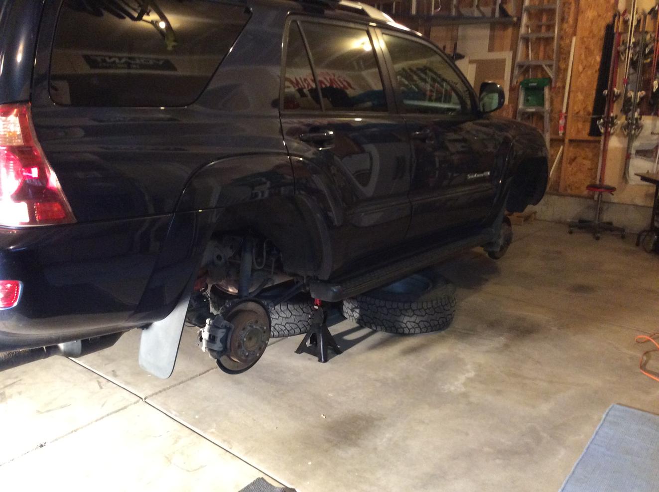

...and so it begins. Final prep to get XREAS out and OME in. Real work begins tomorrow am, but runner is on jacks, 5 tires removed, and garage is ready to go.
