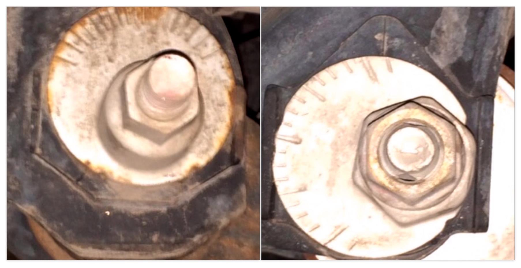

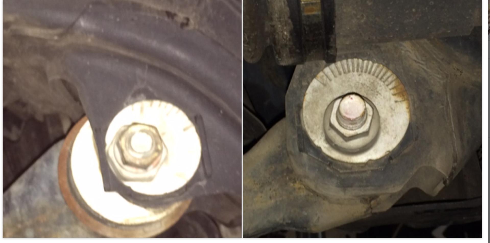

I don't know what condition your alignment cams, tabs, and lower control arms are; but ideally you'd use the rear cam bolts on the LCA to set the majority of your Caster and then fine tune Camber with the front cam bolts. They should be able to get it somewhat close to factory that way if everything is in good shape.

LCA alignment images

Drivers side LCA
Left image is rear cam and right image is front

Passenger side LCA cam pics
Passenger side LCA
Image on left is front cam and image on right is rear cam.

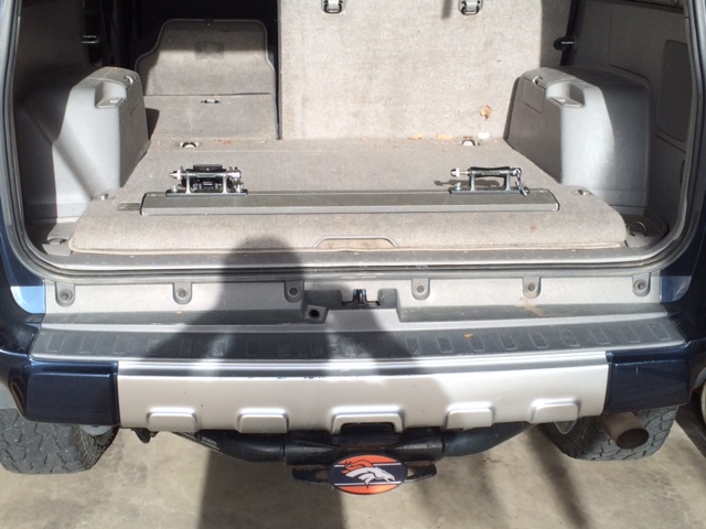

Inside bike rack.
After 12 years I finally decided to create a better attachment for my internal bike rack. It won't slide around and let my bike slam into the glass anymore! Pretty simple solution and it is a mod so I thought I'd share. I use the rooftop primarily, but as I'm getting older (cough cough) it's not as easy to put bikes up there.
I still haven't figured out how to get more than 1 picture in a post so there are 3. I haven't even tried to figure out photo bucket.
1 older Bike Tight rack
2 traditional 9 mm skewer Bike Tight
1 Rocky Mount Through axle adapter
2 1/4x20x30 connecting bolts
2 Fender washers for underside of shelf
I drilled 2 1/4" holes in the rear shelf. Then I inserted the 2 connecting bolts through the base rack and the shelf. Voila! No more sliding rack and bikes stay still!
