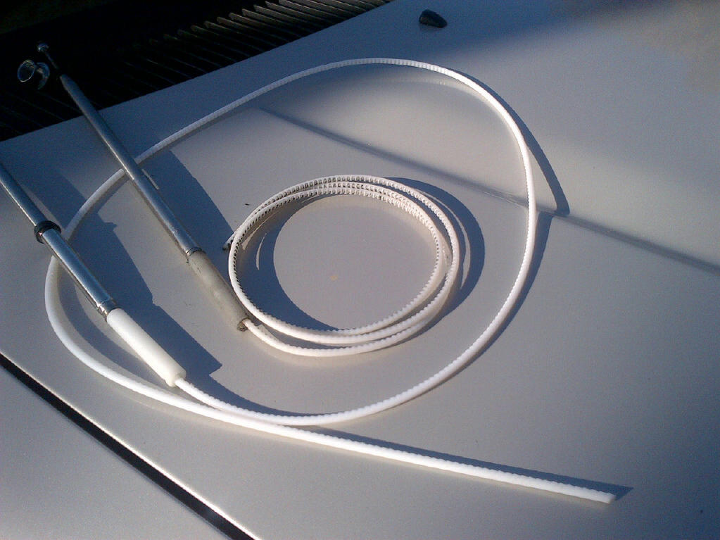

Guys, I'm happy to report that the issue has been resolved. If you have the same issue as I did, make sure you buy the high quality OEM antenna mast. They are only a few bucks difference, made my day.

Both of them claimed their antenna masts work on 99 4Runner but the quality is totally different. More importantly, the real OEM mast is a little bit thicker than the after market one.

It says "Direct replacement for OEM" in the ebay description. So, it is not OEM. You make sure you get the real OEM mast to avoid unnecessary issues like I had. OEM is only $2 more.

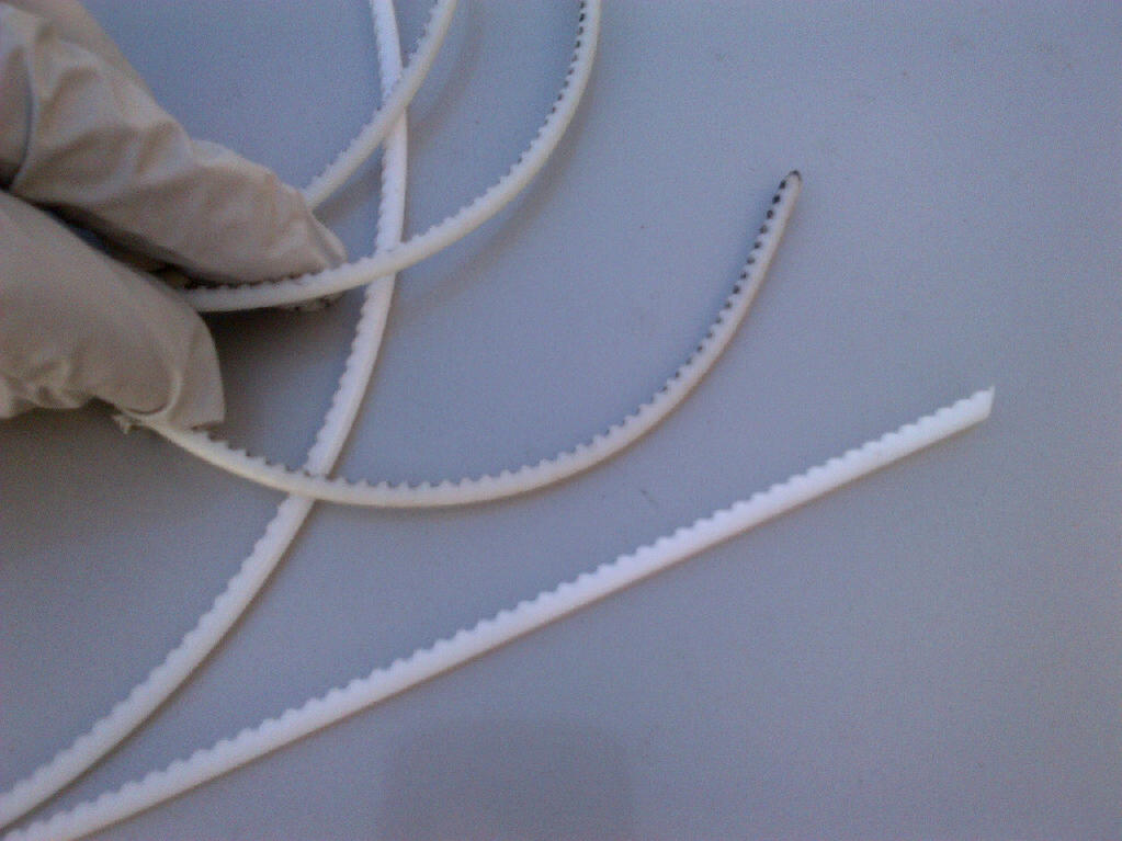

ouki is THE MAN. I received the new $18 mast from raderra (very fast shipping, by the way) and it worked perfectly. I got out my vernier caliper and measured thickness from top of teeth to back and got these results:
Cheapo e-bay mast tail: 3.5mm
Raderra e-bay mast tail: 4.2mm
Factory mast tail: 4.0mm
The piece of factory tail was what was left inside when I cleaned out the motor. It was visibly worn after 12 years, but still worked fine until it broke. It had zero flexibility--if you bend it at all, it breaks. Anyway, I figure it was probably 4.2mm when new.
So for anybody with this problem in the future, make sure your mast tail is at least 4.0mm thick. Buy a new mast from seller raderra on e-bay and avoid the cheap $12 ones all over e-bay.
