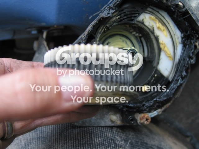

The 99 came with an antenna that would grind for several seconds after reaching the top. It wasn't a skinny or bad mast though. Whoever had repaired it before neglected to take out the broken bits. When I opened up the motor I found the broken pieces and also a broken gear that pulls and pushes the antenna in and out. My half-baked theory is that not pulling the bad bits out stuffed and stressed the thing and cracked it. It was still together enough to work-ish.
This thing I am holding is the thing of which I speak.

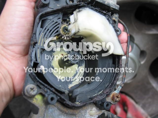

It was cracked in half where it fits over the post:

Just another little tidbit to chew on...
Mine's doing the exact same thing, I guess I should take it apart before I buy a new one just in case!
