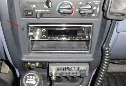

FWIW I am a fan of the power antenna, as it can be retracted while wheeling in terrain where it (or a whip) may otherwise be damaged. I use the "Y" adapter so I can run both rear glass antenna + power antenna. I wired in a dedicated switch (pic below) to be able to raise/lower the power antenna on demand with the stereo still on. In many cases I have found the rear antenna to be adequate and do not even need to raise the power antenna.
