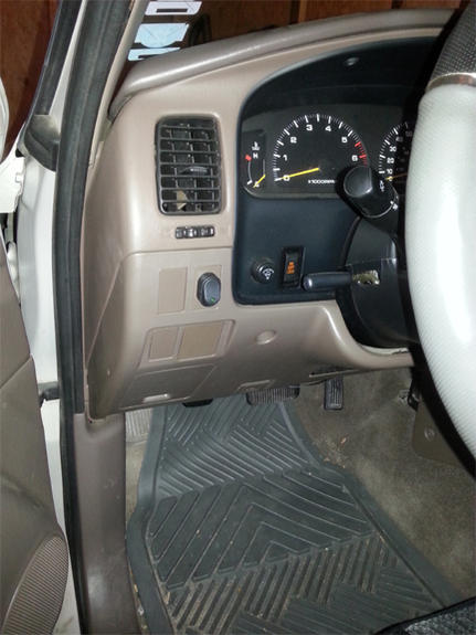

here's my rocker switch. Little dremel action and grounded to the metal bracket just below the fuse box. My head unit has the antenna up all the time, regardless of radio, CD or USB. I just wanted to be able to use the thumb drive whilst not risking losing the antenna on the trail -
