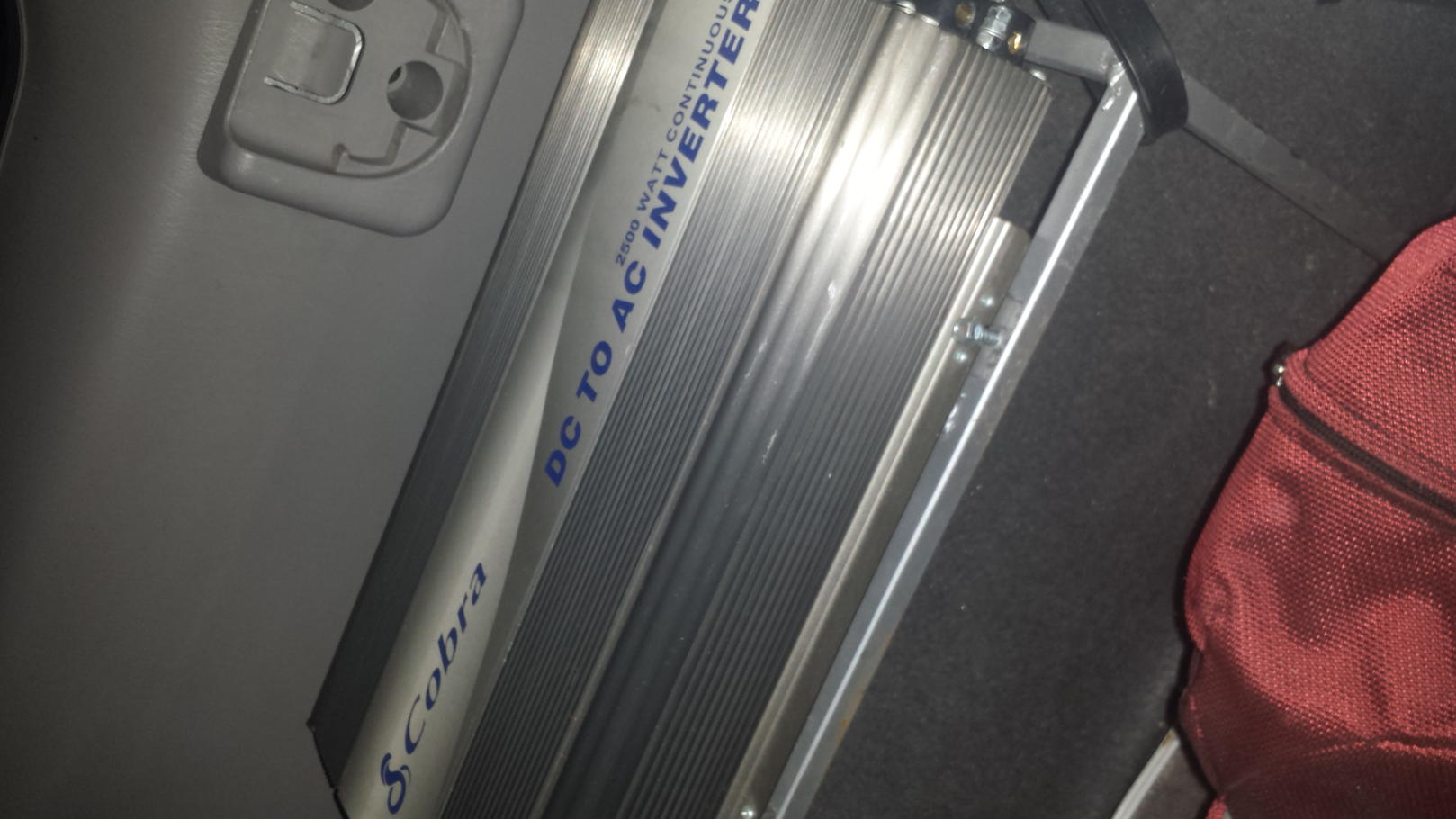

what about a 2500 watt?
Works for me. I plug a vacuum into it rather than running a extension cord from my porch. Also used it for an electric griddle. Obviously keep my car running though.
