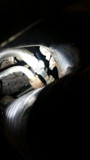

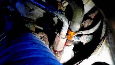

Documenting this in the event that others have the same issue.
Walked outside a few mornings ago and discovered signs of a large leak under the front drivers side. Opened the hood and saw my power steering reservoir was empty. I refilled with appropriate ATF and tried to see where the leak was at. Due to some recent fun at the Rebelle Rally, everything underneath was covered in a mixture of power steering fluid and sand making it impossible to see the origin. Yesterday I finally had the chance to drop the skid plate and power wash the underneath to get a good look.
After cleaning the area with brake cleaner, and turning the wheel a few times, I have an obvious leak at the connection between the lower return hose (low pressure) and the power steering link assembly. I also have some pretty nasty corrosion on the high pressure hose.

Picture 1 Before the engine was on, Picture 2 with engine on and after wheel had been turned a few times.

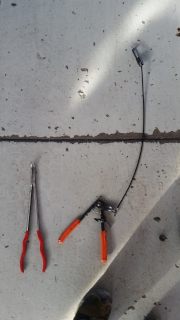

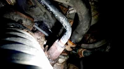

UPDATE: I have been traveling an insane amount since posting this and finally got around to fixing it yesterday. Between the first post and yesterday, I had it checked out at the dealership to confirm the issue and also confirm a rear main seal leak (another story). The dealer diagnosed the issue as a leaking power steering rack and pinion and offered to fix it for the low low price of...wait for it...$2325.
Since the leak appeared to be at the upper portion of the hose near the clamp, rather than at the box, I decided to try to remove the hose, cut off the bottom inch and then re-attach it. Nothing to lose right?
Using these two tools (see image), I removed the clamp and then the hose. After examining the hose, it seemed intact but had hardened at the ends(age?).
My guess is that the stock spring clamp no longer had the force to effectively seal the hose. I replaced the hose with a fresh hose clamp and use a ratchet to tighten it up. Yesterday I drove for several hours on it with no leakage detected. This morning after a cold night, I checked again and there were no signs of a leak. If it does fail, I will update the issue here, but for now this is a great short term fix.

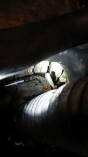

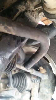

Fixed the power steering fluid leaks
Hi all,
I was able to fixed all 3 power steering fluid leaks today, I replaced all the rubber hoses and clamps with the new ones bought from Napa. Got 3 feet of the return hoses for the P.S wheel, I did not know there are differences between fuel line hose and heater hose, P.S wheel hose and etc... so make sure you are getting the correct hose for different application. Hoses, clamps, p.s wheel fluid come out about $25 plus my labor, I just saved $675 from the STEALERSHIP.
I got panicked and went to the STEALER because of the heavy leak from return line from the rack, and was not sure where was the fluid come from. The nice thing about it they did not charge me anything for checking the leaks. They quoted me almost $700 for parts and labor to fix the leaks (check out my post on top for the parts that they recommended).
The hardest part is to replace the rubber hose from the rack, I have to come from the bottom to be able to reach it and could not find anyway to take the picture of it to show your guys. The 2 rubber hoses in the front bumper are easy to get to, check out my uploaded pictures.
I drove my 4Runner for more than an hour afterward and there is no more leak from all 3 different locations. I am far away from being a mechanic and was able to accomplish this job so I would think anyone should be able do this job. Stay away from the STEALER for this job, they will try to sell us the crapp that we don't need, I understand that everyone needs to make a living but don't put everything on me or sell me the crapp that I don't need. Send me an IM if you have any questions about this job.
