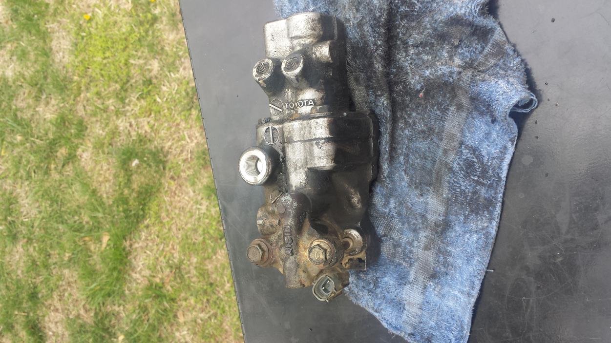

So while changine my PS pump this part got broken, and of course its a unicorn, impossible to find. can anyone with a 2nd gen v6 tell me if they have this part on their truck? it is under the power steering pump, the main pressure hose runs to it along with two transmission lines from the transmission cooler. I cant find anything about it online and im not anxious to go to the stealership! any help is much appreciated!

I'm not too sure what its called but it has to do with the abs braking system, it uses the power steering to provive extra pressure when the brakes lock up. I can give you more information tonight when I can look an my repair book. Look a the lines closer they do not tie into the transmission but rather they are brake lines.

It is called the abs actuator, the one you (and I) have is for vehicles equipped with two wheel abs system, the rear axle only. How is it broken/ how do you know its broken, looks fine by the pic you posted.
Just went thur a leaking abs acturator. Junk yard time or find a used one. I could not find new or rebuild kit.
I cross threaded a banjo bolt. Oops. I ended up bypassing it, which seems to be working pretty well haha. I couldn't find anything about it. Even from toyota.
