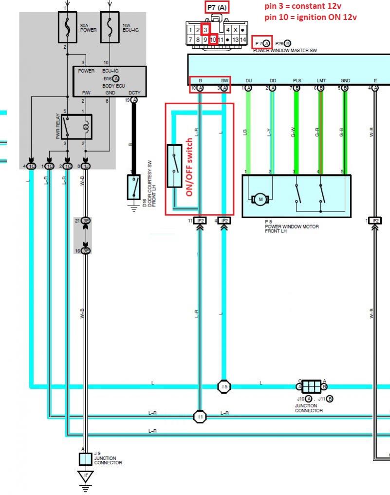

Hi guys,
Been reading this tread and I think I came up with an idea.
The easiest way to do it is to put an ON/OFF switch next to the power window master switch (controls on the driver's door). It should be a regular switch that allows current to go from one wire to another like a bridge.
This bridging allows to bypass the relay in the diagram that is switched ON when you insert the key in the ON position, that gives power to the whole system.
You could technically just bridge both wires together without a switch, but I am not sure if there is a significant current draw, because of maybe another device being spliced at the hexagonal splice points on the diagram.
My opinion is that there probably isnt, but just to inform you guys to check with a multi meter for AMP draw, so you don't find the battery drained.
Here is the diagram:
366078d1595408093-power-window-modification-power-window-master-switch-power-without-ignition-key-jpg
First check for 12v on PIN 3 (blue wire) of the master switch plug pictured in the diagram with the ignition switch in the OFF position.
Then, check that there is no 12V on PIN 10 (blue/red wire) on the same plug, when ignition switch is in the OFF position, and that there is 12v when the ignition switch is in the ON position.
If that so, the you can proceed with connecting an ON/OFF switch to connect those two wires.
You can drill a hole in the master switch bezel and install the switch there, just make sure that the switch can handle more than 30 amps, as that is the current rating of the fuse in that system. Otherwise in case of a short, the switch may become the fuse and burn out.
Should I add a disclaimer - compare that the diagram wire coloring IS the same as that on the 4Runner and use minimum same wire gauge as the two wires, and, of course, do at your own risk! :D

[MENTION=111373]pavelvoivoda[/MENTION]
That is a great recommendation, Pavel. The wires from that plug should be pretty easy to get to, certainly way easier than the relay or fuse.
I am worried about the switch power rating. I suppose if I remember to only run one window at a time this would reduce the amperage but that's not a robust solution.

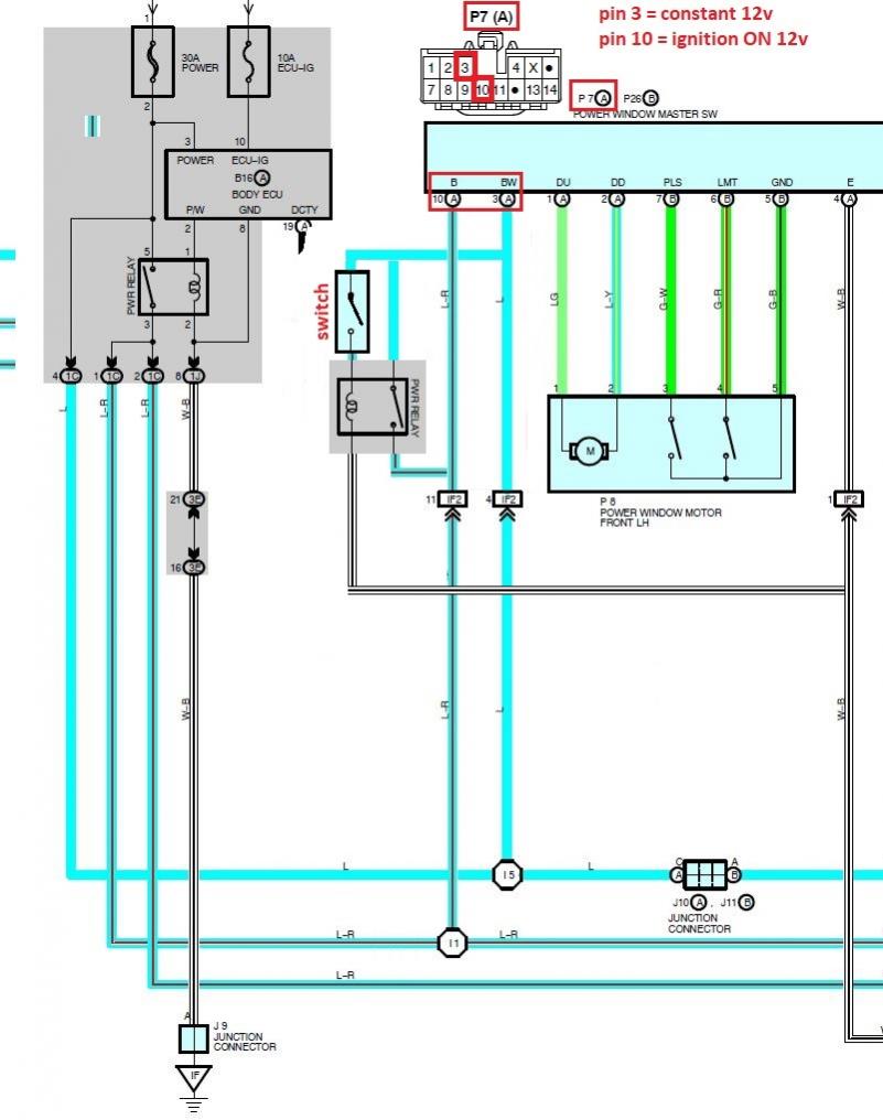

Perhaps the switch could engage a separate relay that serves to make the 10-3 bridge you are proposing?

If you want to put a relay in the door, here is a edited diagram of the same thing with a relay. It is all doable right there at the door controls bezel

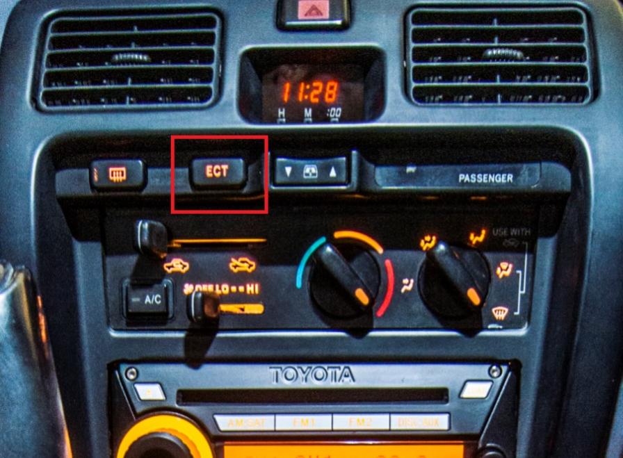

Since I drive a manual, I found the center dash board switches above the ac/heater controls in a junkyard and replaced the original and used the ECT button to make the same type of switch but it turns on all the accessories, without the key in the ignition. It's nice to turn on the radio or charge something for a few minutes, but it will drain the battery if forgotten.

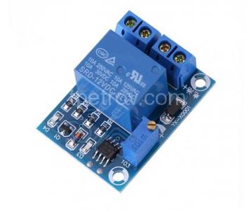

I suggest if you want to prevent battery depletion from forgetting manual override switches like these ones ON, use a small circuit board that breaks the circuit once the voltage drops below a preset one, that you can set yourself with a small potentiometer on the board. They are available on ebay and are a few bucks and they themselves use very little current, like an alarm LED.
https://www.ebay.com/sch/i.html?_from=R40&_trksid=m570.l1313&_nkw=12v+voltage+cutoff&_sacat=0
