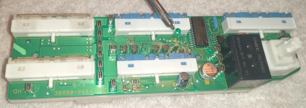

There is a light on front drivers side door switch toggle. I have a 2003 4runner v6 SR5. The light is only on the drivers window toggle. These lights go out FAR sooner than any other light in the dash, including the famous climate control lights that go out. The window toggle lights are not replaceable and most aftermarket toggles do not have lights in them at all. Only OEM toggles will have a light for the drivers window switch ONLY. The other toggles don't light up. They just have a white stripe or something on them. Open up your power door switch assembly and you'll see a green looking light bulb that's soldered in place. You can in theory replace it if you find the correct led or incandescent light at Microcenter or some other computer store. I imagine its probably 1.5 volts or something really low and you can solder it back in place after carefully clipping the other bulb out, leaving the stems. Which side is + and - is a mystery and if you get it wrong it wont light up or itll burn out so you might want to buy a few.
