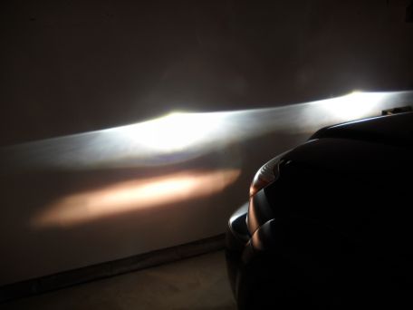

I'm with zstampe on this, go with the HID's. I paid a little more and got the Xenon Depot 4300k's because they were plug and play and were a very easy install. I put them in yesterday and I'm very happy with the results. As mentioned before, they work very well in the projector headlight.
The jury's still out on this one for me because I think the factory lights are pretty good. Did you upgrade your low beams, high beams, and fog lights?
Oh and the DDMtuning kit was plug and play and also came with a one year warranty.
One year? It's been a little while, but back when I was looking at them the DDM kits carried a lifetime warranty (and at an awesome price).
There are 2 different kits, one with a lifetime and one with a one year warranty. I went with the one year warranty kit, at the price of silverstars if the kit lasts only a year i'll be happy, i was replacing those crappy bulbs every couple of months.
I just upgraded the low beams. I already had Silverstars in the fog and high beams, so I didn't spend the extra to do the fogs. I'm sure I'll eventually upgrade the fogs, but there are some other mods I'd like to do first. I'm looking into adding LED's on the interior, tranny cooler (since I have a V6 and tow my boat all summer), and maybe a color-keyed Limited style grill instead of the chrome one.
you could change out the h11 for h9 bulbs, use hirs for the highs, do the footwell mod, get leds for the domes
Did you notice a big difference between the Silverstars and the HIDs?
I can definitely tell a difference in the light that the HID's put out compared to the Silverstars. I didn't have an exact apples to apples comparison because I have the silverstars in my fogs and high beams and up until I switched the low beams to HID's, they were just stock. I'll try to snap a pic tonight of the HID's with the Silverstar fog lights so you can see.
I was able to snap a pic tonight in my garage of the HID low beams with my Silverstar fogs to show the difference in the light output. It's a huge difference if you ask me. And to think, I used to think the Silverstars had a white color to them.
