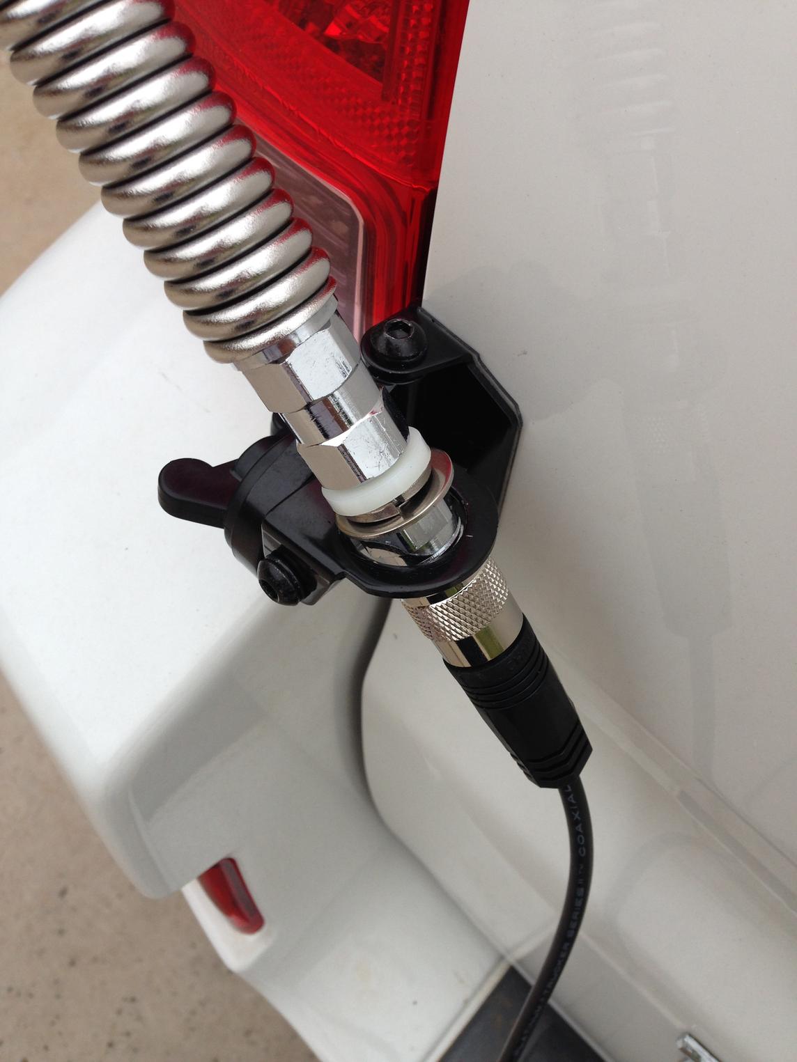

Coaxial cable and firestix adapter
I was wondering if anyone could help me figure out what type of adapter I need. I am running the exact same setup, firestik II, coaxial cable with p1-259 adapters and the Comet RS-720 mount.
I guess I didn't read this thread close enough because I soon realized I had no way to connect the coaxial cable to the antenna. I would just go to a truck stop or a place that carries stuff for cb radios however I don't live in an area that they are very common. I was hoping someone could point me in the direction as to the adapter I need to purchase. I found this on amazon but I don't think it will work since the rs-720 adapter has a 5/8" hole and the adapter is for 1/2"?

Did you end up getting that? I am installing a CB and I'm also stuck on that.
This is possible the most frustrating thing I have ever done.
So I'm assuming the K-4A did not work judging by the picture. Is that the heavy spring or medium?
Edit: Do you think you may have accidentally purchased the RS-720NMO w/ a 3/4" diameter hole rather than the RS-720 w/ a 5/8" hole?

Did anyone find a solution to this? I ordered the rs-720 and it appears that I will be having this same issue when it arrives. Would it be possible to tighten the stud down on washers that are sandwiching the 3/4" hole in the mount? And did anyone ever come to a definite conclusion regarding whether or not the mount needed to be grounded in order to achieve a fair signal?
If you are having issues, give American Radio Supply a try. They were the ones that sorted out my mess of mounts and shipped me one with a 5/8th" diameter.
I tried sandwiching the stud to the 3/4th" with washers and that didn't work for me.
I am pretty sure that the mount has a fair ground because the metal makes contact with the body.
I got the 5/8 hold comet mount and mounted my antenna with a k4a firestik stud and I have had no problems. Theantennafarm guy tried to tell me it wouldn't work and I needed to buy another setup that was 3 times the price
