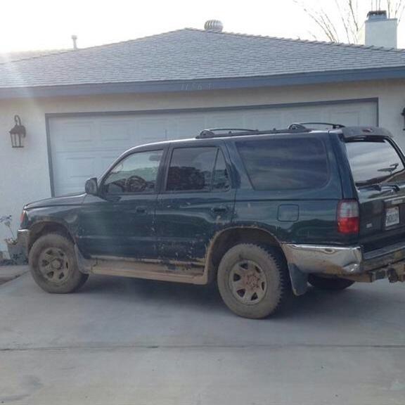

This is the only picture I have at the moment. (not sure if I added it right, hopefully it will show up)
