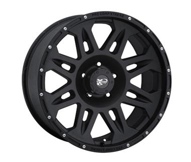

Can anyone confirm if the following wheel works on A 4th generation 4runner
and will they clear Upper Control arms with a 285/70r17 or will spider trax spacers be needed in addition? I have searched and found a couple 3Rd generations running them. Does anyonyone have these?
They look awesome:
Pro Comp Alloy Wheels Series 7005 - Cast-Blast
17X8 6 on 5.5 Bolt Pattern
Offset = 0mm
Backspace = 4.5 in.
Max Load = 2200lbs
Finish = Flat Black
Hub Centric = Yes
or
17x9, 6 on 5.5 Bolt Pattern
Backspace = 4.75 in.
Offset = -6mm
Max Load = 2200lbs
Finish = Flat Black
Hub Centric = Yes

I have the 17x8 with 265/70's, they fit! Slight rubbing on the mud flaps, but not a big deal! The 4.5" backspace brings the wheel just outside of the flares! I'm not running wheels spacers either!

I used this wheel offset calculator to determine that a 17x8 wheel with 0mm offset like yours is pushed out 1.5 inches from stock:
Wheel Offset Calculator
This seems similar to those who are running wheel spacers and stock rims. Your pictures look great and the wheels seem to fill out the fenders without sticking out. There's a wheel that I like only available in 17x8.5 with 0mm offset, but I'm reluctant to get it because the calculator indicates that it would stick out an extra 1/2 inch beyond your setup. If your tires already rub the mudflap, that 8.5 might not be a good idea. Did you move the fender liner? Did you trim the mudflap at all? Your lift is equivalent to a 3/2, ya? Does it rub under street conditions or only when flexing offroad?
I don't want to start a huge debate, but I've read both sides as far as hub-centric vs non. There doesn't seem to be consensus on this topic. Why did you personally avoid hub-centric?
No I didn't need move the fender liner, jus trim the inside of the mud flap! The wheels rubbed on flat street driving when turning at full lock, other than that the wheels fit great no issues. The pro comps do stick out probly 3/4-1".
As for hub centric vs non hub centric, the pro comp hub centric wheels are made to fit a GM hub which is quite a bit smaller than the Toyota hub. Plus pro comp said they will not fit and the non hub centric are the correct wheels for the 4r.
