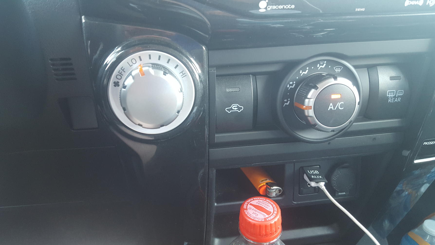

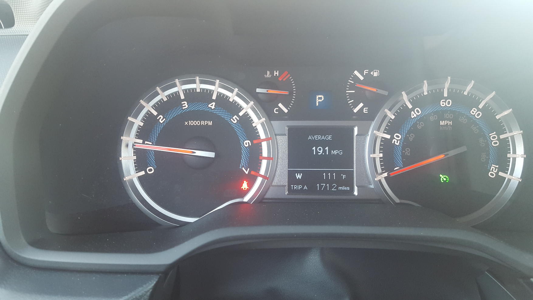

Today coming back from SoCal going through Baker. The 4runner said it was 111, the world's biggest thermometer said it was 113, and a.c. fan was set one notch above low and I was quite comfortable. For the ones who are having trouble cooling your runner down, I think you need to have your ac's serviced.
