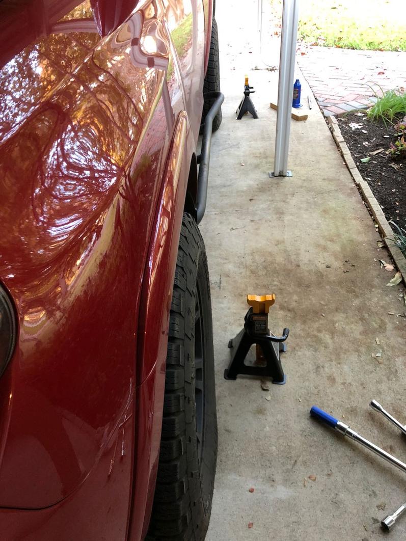

I like mine a lot but will re-assess after my new suspension and SSO bumper setup goes on. The rubbing with the Terra Grapplers was a little more than I thought. Just pulled my mud flaps and cut back the fender for now. I stuck to the torque procedure and checked it after a hundred miles or so and everything was fine.

I bought a used set for $125. After lifting my truck with Bilstein 5100 I didn't rub. After I added spacers I started rubbing.
I have BFG 265
After a little trimming I'm no longer rub at full turn. Perhaps with 275's or 285's I will need to trim away some more plastic.
