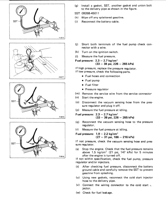

The motor cutting-out issue is still persisting. I installed my LC Engineering 22RE fuel pressure gauge (cheaply made, not great quality for being ~$60) and here were the pressure results:
  • Motor idling cold: 26 psi
  • Motor idling warmed up: 24 psi
  • Motor without fuel pressure regulator vacuum line: 35 psi
  • Motor off: 0 psi (pressure decreases quickly from 24 psi; 20 seconds(ish) to 0 psi)
FSM / Manual SPEC
  • Idle: 27 - 31 psi
  • w/out Vacuum Hose (pressure regulator): 33 - 38 psi
  • Motor Off: > 21 psi for 5 minutes (after power off)
Sooo... it looks like my fuel pressure is just a hair below spec, but definitely not maintaining pressure after power off. The FSM also states:
"Stop the engine. Check that the fuel pressure remains above 21 psi for 5 minutes after the engine is turned off
If not within specification, check the fuel pump, pressure regulator and/or injectors

Fuel Pressure Spec (sorry mods, if you don't allow FSM data to be posted here-- then please remove)
It looks to me like the Fuel Pressure Regulator keeps the fuel from going back to the tank. I'm looking at my 1987 FSM, so I don't know if there are differences. That may explain the sudden drop after shutdown, but I don't know if that would cause the cut out. Unless your FPR is just shot. Glad you got the starting issue solved.
