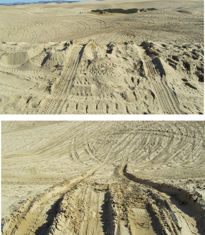

I think that's normal. What it's doing is limiting you to 4th gear and it won't go into overdrive - 5th. When you start up it will go through 1 to 4. If you pull it back a two times to 2, then it will start in 1, upshift to 2 and stay in 2. I used that last week at some sand dunes to have it not go above 2 or 3. This was handy when in 4 low.
