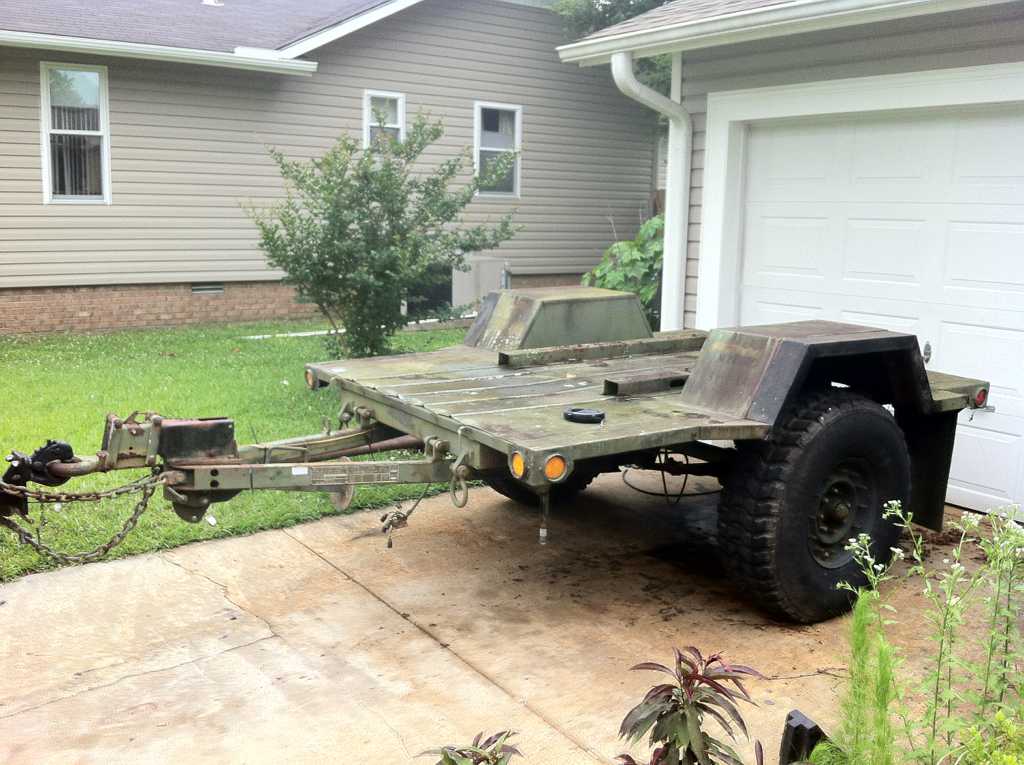

Ah So he actually builds them nice... These I found going for $800 and the guy keeps stock of them I'm pretty sure he get them from Bragg and Mackall in NC. There spec are out of this world as can tell. I think it would make a great platform to start from.
The only issue I see with those is they look like they weigh a million pounds. Even with my manual tranny I can't imagine trying to pull that monster.

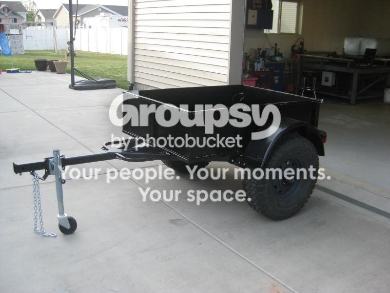

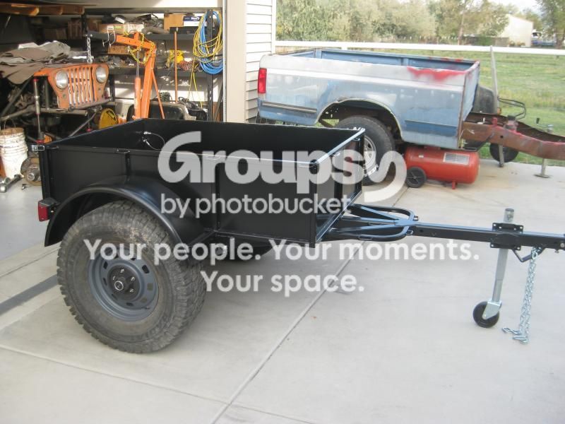

I'm building one like this. Simple and light weight.
IMG_3471_zps07e262a3.jpg~original
IMG_3472_zpsc83876e9.jpg~original
Ditto. Pulling one of those M1101 or M1102 trailers off road safely would require a lot more truck than a 3rd gen. They weigh 1460 lbs empty. They are also almost 2' wider than a 3rd gen, and if the trails in Tennessee are anything like they are here in southwest Missouri (which I assume they are), there is no way you'll get a trailer that wide down forest service roads (I have to pull my mirrors in on some trails).
As thardy says, simple, light, and small are the way to go. Having pulled my trailer loaded, I'd say anything over about 1200 lbs loaded would be a real challenge off road for a 3rd gen.

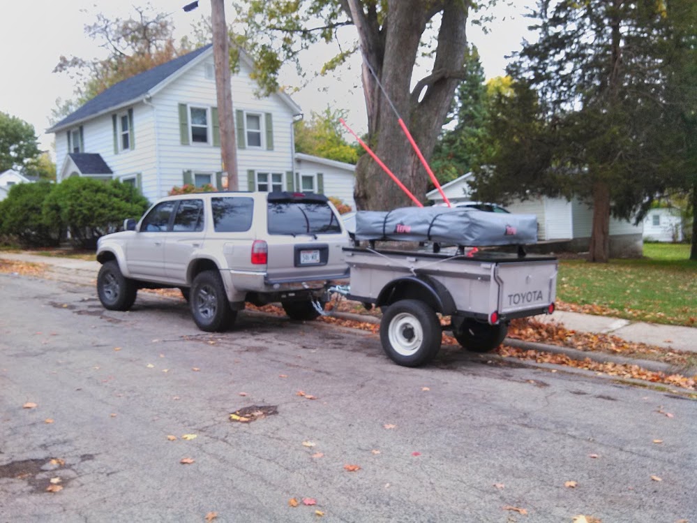

DSC_1627_zps625c3364.jpg~original
DSC_1138_zpsb7f1a4b0.jpg~original

Yea 1400 lb is a bit much and a little over kill. Trails in TN are pretty rough in places def steep tons of large rocks
Those M1101s are heavy.

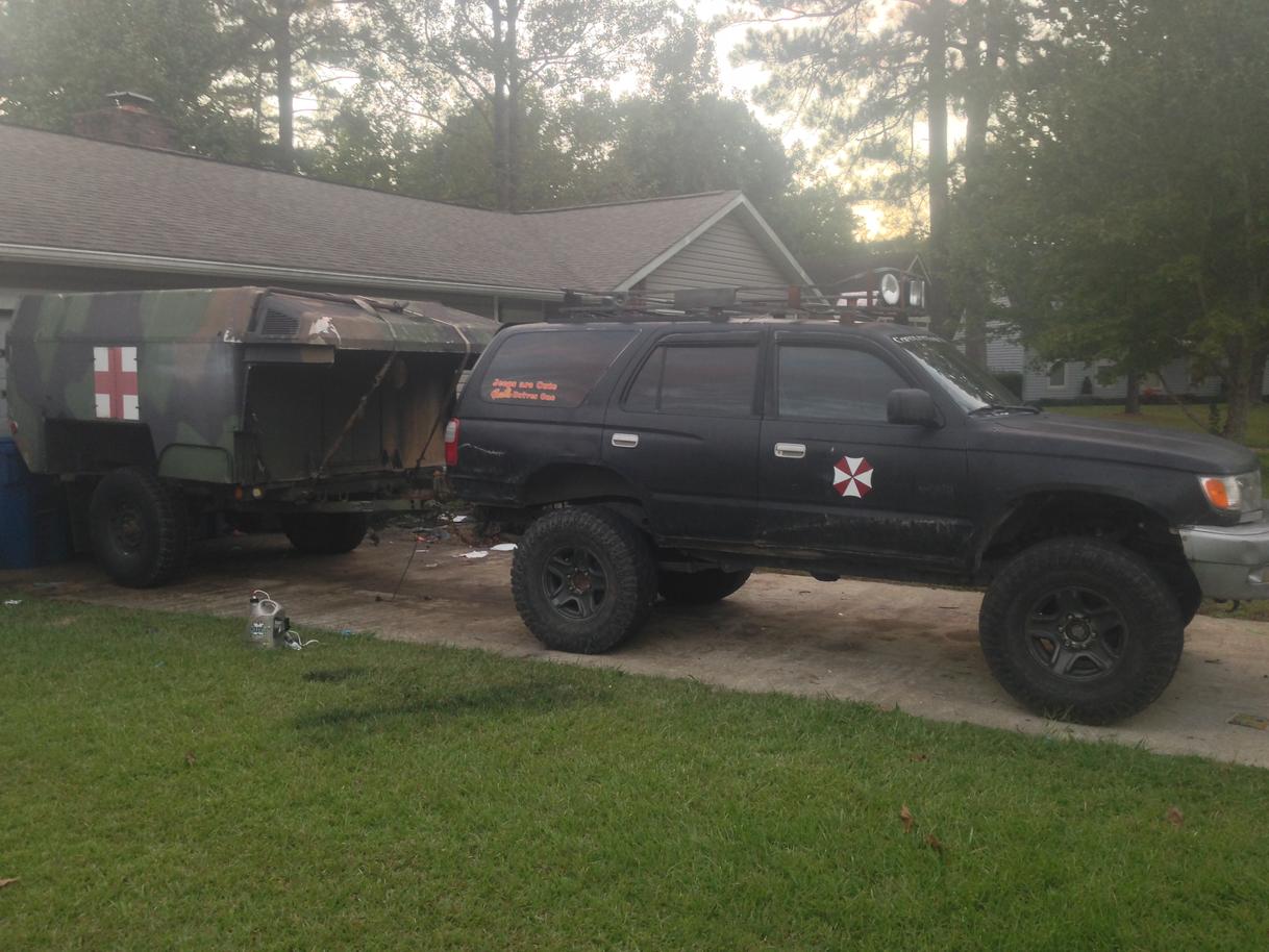

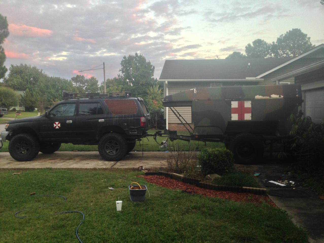

I'm building one out of a M116A2 Genny Trailer and a M996 Ambulance body.
[MENTION=110088]SilverRidgeRunner1[/MENTION]
Here ya go.

I don't think they weigh that much. In fact I'm sure of it. 1400 is the weight of the trailer with all issued road gear which includes rarp, sides, chocks, and leveling legs (for keeping a load while the trailer is unhitched. That stuff weighs about 200-300lbs. Even with that stuff in there I can lift and drag that trailer by myself. A bare trailer is really easy.
Plus you can skim another couple hundred off that carcass if you go about it carefullly. The rims and tires weigh around 150 apiece plus a spring pack that can be slimmed down as those are 1 1/4 ton payload trailers. You could reconstruct those spring packs and drop another 50 - 75 lbs off the trailer. The body itself is quite light.
It is quite a bit wider than the 4runner so there isn't any denying that. I would recommend that trailer for a camper type build but not something you drag up the trail behind you.
They are incredibly stable offroad and pretty comfy to sleep in as is. With some creativity you could have quite a trailer. I have 11 or so years of messing around with these things.

I'd say your right with some effort u could make something super neat out of one. The price is right cause u couldn't buy something this built from tractor supply, I was looking at some of their trailers today and well for the same price u couldn't match the M1101.

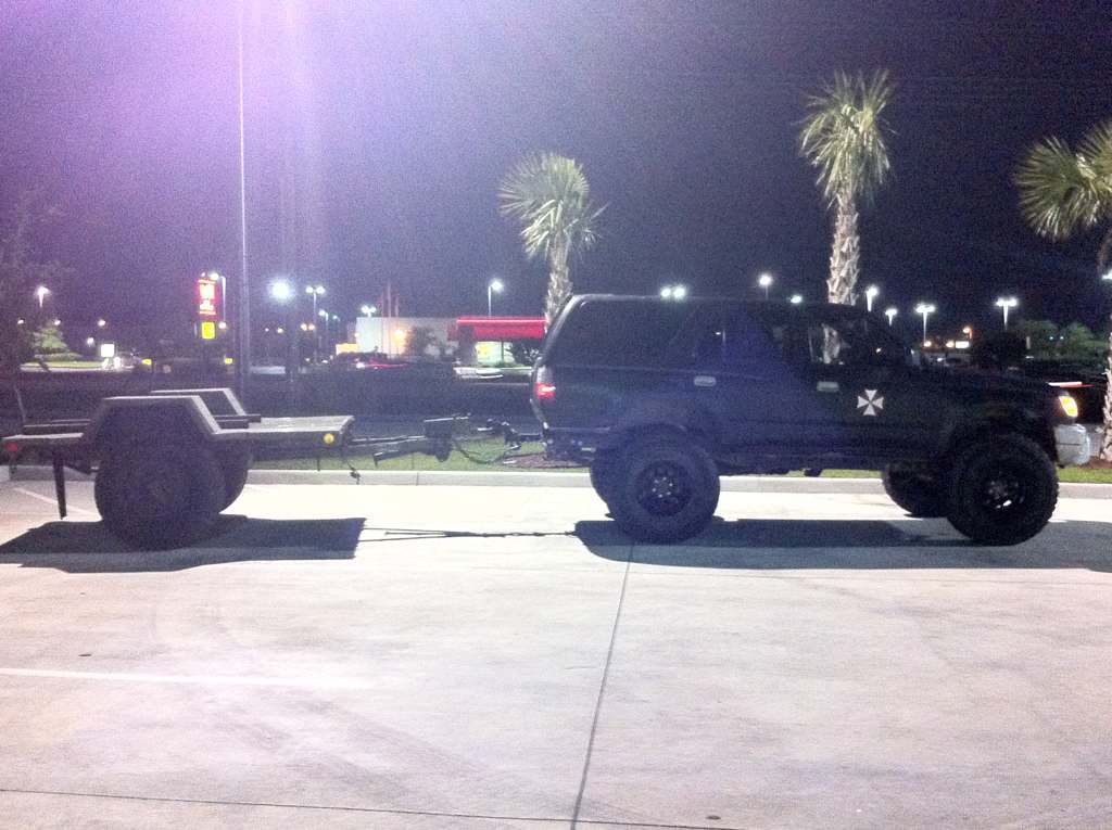

This is the best idea I've got from what I am wanting to create... Plus my pride was skull f%^& when my friends CO let me hitch one up empty cause we happen to be near a hanger that housed one, and I have to say it SQUATTED my rear a little more than I'd like, so some weigh would have to be trimmed. I measured 2'ft on both side to wide for the 3rd gen so back to the drawing board.
