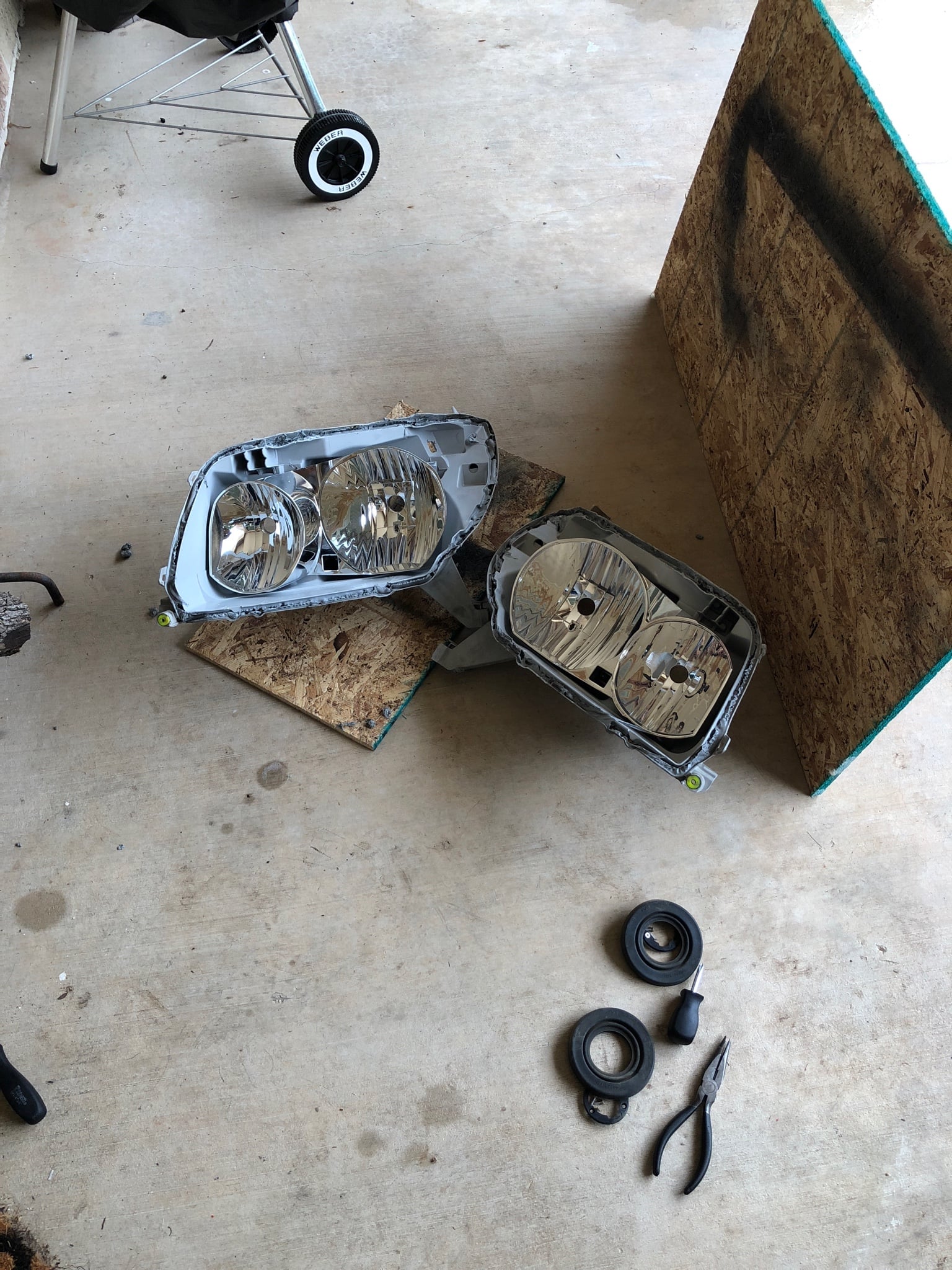

Just showing you little glimpses of my retrofit I’m doing today

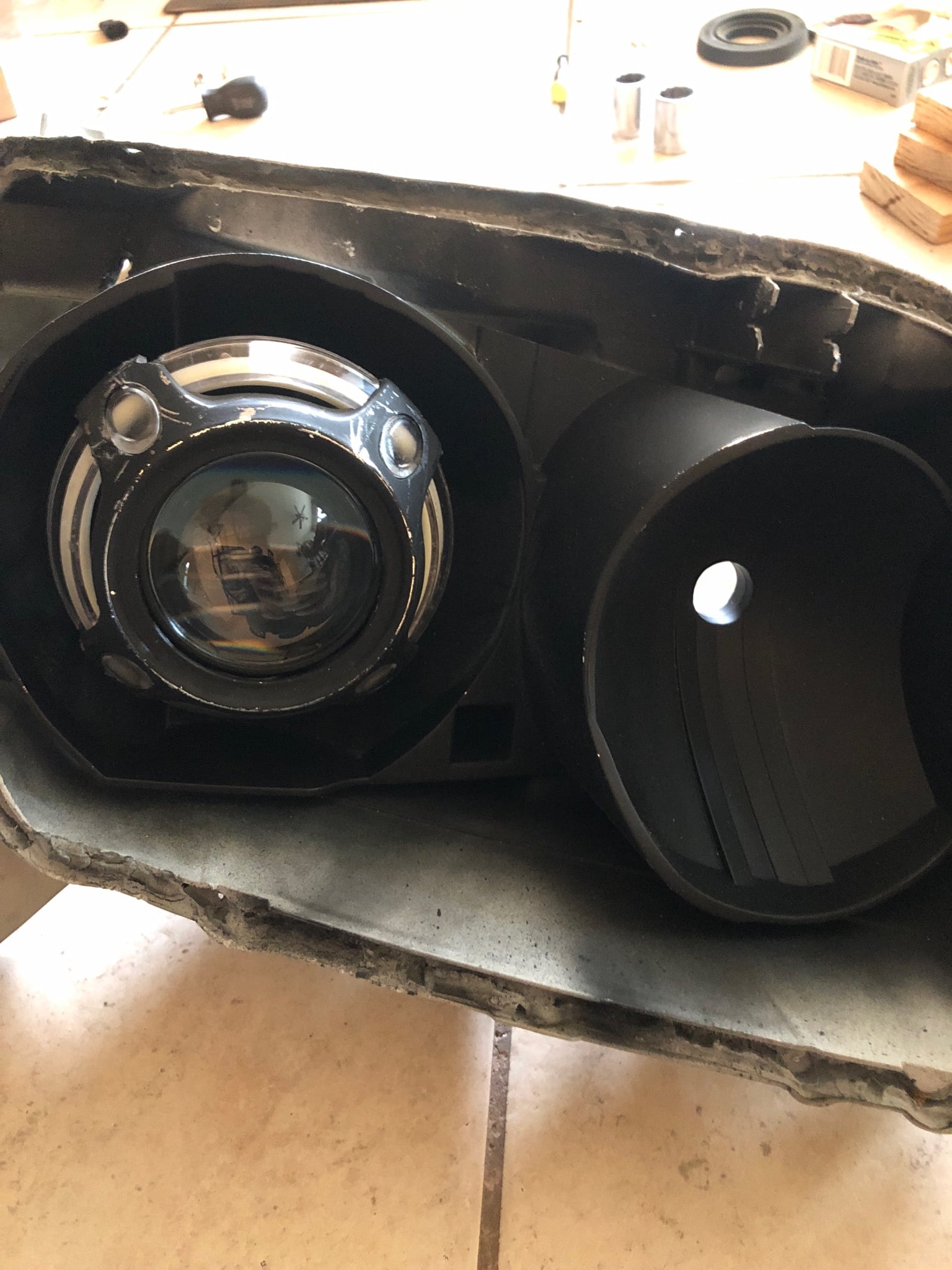

Finally got the projectors in after fussing with them and trimming some stuff up for a little while.

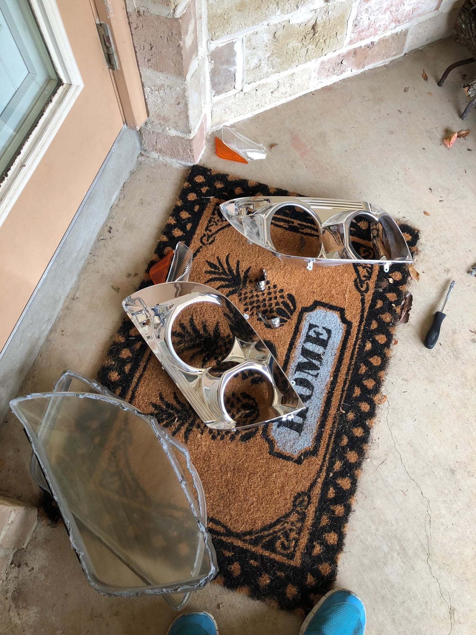

Decided to paint the shrouds black and then scuff them up a little for a different look

Turned it to be a few day project for me since I ran out of daylight and didn’t mount the shrouds correctly. But ultimately I’m SUPER happy with the results. Aimed them perfectly and love the rainbow effect in the cut off. Such a huge improvement with the HID bulbs. I went with 6000K to match my leds on the truck as well.
First picture was before I cleaned the headlights with a restoration kit. Makes a world of difference in clarity. And the second pic has a bunch of reflections. But I promise I’ll get better ones at night. Just wanted to upload something.

One pack of Butyl Rubber was enough for both headlights?
It was. In fact, I still have more leftover. That stuff binds really easily to these headlights. So just one strip through the grooves of the headlights and I was good. No condensation or anything since. It’s been about 2 weeks
