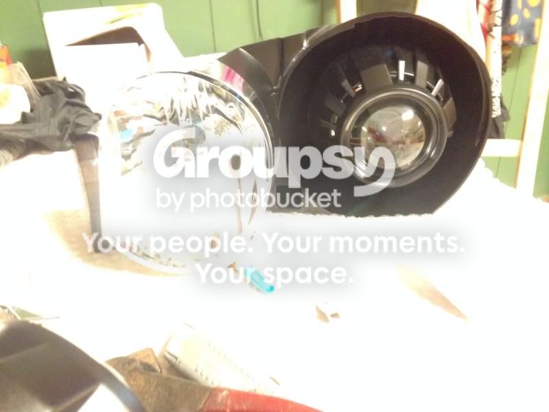

Me and [MENTION=50591]gaterose[/MENTION] completed my projector retrofit yesterday and it came out great. If you have an 03-05 and dont want to do a face lift but want projectors, this is definitely the way to go. The Retrofit Source has some great products and great customer service.
Specs:
Morimoto Mini H1 6.0 projector
Morimoto 3Five 6000k bulbs
Gatlin Gun 2.0 Shrouds
Here some pictures

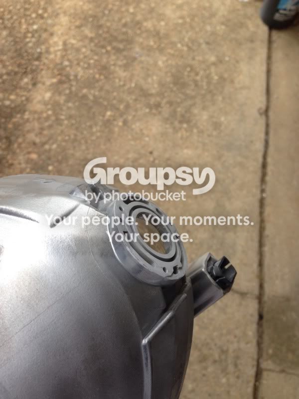

After we baked them apart we had to trim the back of the headlight housing down so that there was enough room to screw the projector in
Better view of the shroud and projector
Final product

Glad I could help Adam! Final product looks awesome. Just wait till your driving down a country road at night now, they are so bright! More pics of the cut-off at night when you get a chance.
with a lil more work, you could of fit fxr or an oem tl, s2k, rx, ls430 ls 460, with those projectors you can use oem d2s bulbs. which give you some of the best output.anyway show some output pic.
Yet again, I saw your name.. and yet again you're telling someone their projectors aren't good enough... do you contribute anything else?
The options you list are all over $200 for projectors alone, and require a LOT (not "a lil") more work to install.
Adam wanted something so he could run HIDs without blinding people and he wanted to do it on a budget. I believe he has under $130 in this setup including bulbs.
And from talking to him last night, he is VERY HAPPY with the output of the mini h1 6.0s, regardless of whether other projectors provide better output or not.

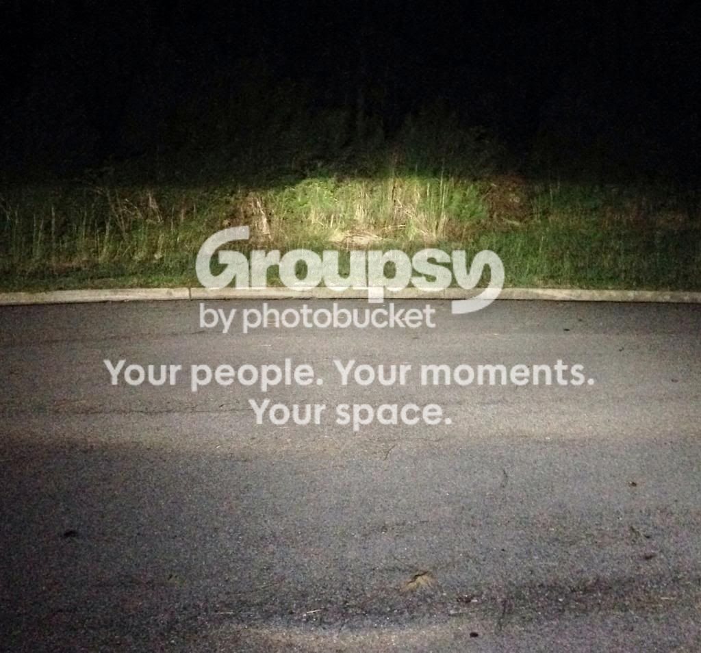

Heres a picture of the output, i was a decent ways away from this so the cut off isnt as sharp but the picture still doesnt do it justice
Ill try to get another one up close to a garage door tomorrow so you can see the cut off better
atleast the cutoff is straight on the first try, most i seen was misalighnment on either side. good job to the 2 of you for doing things right. now let see the upclose 25+ feet of the wall shot, this is the money shot.
