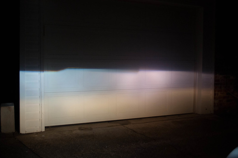

They look pretty white for 6000k. I'm considering 5000k for a hint of blue with more light than 6000k.
As far as i know when you get to 5000k you start to lean towards more yellow, now dont hold me to that cause im not sure about it when you put it in a projector, but with just an HID in a non projector the higher you go the more blue you get after 6000k and 5000k has a pinch of yellow with the white.
I don't think they get yellow until you get down to the mid 4000s. 5000K is supposed to be natural or pure white, while 6000K is cool (blue) white.
You will start to wash out details on the road past 4300K. 4300K should be a true white. with 5000K being a little blue. Keep in mind, the projectors themslves provide color on the cutoff line regardless of the bulb. Your going to get the cool "color flicker" from projectors running any bulb (check my sig - 4300K bulbs and look at the color on the cutoff) so going excessive on the kelvin scale is only going to detriment your output. IMO 4300K and 5000K are the only two choices for a headlight bulb. This just gets the most output out of your projector setup and allows you to see more details on the road.
