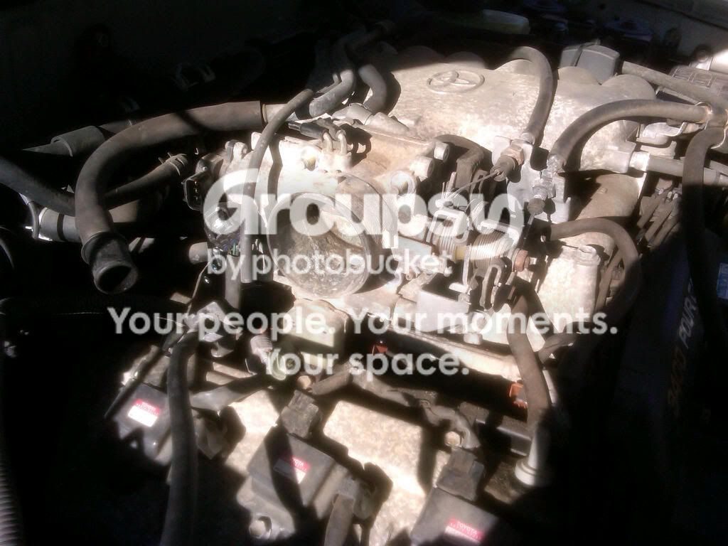

Step Two: Remove the plastic air intake tube. There are three 12mm bolts holding the airbox to the passenger side fenderwell, disconnect all electrical and vacuum lines and remove the unit as one piece. (this is a good time to clean it!)
IMG-20120120-00110.jpg~original

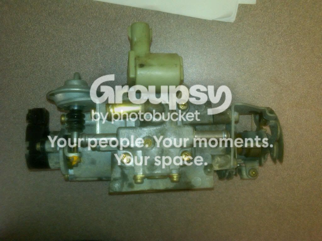

Step Three: Remove the Throttle Body. There are four 12mm bolts holding this to the upper intake manifold. You will also have to disconnect the inlet and outlet coolant lines connected to the IAC under the TB. A wide set of pliers helps to remove the spring retaining clips. There is also a breather hose that will need to come off the IAC (it does not have a clamp). You will also have to unhook the throttle and cruise control cables from the TB rotating assembly. To remove the cables, rotate the butterfly valve, and rotate the cables so that they can be freed from the TB via the notches in the metal. they should just slide right out but if they don't, gently pull them with a set of pliers. try not to scuff up the ends or you'll have trouble putting them back in. The TB assembly slides out towards the passenger side.
*Do not loose or bend the thin metal gasket behind the TB!*

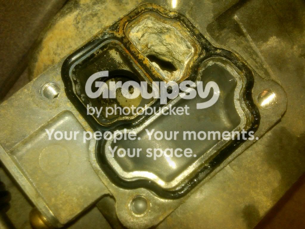

This is what it looks like when its dirty and corroded!
IMG-20120120-00119.jpg~original

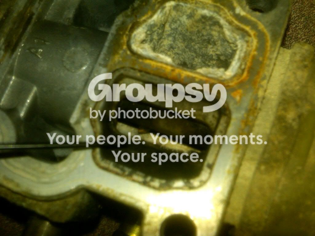

So this is the reason why there was a Check Engine Light. There was some debris stuck in the IAC's rotating assembly, I used a pick and some alcohol to clean it out and allow the rotating assembly to move again. Make sure to Clean or replace the rubber seal before you reassemble everything.
IMG-20120120-00120.jpg~original
To test if your IAC is actually malfunctioning, you can perform a simple test. The electrical connector on the IAC has three pins in it. the one in the middle is ground and the other two are 12V. if you apply power across one side and ground it should rotate in one direction. applying power to the other side and ground should make it rotate in the opposite direction. Replace it if it does not perform this action or if the motor has shorted out (you'll see sparks)!

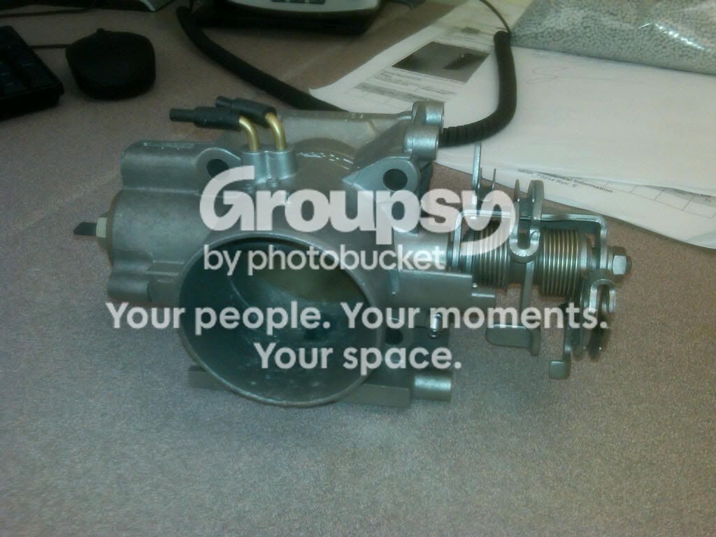

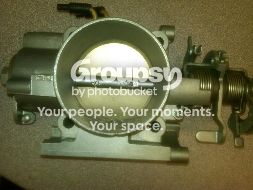

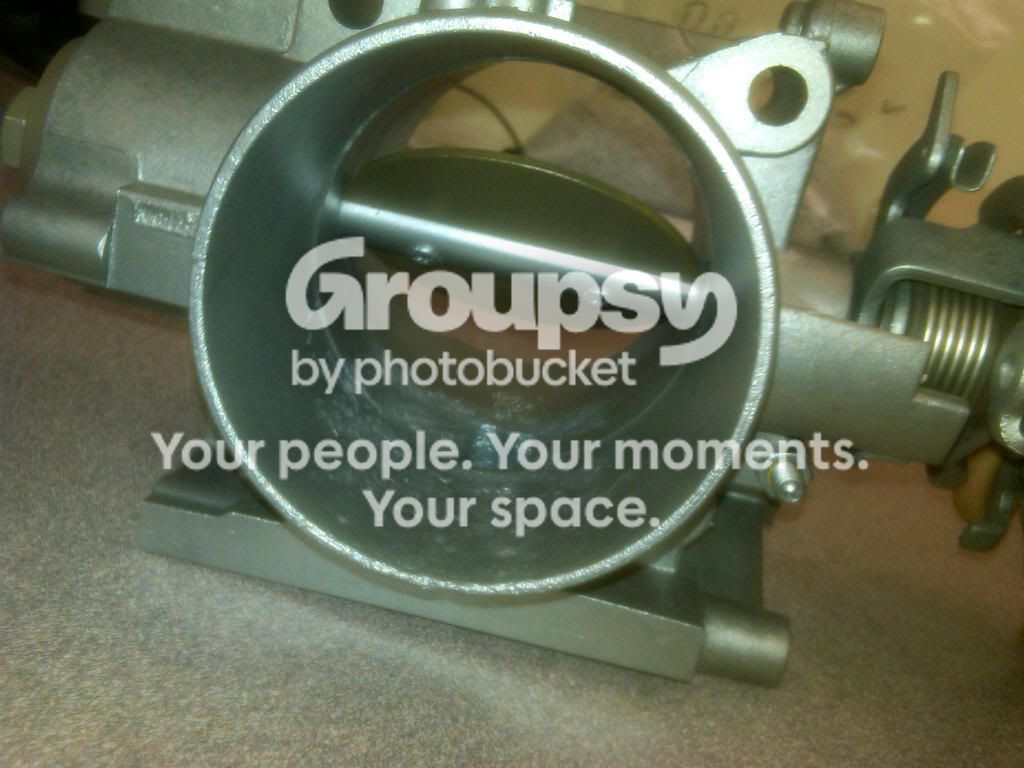

Step Five: clean the throttle body thoroughly. I have access to a sandblaster, so I sandblasted mine on low pressure, now it looks brand new. please keep in mind that some of the parts on the TB are galvy coated steel. if you remove the galvy coating they will rust! Here it is all cleaned. After Sand blasting I did blow out all the little ports and passages with compressed air to make sure there were no grains of sand left to clog anything up.
IMG-20120120-00121.jpg~original
IMG-20120120-00122.jpg~original
IMG-20120120-00123.jpg~original

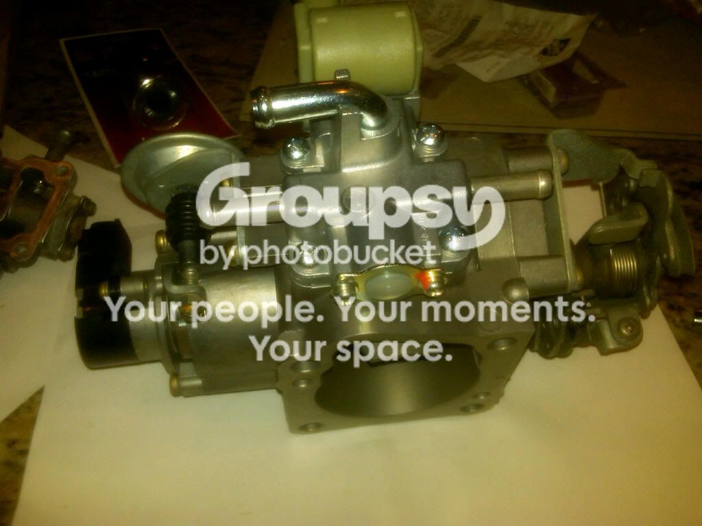

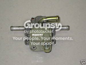

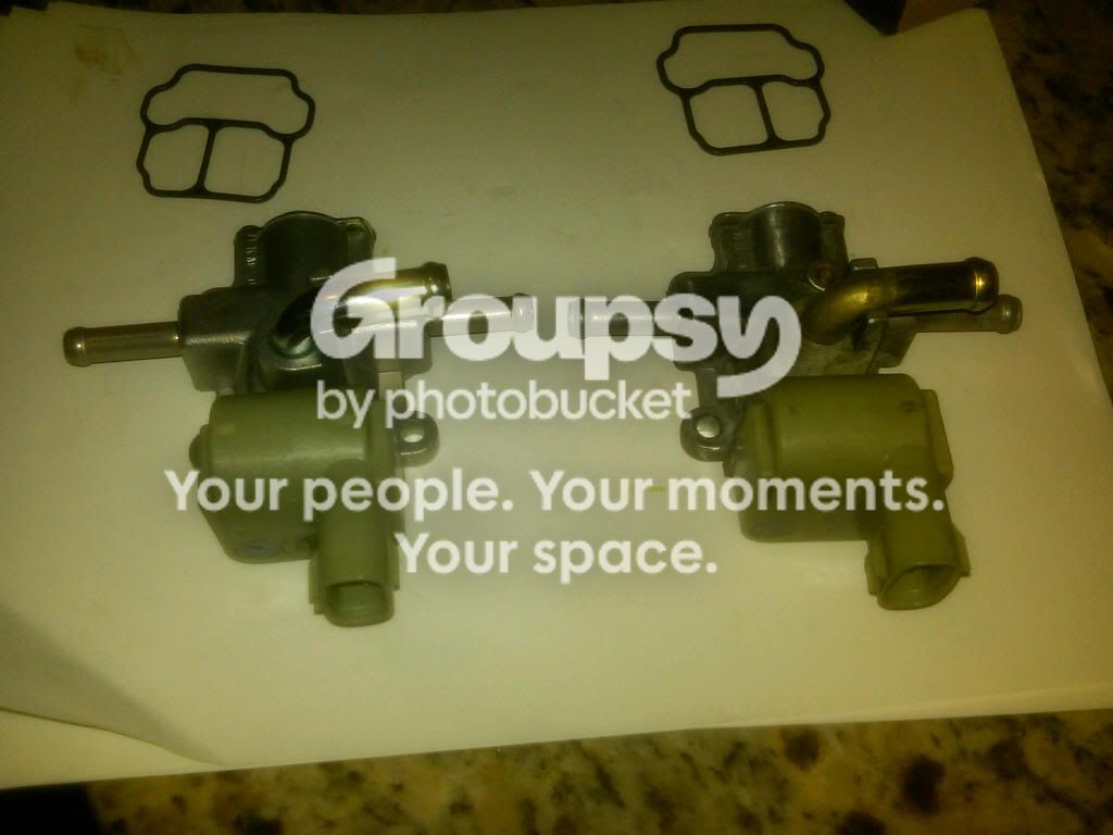

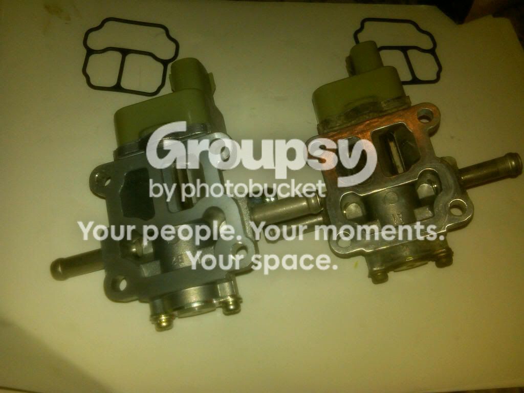

It turns out that my IAC was bad. I tested it as I stated above, only I used a cordless drill battery, It was sparking, so I knew the motor on the IAC had shorted out. A new one can cost $70 on ebay or about $200 at Autozone, $240 at NAPA! I was in a rush so I just bit the Bullet and got one from Autozone.
Here is a pic of the old and new IACs next to each other.
IMG-20120122-00125.jpg~original
IMG-20120122-00126.jpg~original
And Here is the TB assembly all back together again with the new IAC

Nice. I would also have used to compressed air to blow out all the ports and passages in the TB while I had it on the bench--removing those silly dead end rubber tube caps to do it. This is what the FSM says to do. Since you sand blasted it, this is a must IMHO. I am an antique tractor guy first, and tractor guys never sandblast a carb, they bead blast them. TB ports/passages aren't as critical, but I'd sure want to get those little sand grains out of there so they don't go anywhere else.
The FSM also says never to spray anything into the IAC port when cleaning the TB, for just the reason you mention. I have avoided doing that since new, and so far my IAC works fine. (12 years and 140k). I clean the rest of the TB every 30k, including blowing out the ports/passages.
