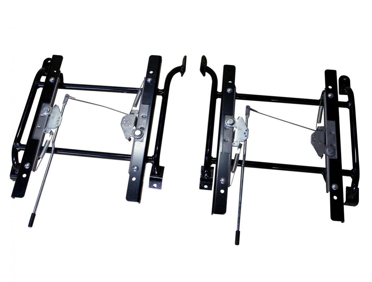

Well i finally got tired of the beat down factory seats and ended up ordering some PRP Enduro Recliner seats and some of their 95-04 Taco seat brackets to modify as needed to fit them into my 4runner.
From reading about people swapping taco seats and 4runner seats back/forth, it seems that there are some differences in at least 1 foot but it should be doable fairly easily.

Any other paths of least resistance to take as opposed to using the PRP brackets? Decided to give this route a go since they appear to be far better built than the other alternatives like Corbeau etc.

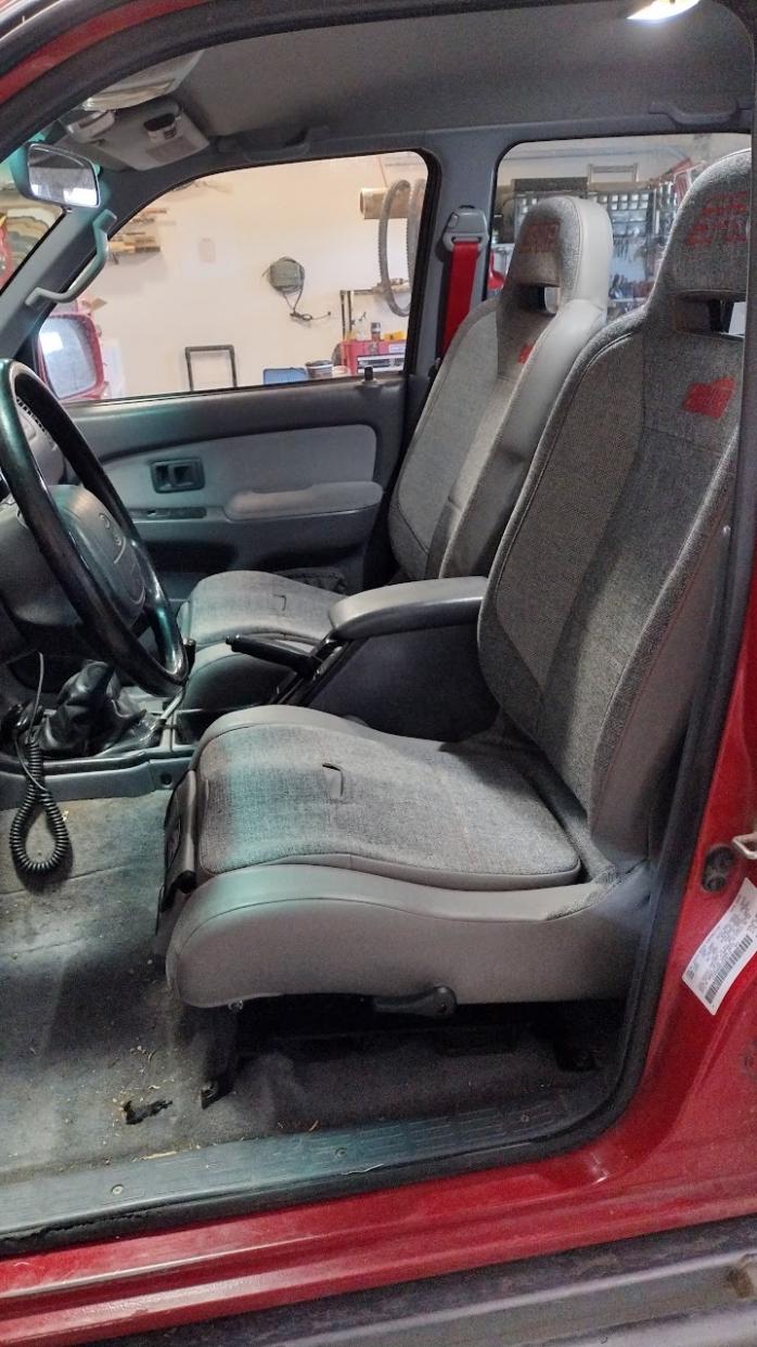

I reworked the OEM seat rails to work with the PRP seats, also removed the OEM seat floor board mounting bracket

Were the oem seat rails you used manual or motorized? Why did you remove floor board mounting bracket?
Manual.
I was already having to rework the floor boards on both the pass and driver side to clearance an Atlas Tcase (driver) and exhaust (pass), to maintain low vehicle ride height while keeping the drive-train and suspension from hanging low. The seats I have require the use of a 5-point harness which require a center mounting point between ones legs (the front support gets in the way of properly creating this point. With all that said I would still have removed this and built my own brackets because that gives u more freed to put the seat where u want it and set the seat height (but I tend to build what I can even if there r available items on the market)..

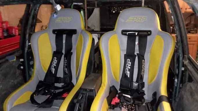

PRP Enduro seats installed
I installed these with corbeau seat brackets, the prp universal angle brackets, and a lot of trips to the hardware store. I found a suggestion online for attaching the belt buckles using a cut down brass bushing that worked out ok. the stock belt buckles needed flattened a bit to fit correctly. One of the captive nuts for the stock seat mount was fatigued and broke free so we welded up a custom captive nut on a plate to weld onto the "seat cross-member". I'm a tall person so i ordered the 2" extra tall option and that is how they fit. seat height is a bit taller than stock. my rig has the extra rear heater and the corbeau brackets just barely clear it.
