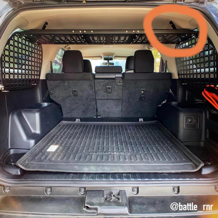

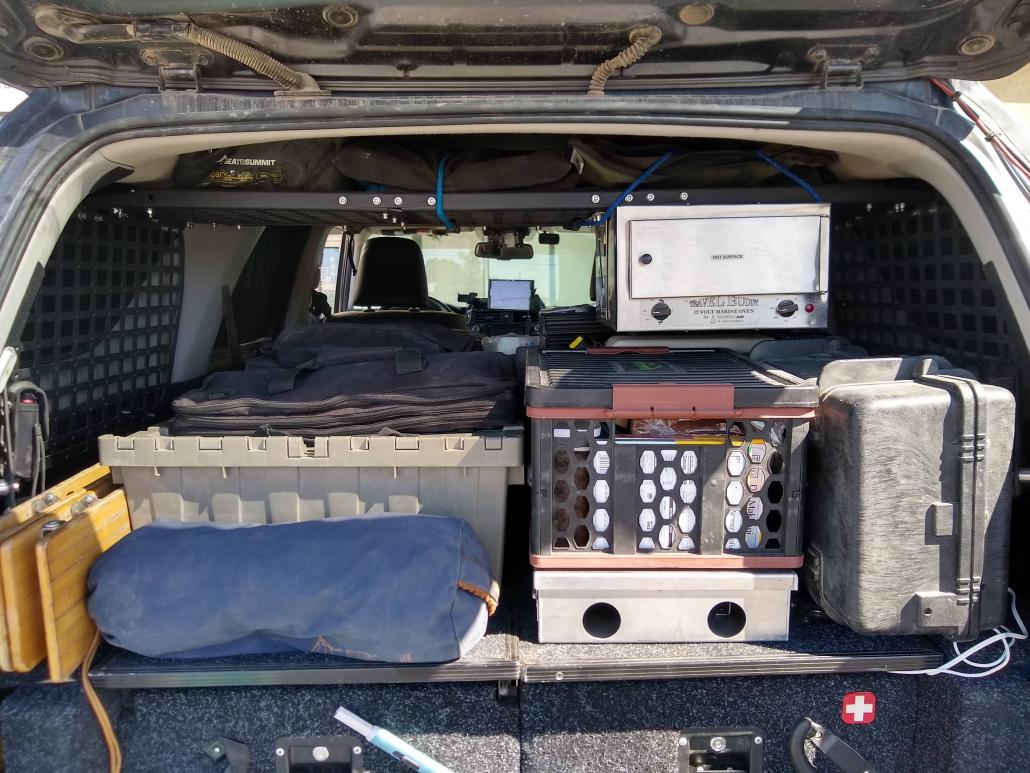

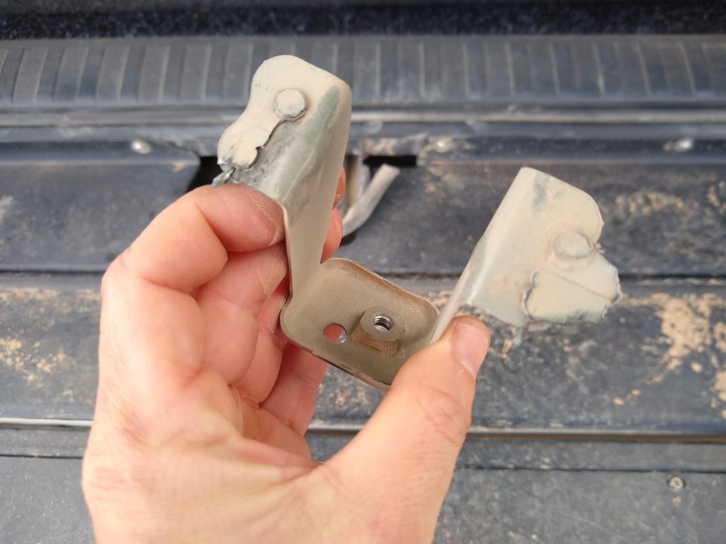

Old pics, been meaning to post this for a while now. About a year ago I spent a couple weeks trying to find a rattle somewhere in the rear of my truck. Well, I found it:
Turns out that behind the headliner its just a thin piece of sheet metal riveted to the body at an odd angle. If your panels or shelf is loaded up and you spend any amount of time on washboards you should probably keep an eye on those mounts.

I wonder if the manufacturers of these add on shelves and side panels considered this. Did they research what load the attach points could handle - the weight of their products plus the weight of what is attached or set on them? And, the conditions the vehicle would endure - rough bumpy roads, trails, etc. I would guess not!

Those mount points are designed for dry cleaning. Nothing more.

Yeah, clearly not intended for anything other than the lightest duty use. I never even had anything heavy up there, just some blankets, tarps, stuff like that. The oven isn't heavy at all (esp compared to the shelf itself)
Last pic I have before I committed this junk to the scrap pile:
