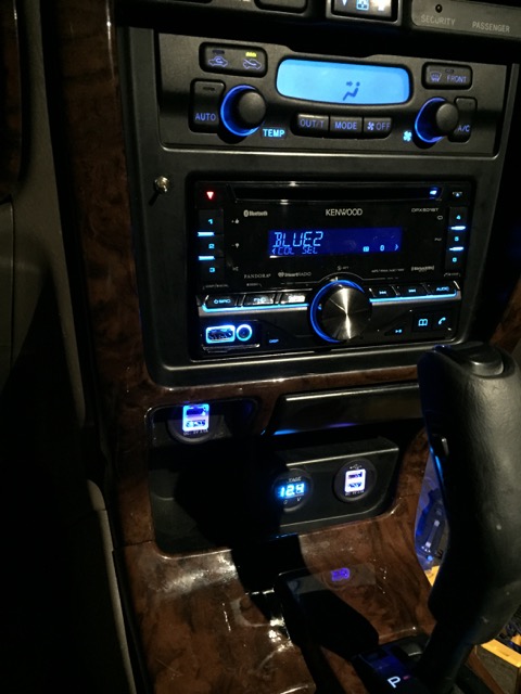

yea, just do it! I only did the HU (Kenwood DPX501BT) for now, but super easy and looking forward to the speakers, small sub/amp (under the seat) and sound proofing!

I'm planning on buying the same Headunit as you but 1 thing concerns me, the top most helpful review states that:
"You can not use this to listen to navigation on the Iphone using apps including but not limited to; Apple Maps, Waze, and Google. The music will pause when instructions are stated, however no sound is heard."
Can you confirm/deny this for me? I have an Android LG G4 and use Google Maps sometimes so I'd like to know if, while connected through BT, it will or won't play the Maps instructions sound.

To be honest I've never used navigation with music going. I will give it a try when I go home today and report back.

It worked fine with Google Maps open and Pandora going on my Samsung Light. No issues, at least for me anyway.

Well that's great! I really appreciate your response. You've been really helpful.
I'll keep watching the price on the HU for now. I'm thinking of getting an upgrade from OEM in a few months. I think I'd be okay with just buying this HU, Kicker 40CS654 front speakers and amping those with the same amp you bought (Alpine KTP-445A) and leave the rear speakers alone. I should be okay :D
