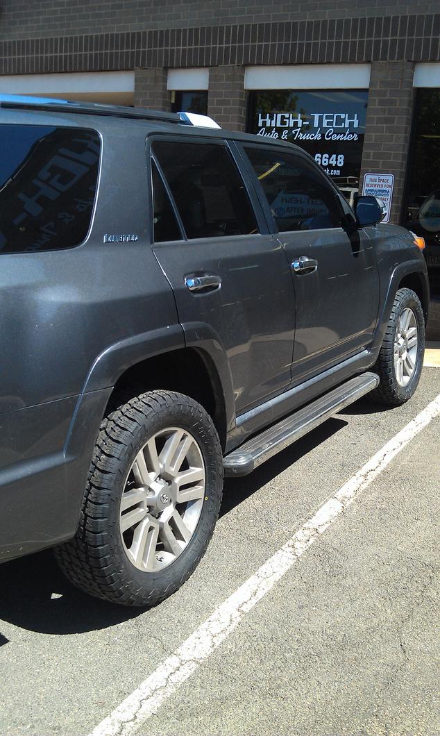

Put 275/55/20 Nitto Terra Grapplers on my Limited today
VT4runnin
Thanks to Ducmonsta's shop for throwing these on today! :cheers: Love the new look.

I love them, but it still worries me that the size is not for that rim size.
Completely agree. I think the TG tires are one of my favorites, but it just sucks that Nitto doesn't recommend the 275/55 for 7" wheels.... It really leaves Limited owners in quite a bind to decide between (1) changing wheels to run them, (2) getting different 275/55s that are recommended to fit the skinny OEMs, or (3) just running them regardless of the manufacturer recommendation.
Been there, done that. The only concern I had was the tires are recommended by manufacture to pair with >= 7.5" wide rims, whereas rims on Limited are 7". A little too narrow for the 275s. So I ended up with getting some wider rims.

Been a while since you originally posted the photos (looks great BTW!). I want to put those exact same size tires on my 2011 Limited 4runner and am wondering how your journey went with these larger sized tires on the stock 20" rims? Still not sure on the BFGs (most likely) vs. Nittos.
Thanks in advance!
is this tire & size rated for a 7" rim or for a 7.5" officially?
Manufacturer recommendation is 7.5" minimum wheel width.
I wouldn't run them on 7" personally, but you might be inclined to do so if your cousin's friend is an ASE Master Tech and gives it the thumbs up. This seems to be the case for everyone running this size.
I've also heard that staying at a Holiday Inn Express may alter the applicability of manufacturer recommendations as well.
thanks for the info. I was afraid of that. outside of 2 tires that can mount to a 7" rim I am still back to square 1 of buying new rims and tires.
