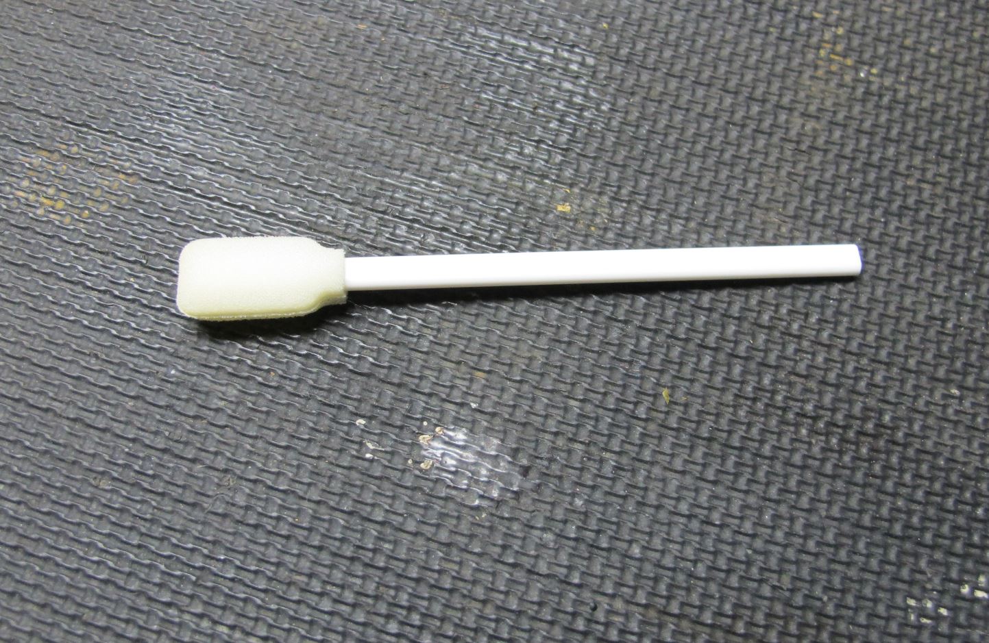

A similar q-tip, the one lost was round with a round shaft
http://www.skjos.net/toyota/images/qtip.jpg

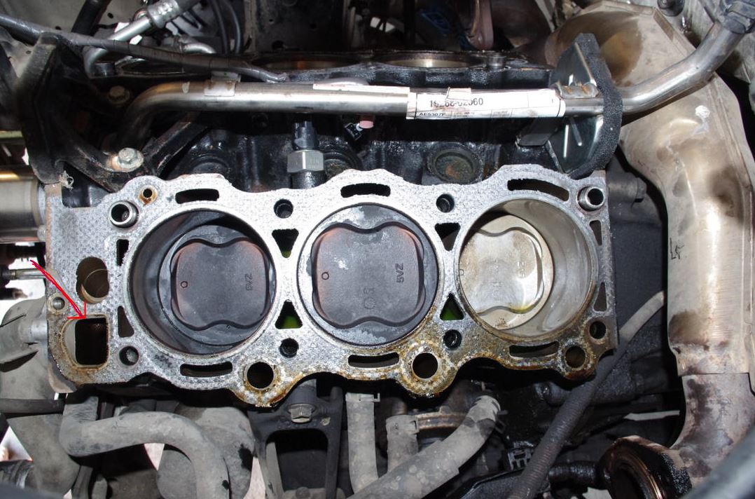

Not my engine, but the next stop for the qtip. I can see the head surface through the little hole, but the q-tip must be farther down.
http://www.skjos.net/toyota/images/Driver side head marked.jpg

1) Where would the q-tip end up?
2) What is the best way to retrieve it?

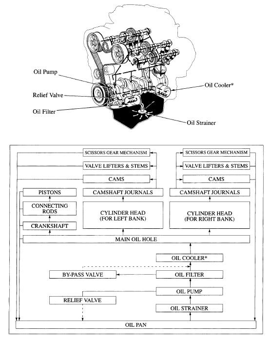

I did find this oil-flow diagram, and it looks like its on the uptake side, probably stuck low in the main oil hole. I might be able to get to it if I remove the cylinder head, the diagram shows a bend before flowing into the crankshaft area so it might be sitting there. Those that have done a head gasket replacement - do you recall a bend in the engine block's main oil hole, or would this thing drop straight into the crank shaft area?
http://www.skjos.net/toyota/images/5VZ-FE Oilflow diagram.jpg
Replys seem to indicate this in not a uptake, but a return.

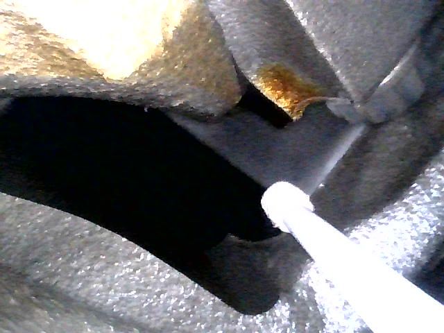

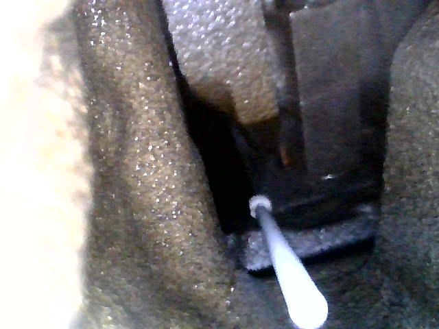

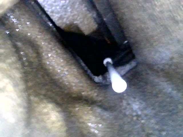

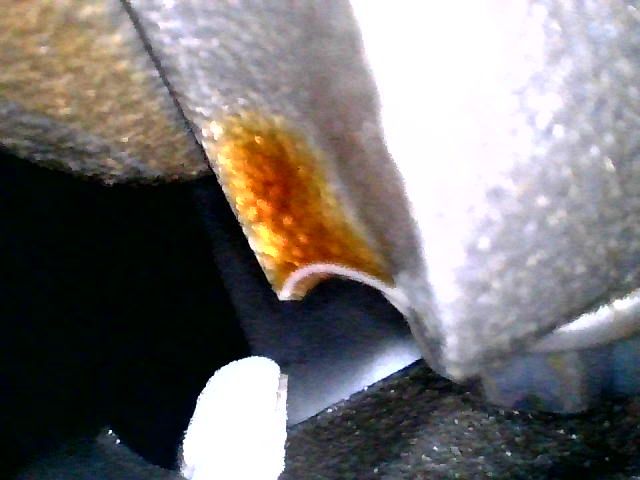

Amazon was a day late with my order, but I did get an endoscope; it's amazing what $35 dollars will get you these days.
I took the following pictures with the endoscope:
http://www.skjos.net/toyota/images/endoscope1.jpg
http://www.skjos.net/toyota/images/endoscope2.jpg
http://www.skjos.net/toyota/images/endoscope3.jpg
http://www.skjos.net/toyota/images/endoscope4.jpg
It looks like the q-tip is precariously perched on the edge of the splash shield; does that look right to you?

If you can get it into the pan, I don't think it will go anywhere and you are safe. Based on your oil flow diagram, if the oil pump does suck it up, it's going to get caught on the strainer. Otherwise it will just slosh around in the pan.
If it does break up into bits and get past the strainer...they should get caught in the filter. The oil pump won't even notice any little plastic/foam bits.

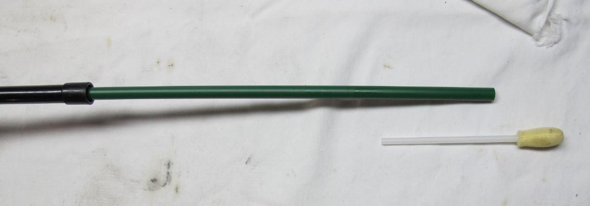

The straw test was successful.
I necked down my shop vac to fit my wife's tumbler straw which just happens to be 10.5" long, but is shortened to 9.5" when attached to the shop vac (the same distance q-tip is down in the engine). It's outer diameter is .30 which exactly fits the hole.
Using a similar q-tip, I lower the straw near the q-tip shaft, the shaft is drawn to the vacuum, and then as you slide the straw up the end of the shaft the q-tip securely sucks into the straw. This means I do not need pin-point accuracy.
Unfortunately, my wife's straw is not flexible enough to make the bends necessary to get to the q-tip down into the engine, but there are similar straws made out of silicone that are the same dimensions and are flexible.
I do have some tubing available, but it is pretty thick walled which really reduces the vacuum strength (small inner diameter).
When I receive the flexible straws I will test cutting small holes in the side to see if that more securely holds the q-tip shaft to the straw while it drawn upwards.

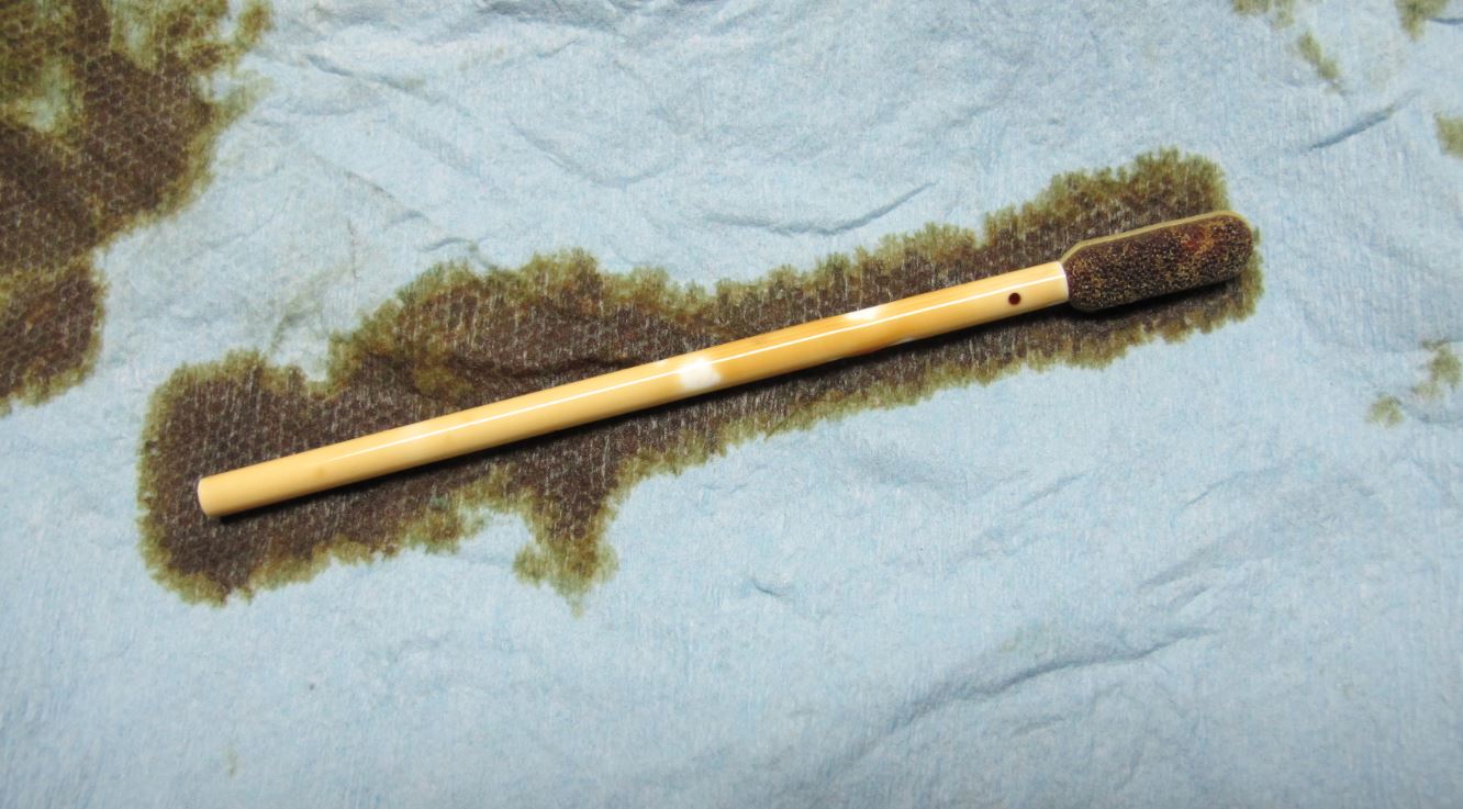

First I jacked up the rear of the rig to help keep the q-tip from falling backwards onto the splash shield. Then I pushed the endoscope to the backside of the q-tip and wiggled it around to knock it off the splash shield.
As you can see in this video, I do not have much control of the scope:
http://www.skjos.net/toyota/images/Qtip into oil pan.mp4
I'm guessing the oil is really close to the level of the splash shield due to the rear end being jacked up, so it didn't really drop, it sort of slid in.
Here is the video of the q-tip floating down as the oil is drained (4x speed):
http://www.skjos.net/toyota/images/Qtip drained fast.mp4
Once the oil drained to a trickle, I looked up through the drain hole and I could see the shaft of the q-tip. I practically banged my head against the undercarriage I was so f'ing happy. A few pokes with a pair of tweezers to inch-worm the end of the q-tip to the drain hole and then I was able to pull it out.
All is now right with the world again, and I can finally finish my valve cover gasket job.
