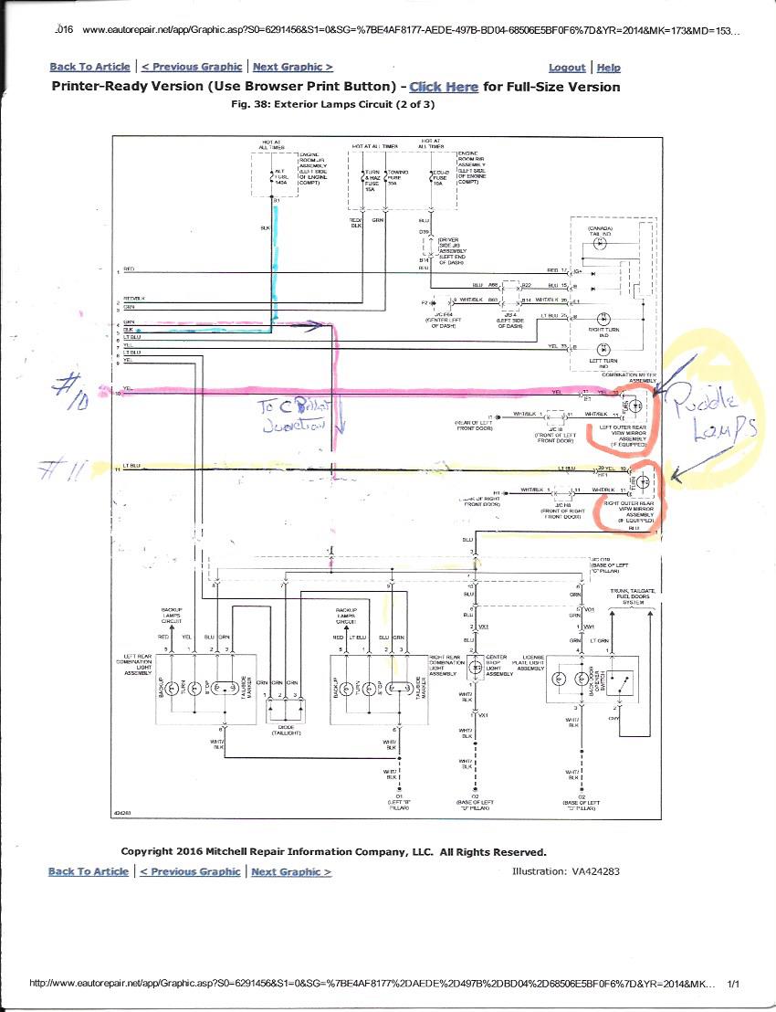

Hi Darrylj,
If the ["Puddle-lamps"] are on the truck they should be operational as ["Hazards & Directionals"]! Here's a wiring diagram for the 5'th Gen 4Runner; they don't vary much electronically. If you're unsure, just remove a mirror, and see if the wiring harness is connected!
I highlighted your wiring in Pink & Yellow for easy tracing; wires #10 & #11 (two pgs); ["I'll post pg 2 in a quoted page"]

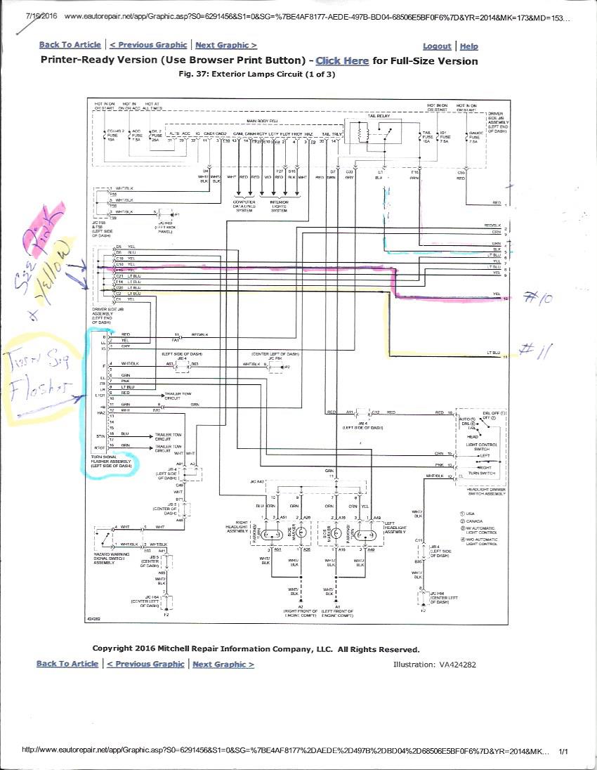

Hi Darrylj,
Here's pg #2 of the wiring diagram:
~rig~ Best to you!
