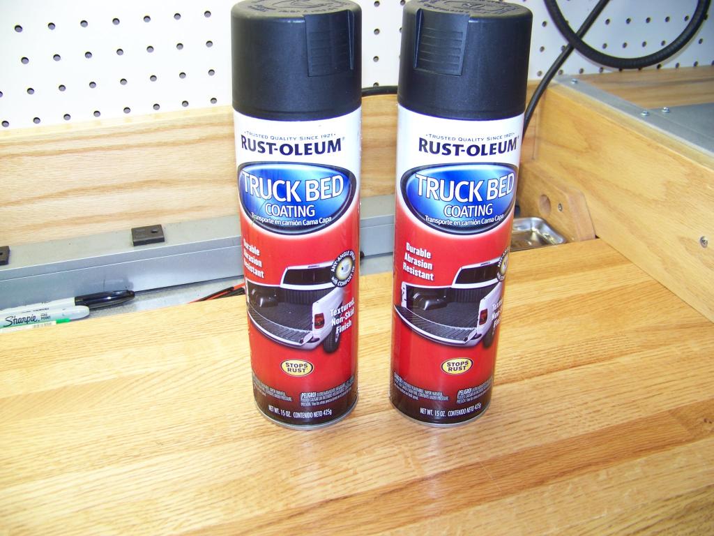

Love this stuff! It's tough, cheap and easy to use. I have it on my skidplates.
I bought it at Home Depot.
^^^ That exactly what i used on my sliders. I sand them, then wiped them out with Acetone, then sprayed them with Rusteoleum self itching primer and then used the bedliner spray. here is the shots:
